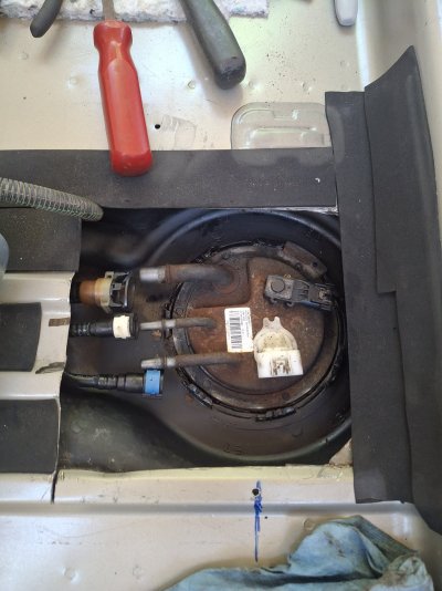

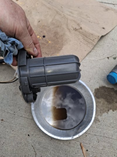

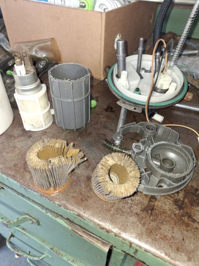

The filter is built into the sending unit and is quite robust. But, if you get a tank of dirty fuel like I did in MT, then you get the joy of replacing the sending unit. I made the trip home, but replaced it once back......it was gross, but really did it's job. The inlet side of the filter came out brown, while the feed side was still clean.

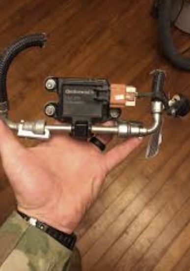

I think you missed the point. that being.....
IF you had such a desire to add a external filter, you could using similar fittings in place of a e85 sensor, without having to cut the fuel line or anything. you would just need to be creative.... meaning a fuel line quick connect adapted to a fuel filter mount and adapted back to a fuel line quick connect
sort of like this, but instead of a e85 sensor there would be a fuel filter housing
