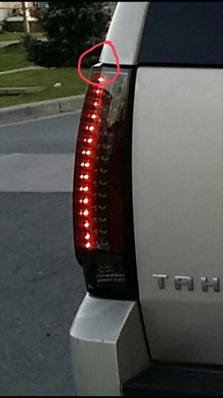

They look good to me! Maybe in person it's different? Or why do you guys say it doesn't look good? Just because of the shape of the G5 tail light I'm guessing.
jokeracing
Jan 6, 2014
122
This is the part that does not match up to the appliqué.
Sent from my SM-N900W8 using Tapatalk
KMeloney
May 2, 2009
3,458
708
Hey, do what you want. Whatever makes you happy. For me, it's having the pieces that were meant to go together, together.
IMO, in person, it looks bad not having matching appliqués.

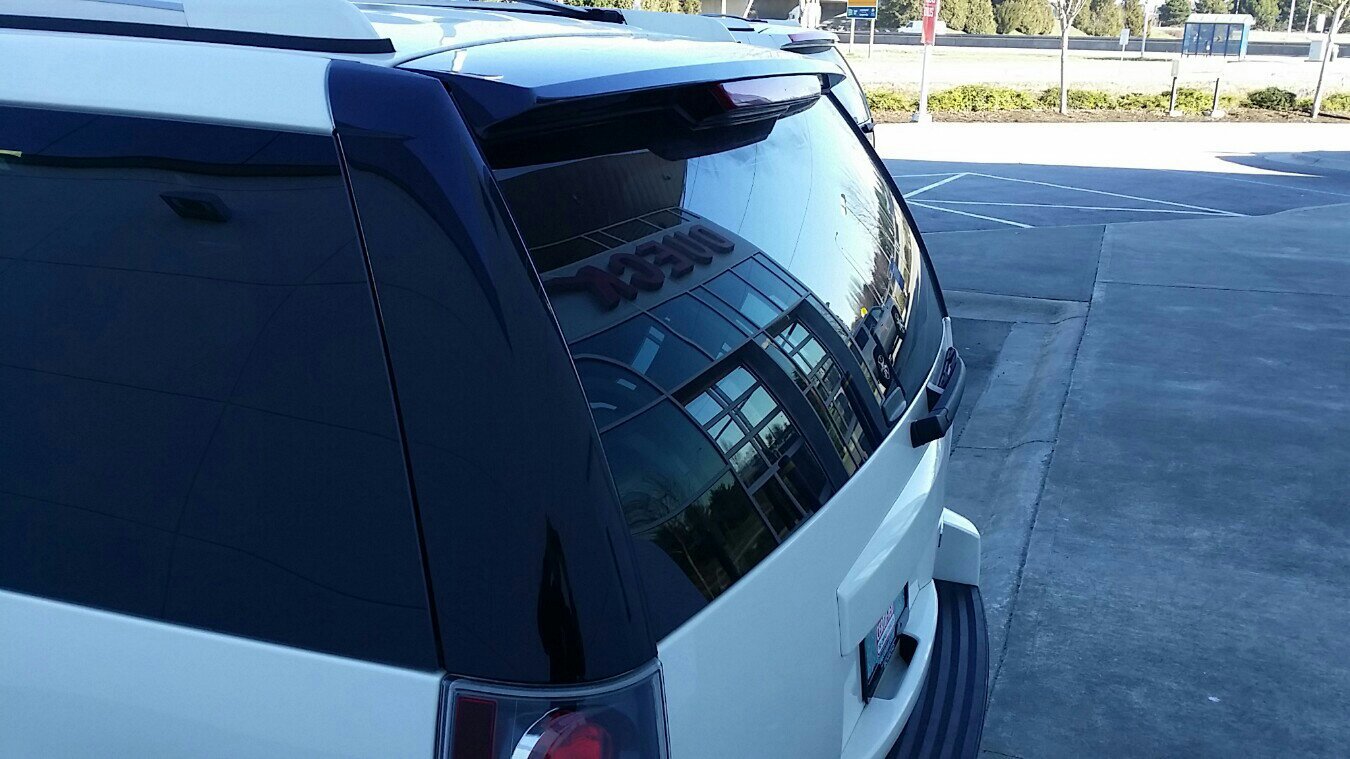

Little off topic but do Denalis come with black applique and spoiler not matching body color. Just walked around dealer during service and saw this. Exactly what I want to do is paint my appliques and spoiler black.
