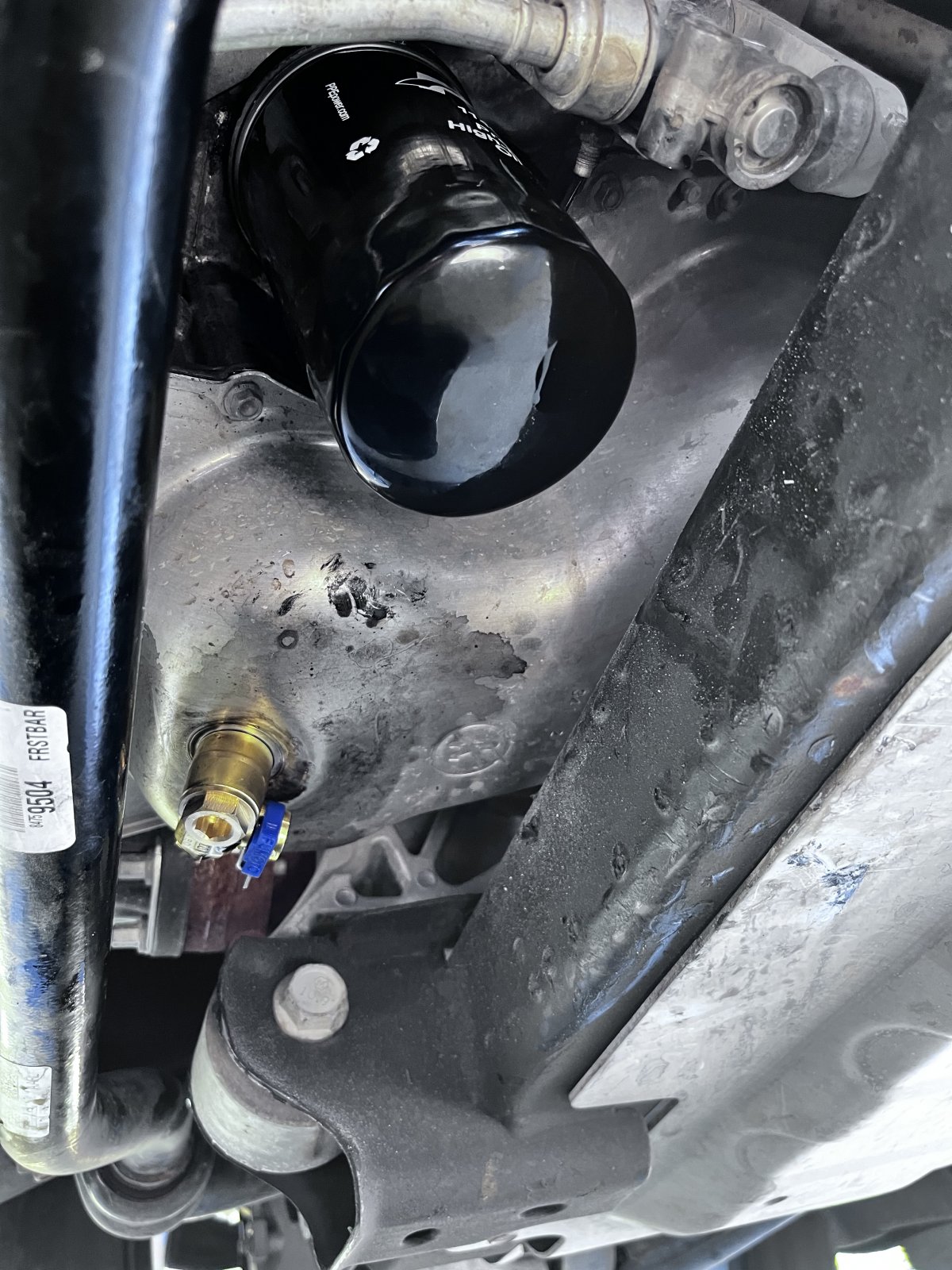

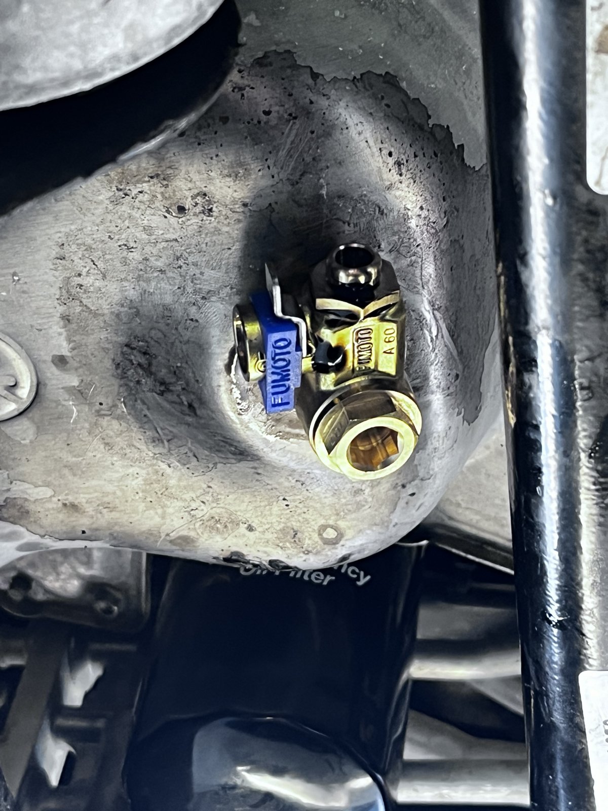

Used the Sierra 3.0 L duramax Fumoto valve. F107SX. Went in like a champ, torqued to 15 ft lbs, then gave it a smidge more.
Photos attached.
