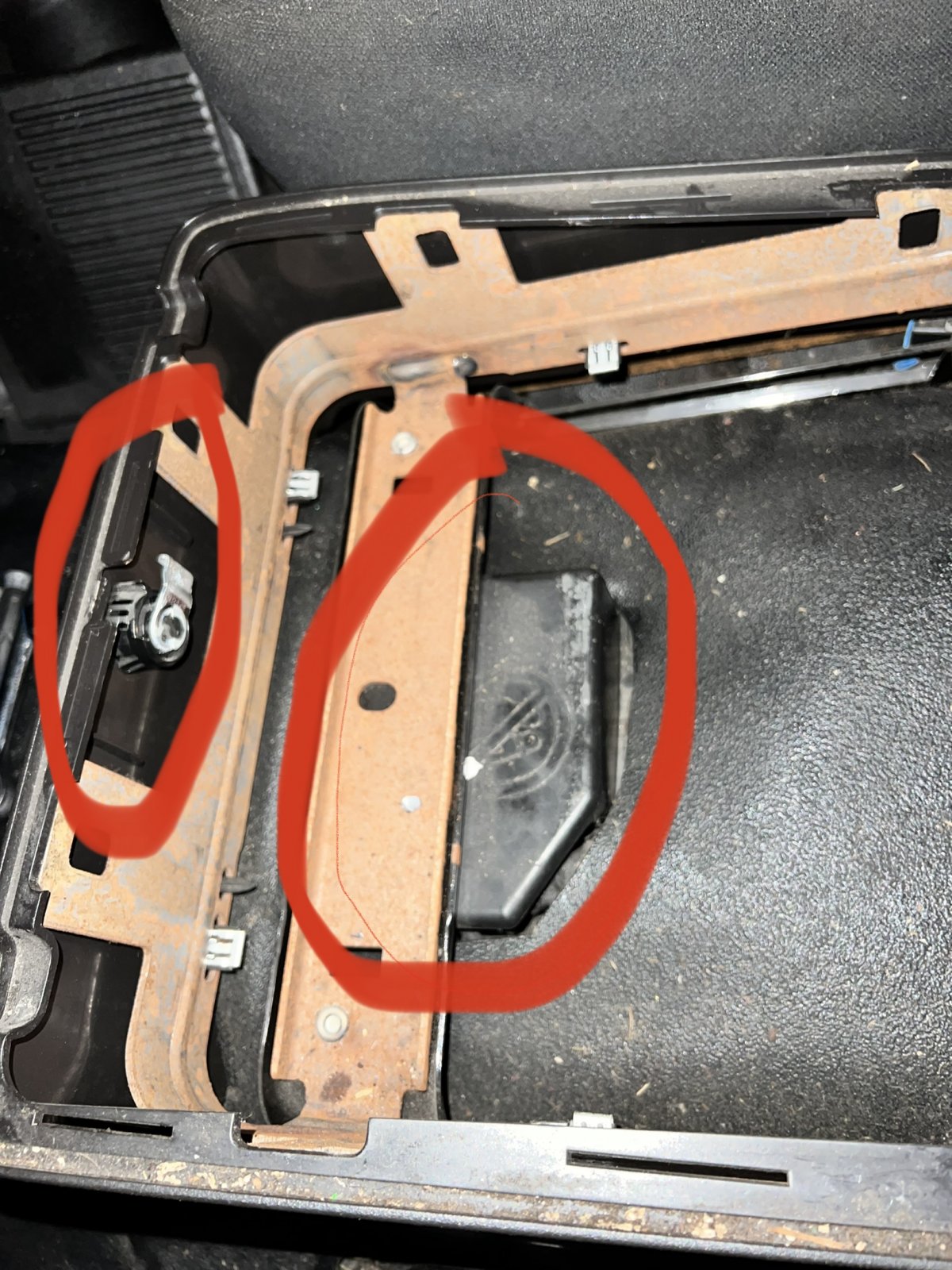

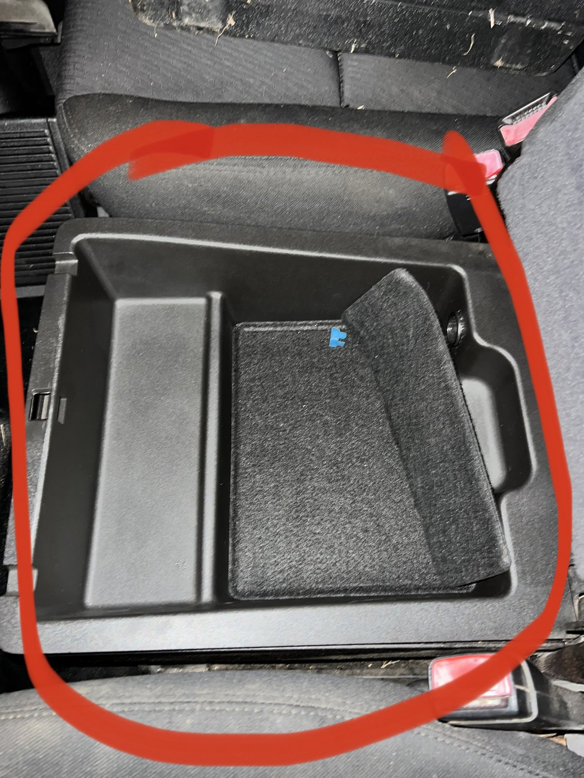

Also any one have any idea what I can do with this console tray as in where I can buy the right one ect? It won’t sit in flush bc of some plastic cover thing underneath so I’m assuming they never installed the right tray. And don’t have key to the lock so any suggestions on replacing the lock as well?
I'm not familiar enough with this to offer anything.

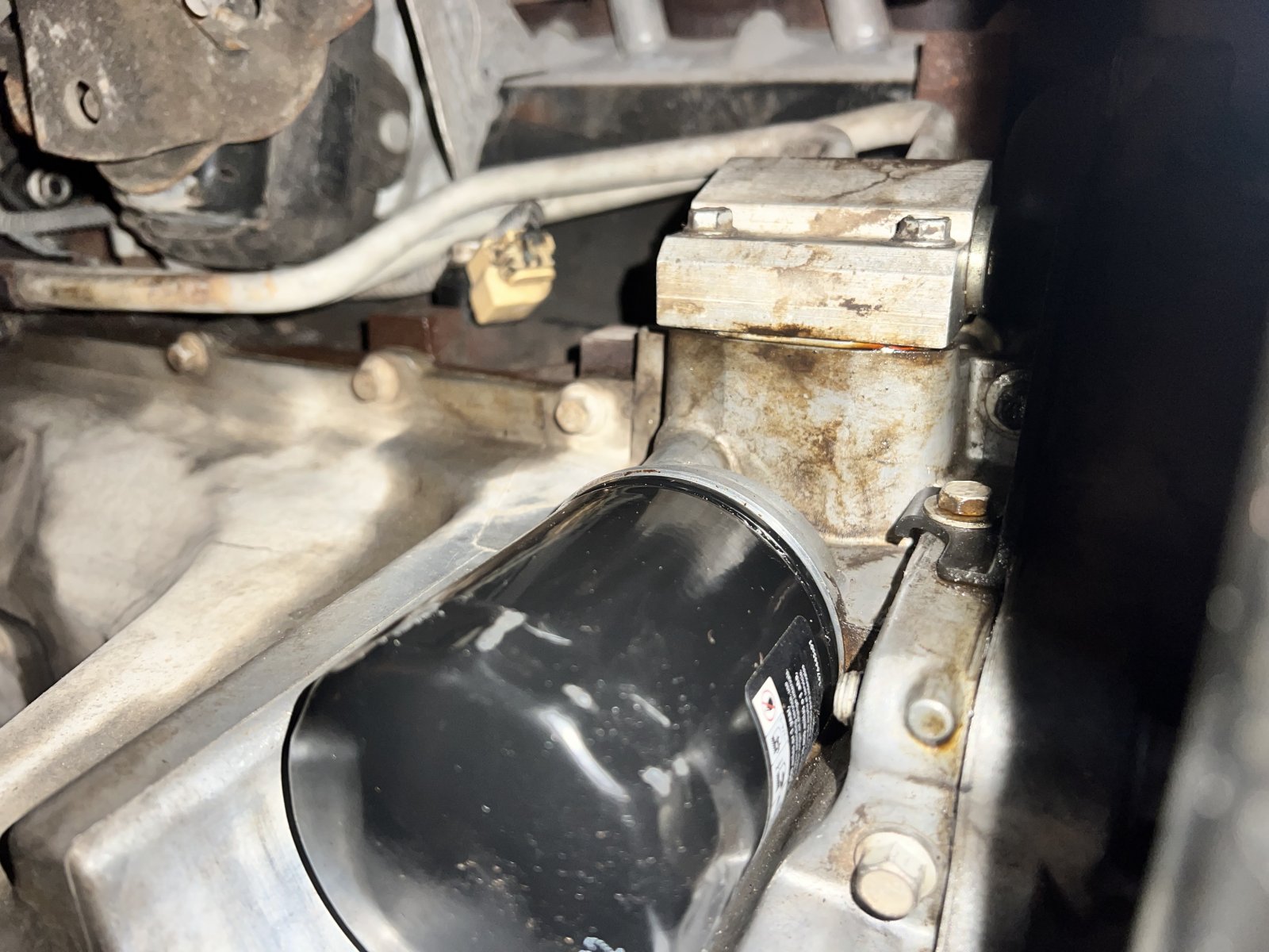

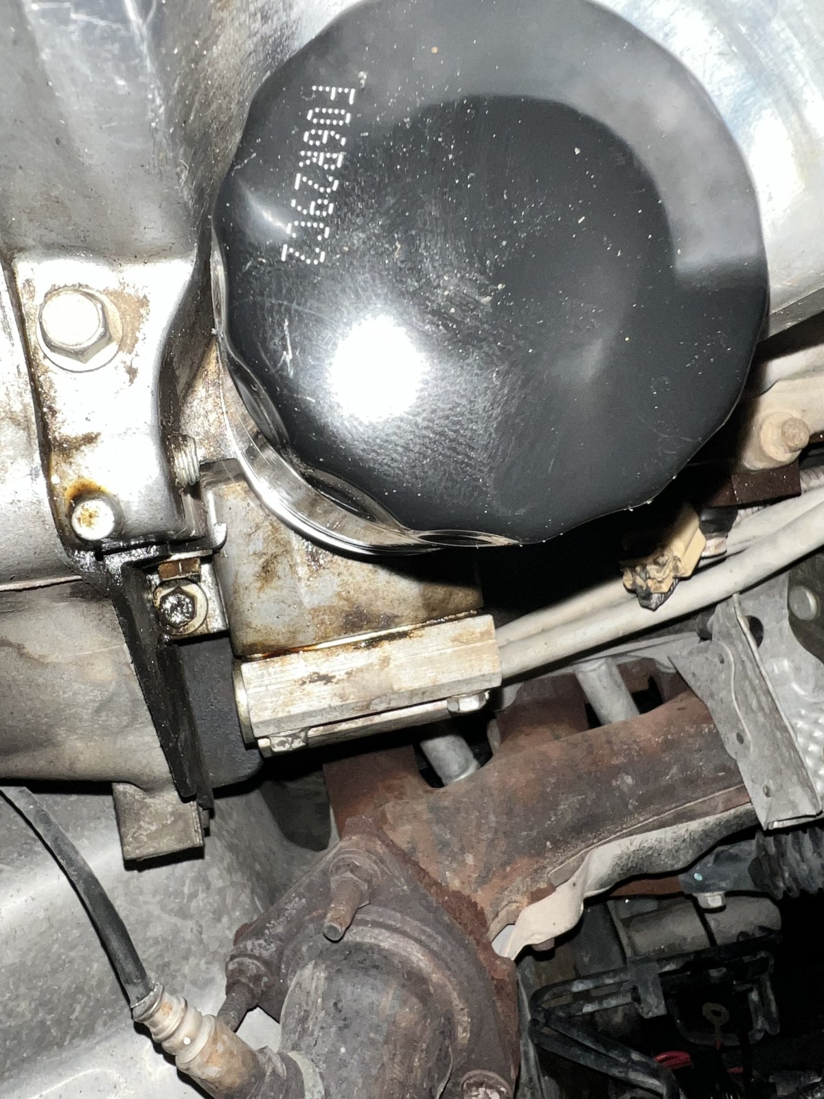

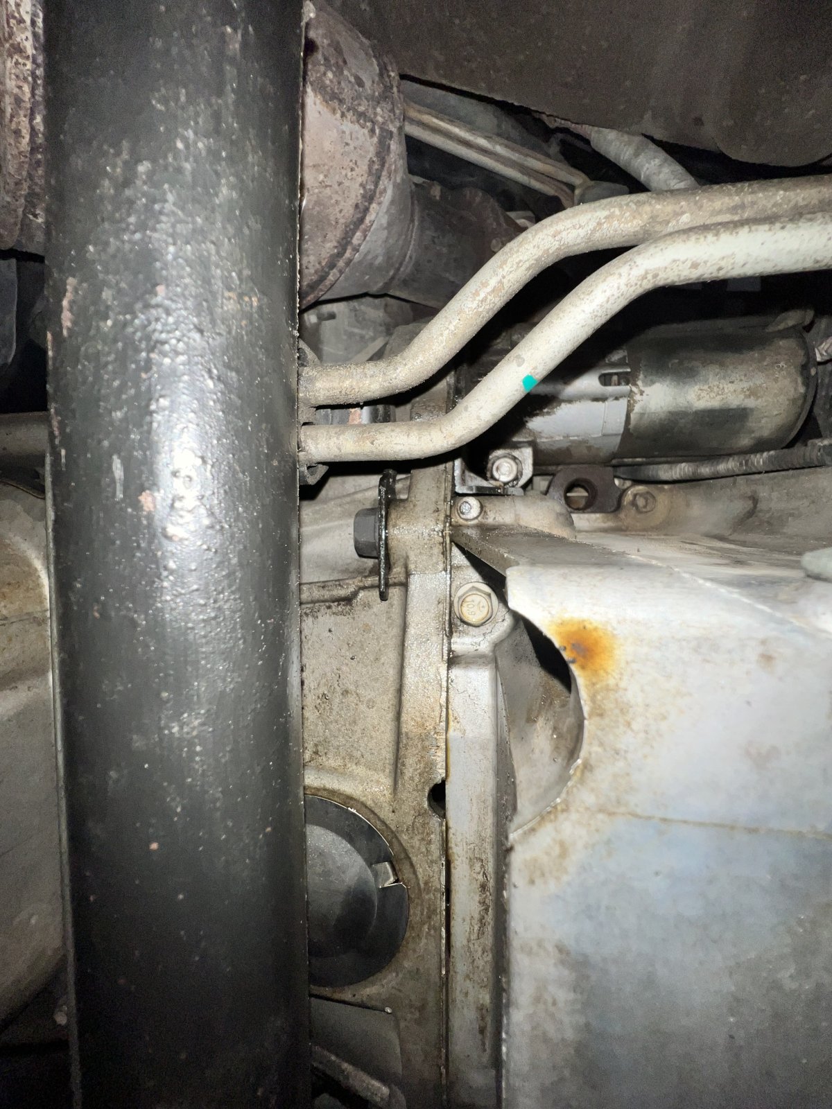

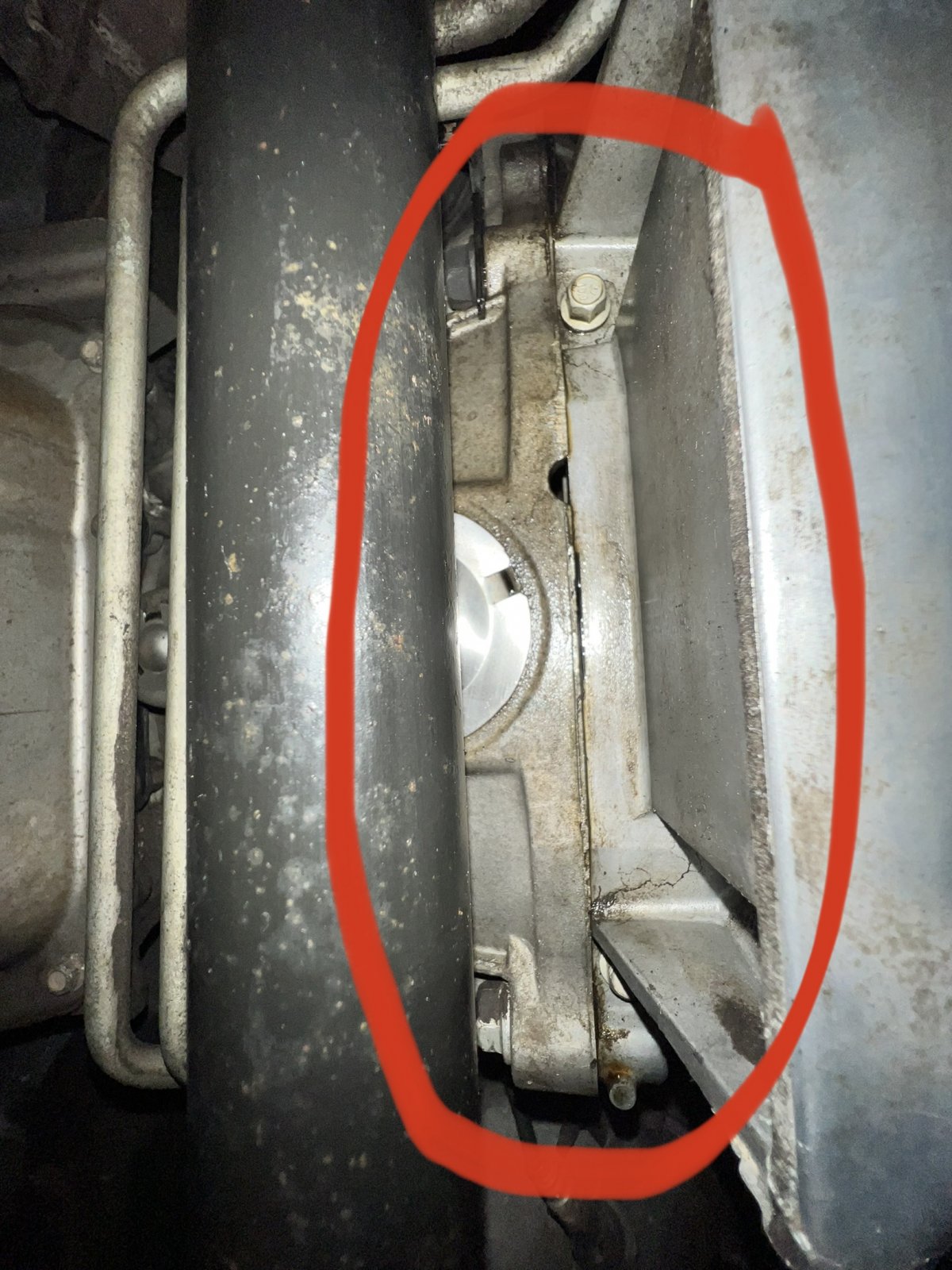

Updates: All fluids changed, have not ran it for 10 min and I look to see oil residue once again where I wiped it clean.
Seems it’s coming from the oil cooler gasket. I saw other threads talking about replacing it and changing the block of plate or something. Dont know if that’s the only place oil is leaking from, process of eliminating. It’s seems to run underneath the oil pan in the crack where it connects to the transmission. Pics below.

45,013
Super common leak point. You don't have a block-off, you have the cooler installed. Models without the oil cooler will have a block-off. Each use their own gasket and are not interchangeable. Be sure you order the correct one. At least it's an easy repair! Replace it, hit the whole area again with a cleaner and let it drip dry. Check again after some driving. Be aware that some oil could be "baking out" of the pores in the block and pan and isn't an actual leak. It could weep or wick down and collect on lateral surfaces, appearing as a slight leak. It may take a few heating and cleaning cycles to get all the oil cleaned off, assuming there are no actual leaks.

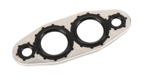

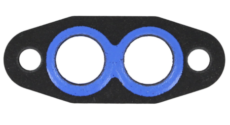

And to add to Chris's post, which is great advice, is to use the OEM style gasket:
...instead of aftermarket designs:
The latter requires too much clamping force to seal. Gotta to be real careful with those bolts because they're small diameter, screwed into aluminum. Stripping one out will ruin your day. Ask me how I know. :(

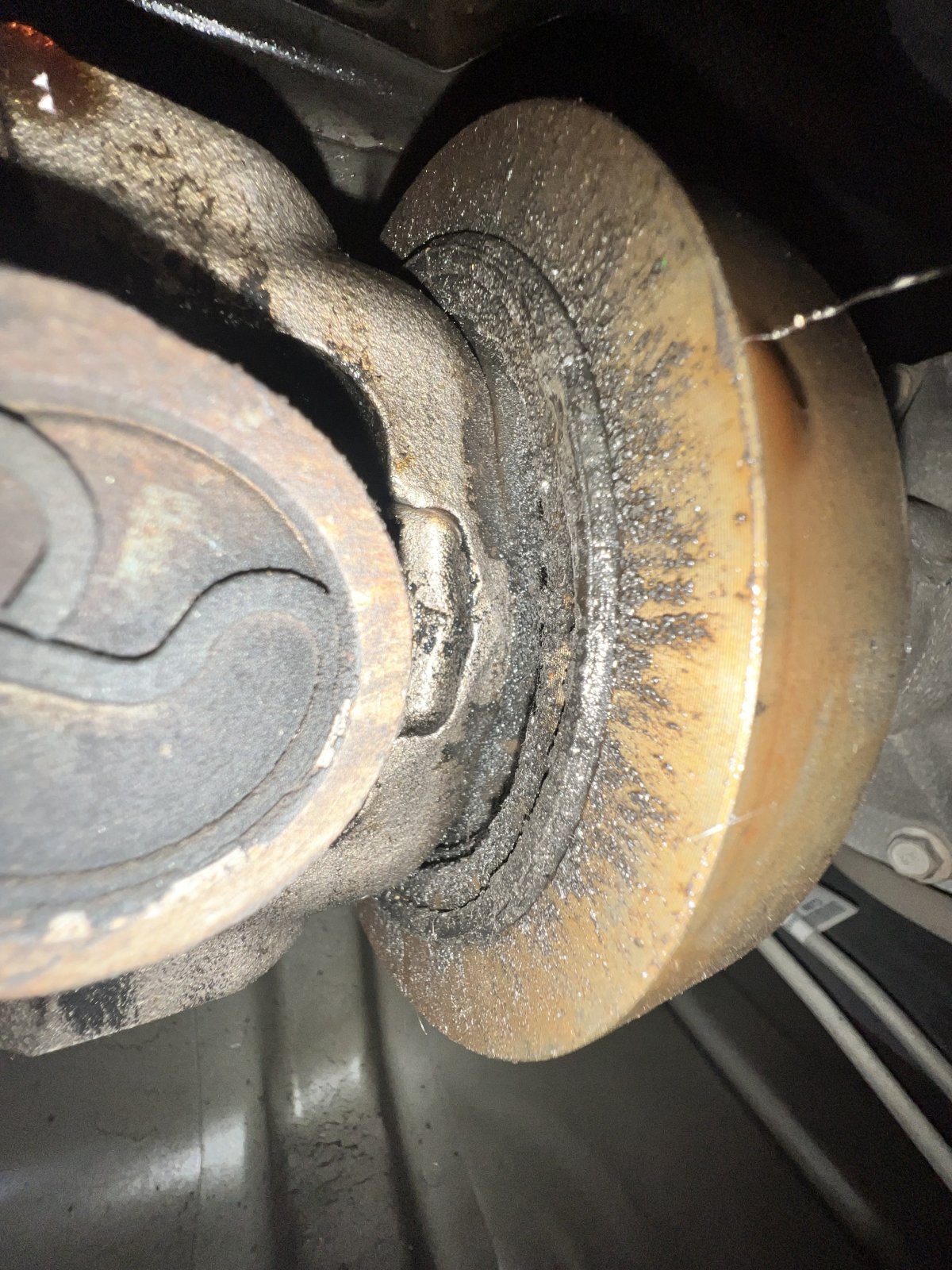

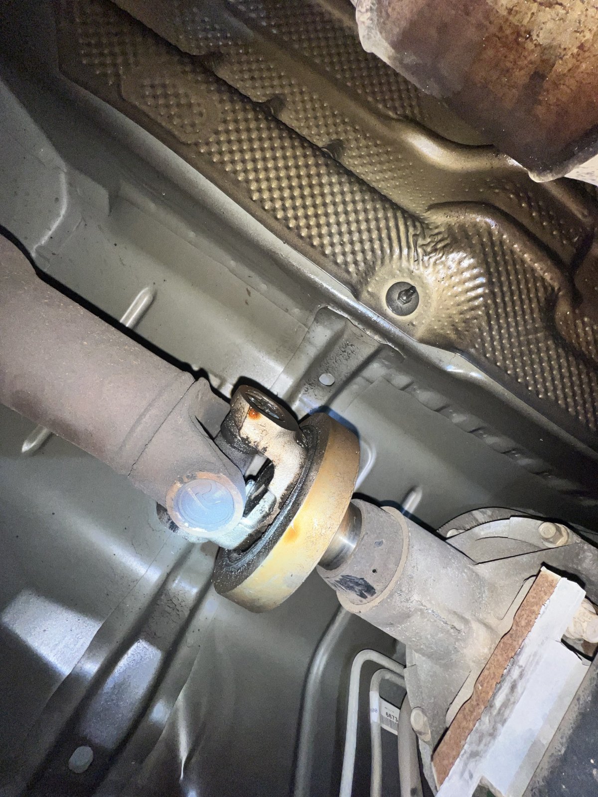

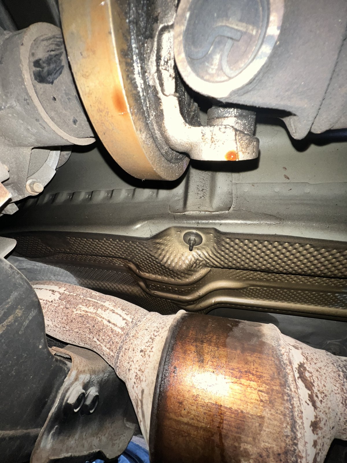

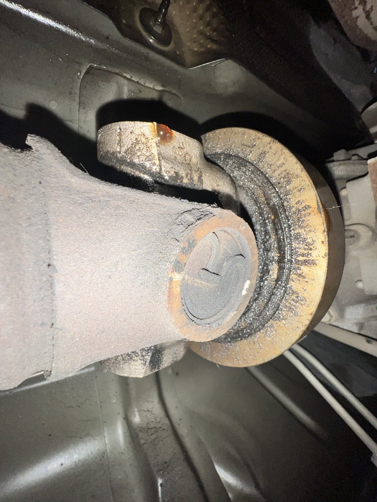

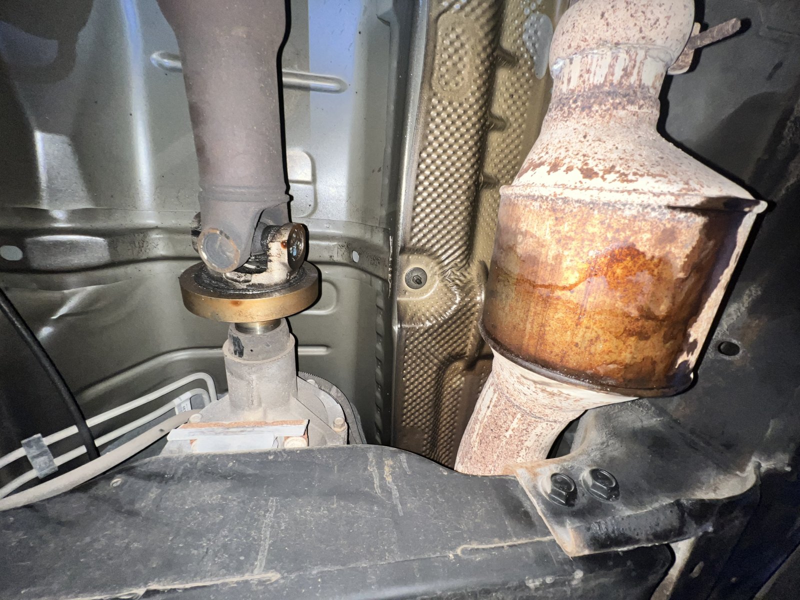

Update: flushed tranny fluid new filter and gasket install. Noticed drive shaft links were covered in oil residue as well and is leaking somewhere somehow. Any pointers on whats causing this and how severe it is. The rubber boot seems dry and fine the u links are caked however.

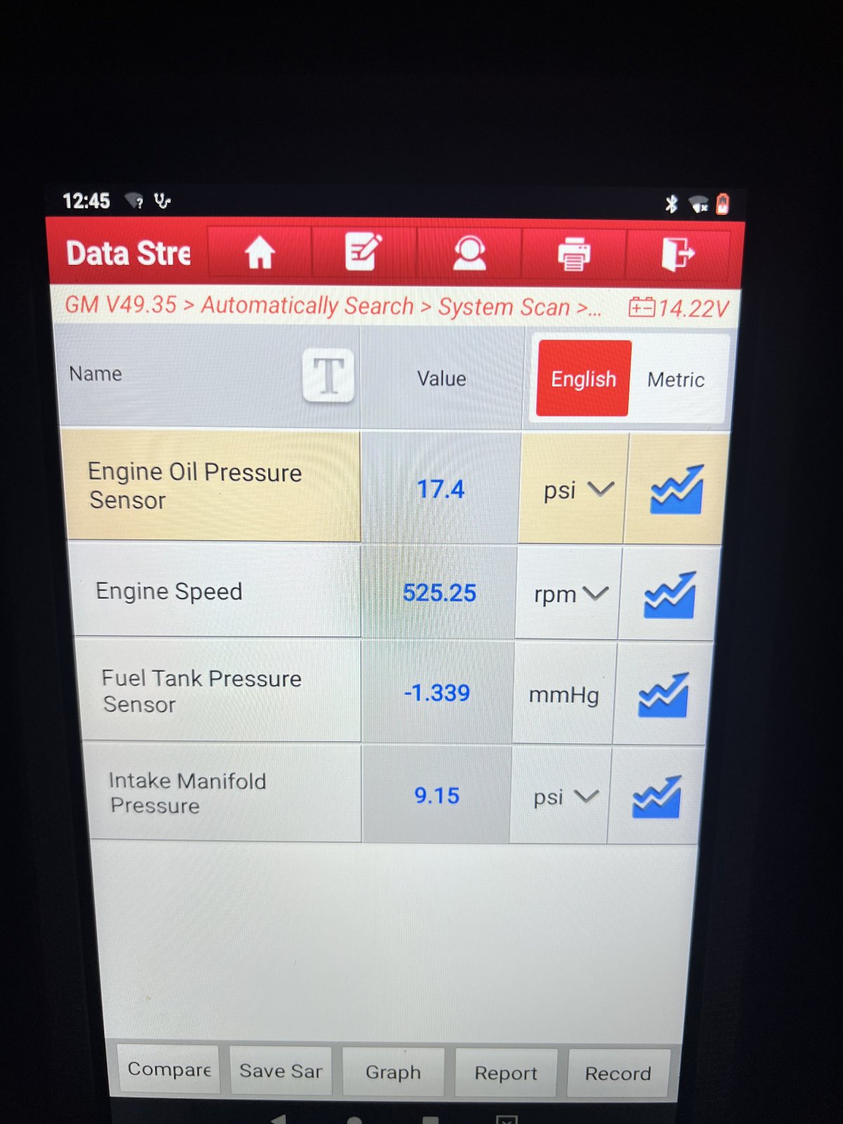

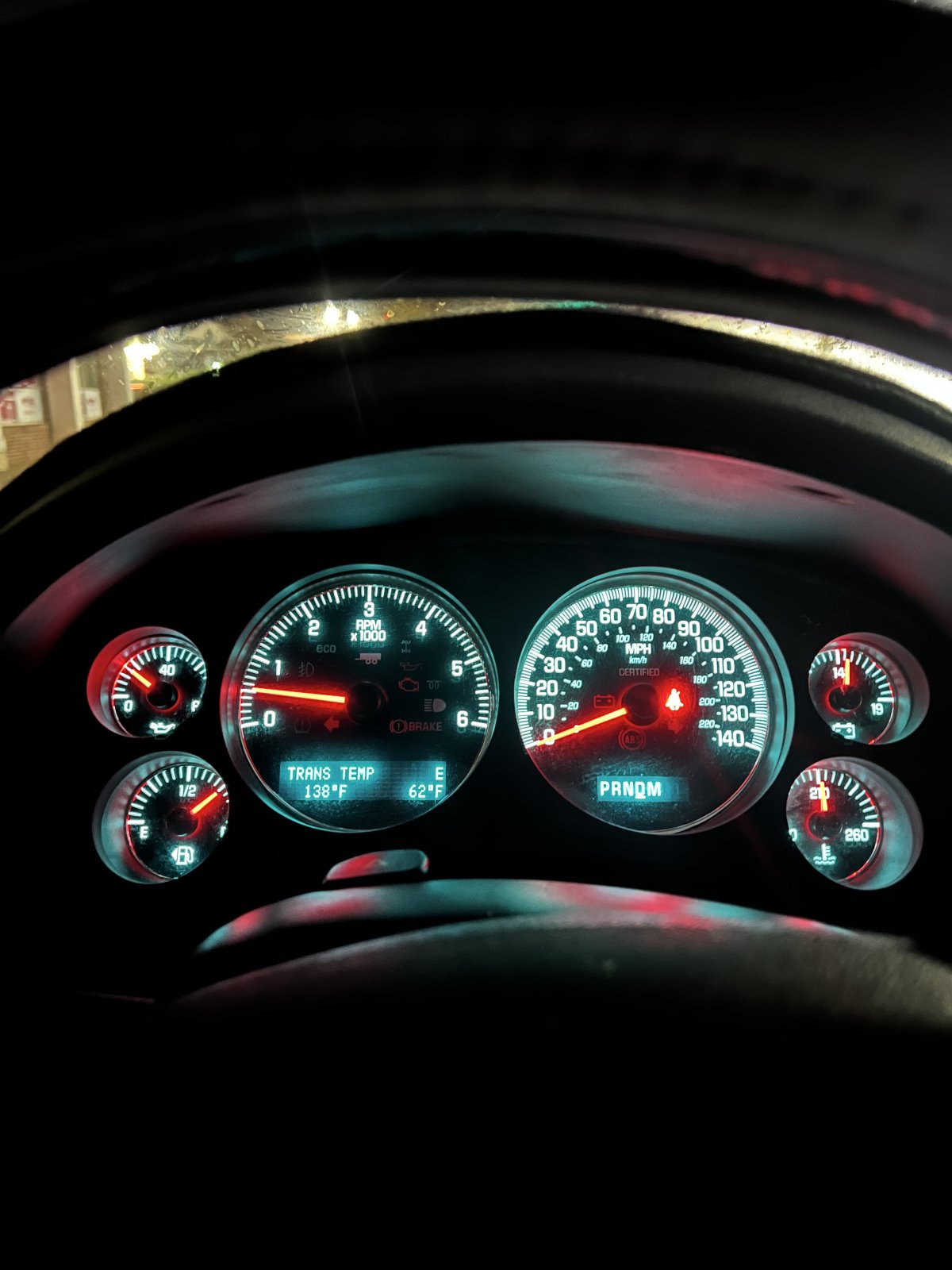

cold start oil is at 40 psi so that’s good there, then as it gets warmed up it drops and hangs around 18-19 in drive idling. in park the engine rpms are higher for some reason so oil psi is around 20. Engine rpms drop as well when the vehicle warms up.
Rough engine idling around 515 and dips sometimes to 480ish taking the oil pressure with getting as low as 16ish. It gets to 45 psi just fine with acceleration . But the idling is the main problem when it dips below 500 you can tell the difference in the vibration and the sound of the engine.

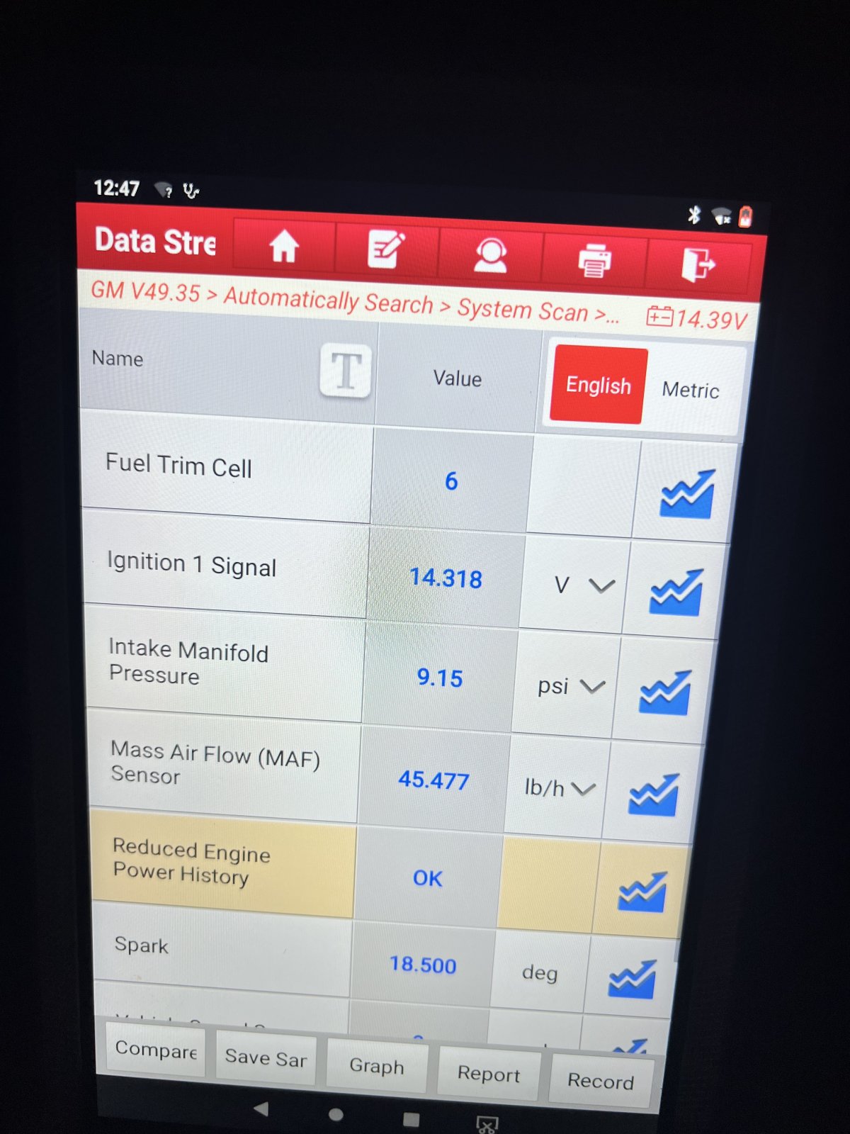

More info it’s a PPV so the trans temp never gets above 180 if that means anything but using my scan gauge I took pictures of pressures that might help. Seems something’s is off, any input maybe idle value change.
