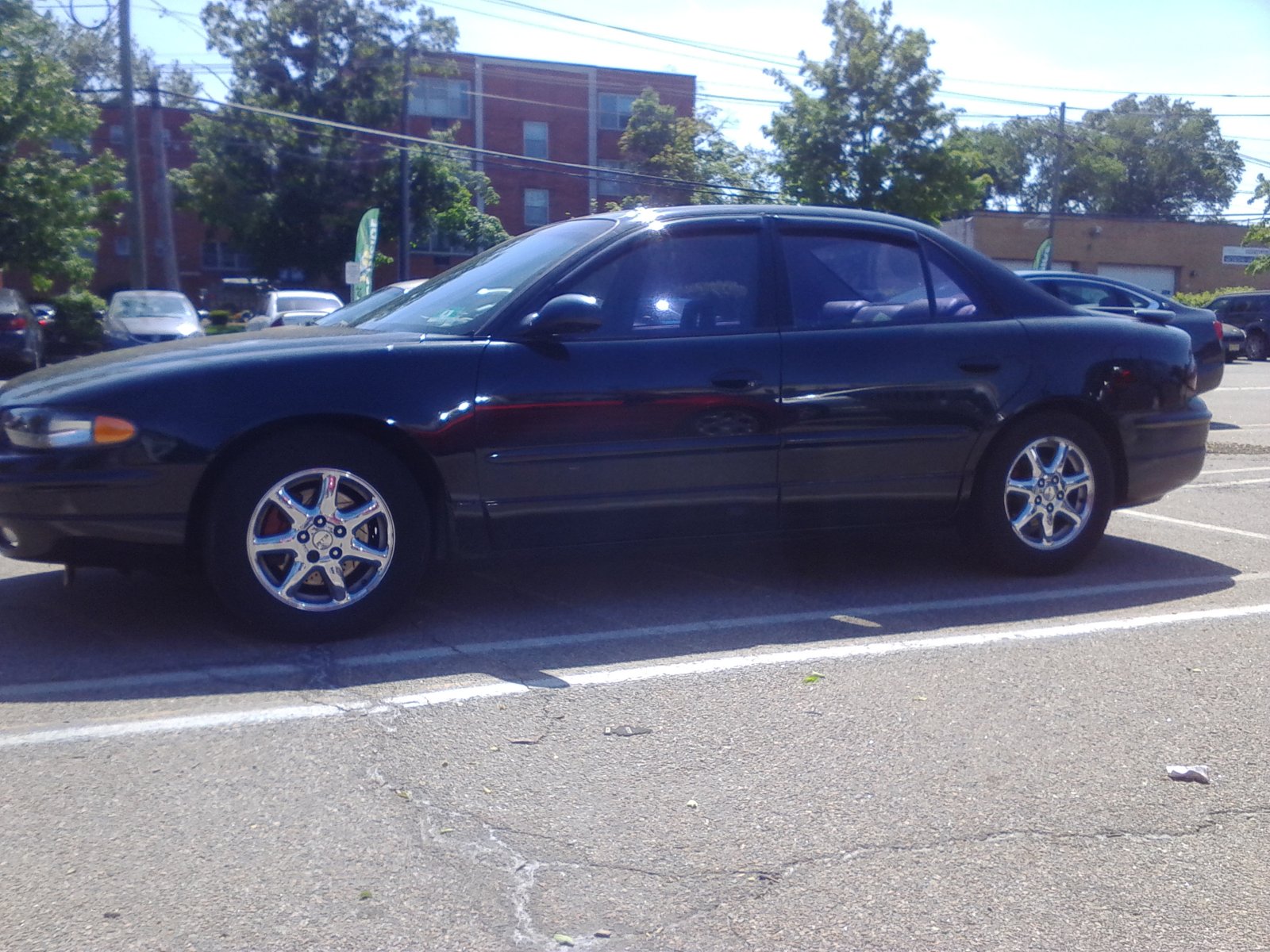

i have a 98 regal GS, came with a l67, the low comp supercharged engine. i blew that up, uncle chip showed up and well trash.
so its now got a 110,000 mile l36 hi comp block ported l67 heads, ported lim, full size ic, 1.95 yella terra roller rockers headers with a 2.8 pulley and a aem meth kit. making about 12-13 psi.
not to long ago i blew up its tranny again, so a i got a full rebuilt tranny with every upgrade there is but hard parts, like a chain and input shaft, cause that stuff was another 800 bucks.
im toying with finding a used na engine and tranny dropping it in the regal and selling it, then drop my combo in a fiero. im a lank at 6'6, so that turns into nothing but a track toy. be hard thing to do being the regals got a solid shell still. not that its worth all that much, my mods cost more then the cars worth, not to mention all the new parts its got on it.

Ultimate sleeper!
I always admired those cars, used to play with the turbocharged Buicks, but we needed minivans for our growing family and the cars were too small. GM made a huge mistake IMO going with the 60 degree V6 when the 3800s in any form ran rings around them in reliability, performance and fuel economy. Our family did put near 200k on an Olds Ciera with the 3300 and that car started and ran everyday for the twelve years it was in our family and all we did was oil changes and air filters.

if you look up gm's top 10 engines ever made, the 3800 made that list. they take a pretty damn good beating.
now that 3100 and 3400, i cant stand those, lim gaskets and your taking most of the top end apart to get to em. kinda dumb set up, lim and head gaskets fail all the time on them too.
i bought that car with 212,000 on it, now the bodys got 242,000. theres not much thats not been fixed, replaced, or just touched for one reason or another over the last 8 years.
pretty funny how after driving the tahoe for a few weeks, then hop in the regal, its a damn sports car now, the hoes a boat for sure lol
the other sad part is the regal makes as much HP as the v8 in the tahoe. and its missing two pistons lmao. stout little v6 it is, takes mods well too if tuned for em.
