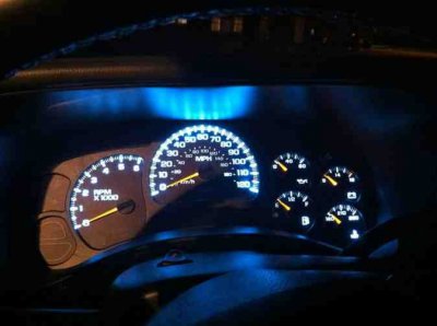

Motor may be out. Mine was than it stopped working all together. Just it it fixed (all needles) along with some LED install for under $150 life Time warranty
