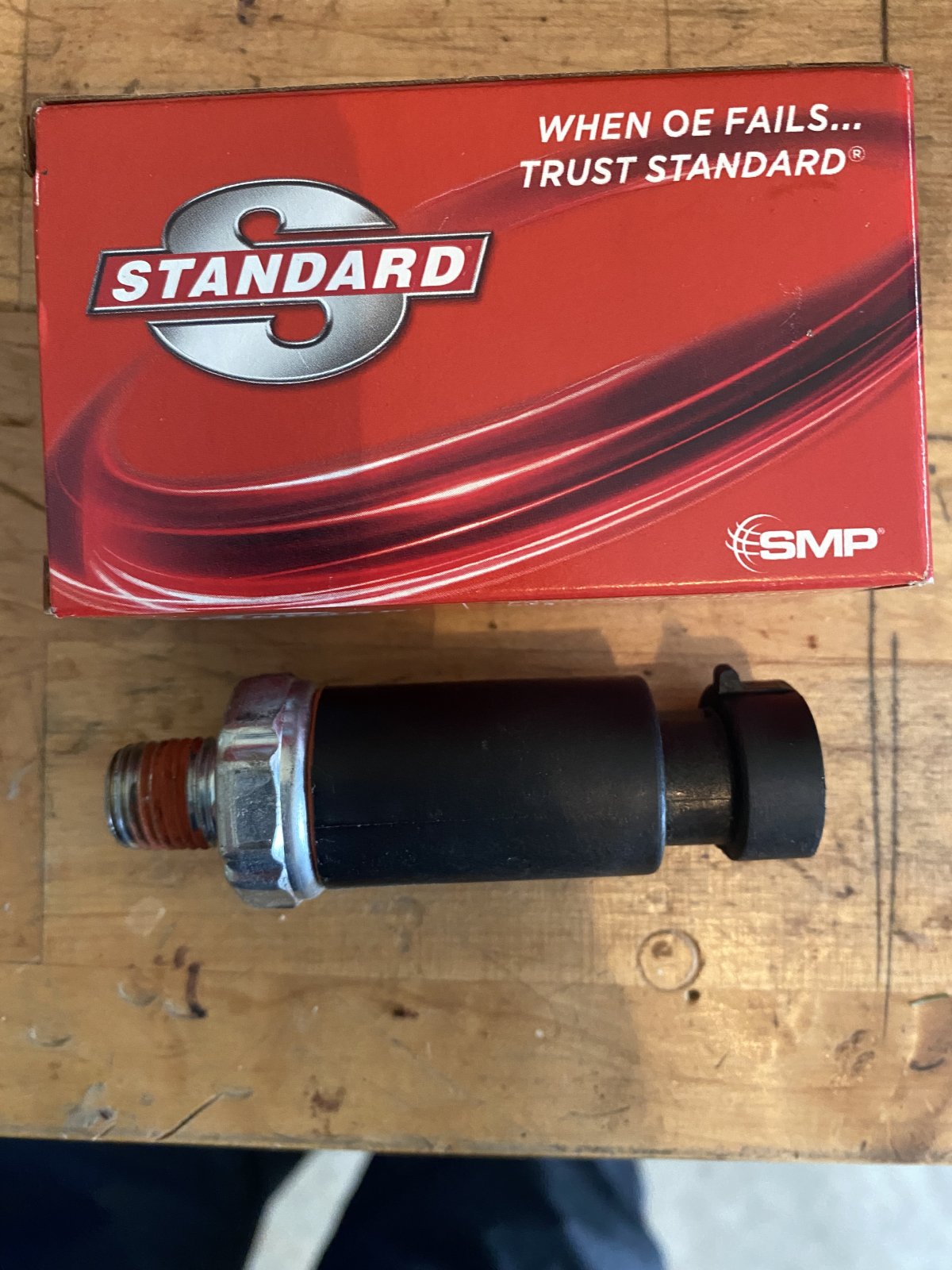

It turned out to be the oil pressure switch in behind the distributor. I replaced this switch first back in March. I replaced it, and when the engine was warm, the pressure read so low that the “Check Engine” (low oil pressure) light would illuminate. Rock Auto sent me a warranty switch. Looks like it shorted inside, and ran my Fuel Pump direct battery, with the ignition off. Luckily I didn’t throw out the old low pressure switch. Hopefully it lasts until I can pick up an OEM switch from the GM dealer Tuesday.
Big thanks again to @east302 for recommending the oil pressure switch socket way back in March. Without that socket, I would of had to pull my distributor about 6 times because of these cheap switches.

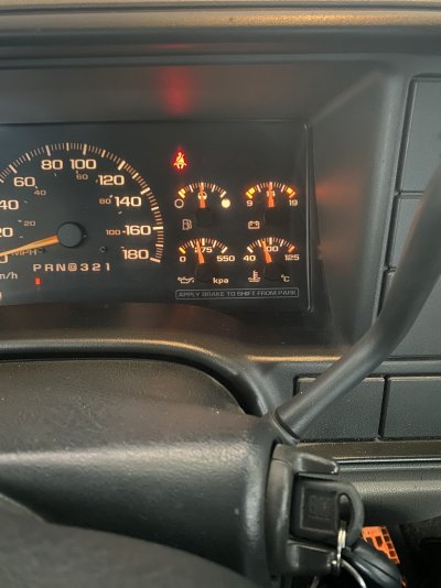

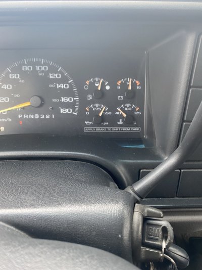

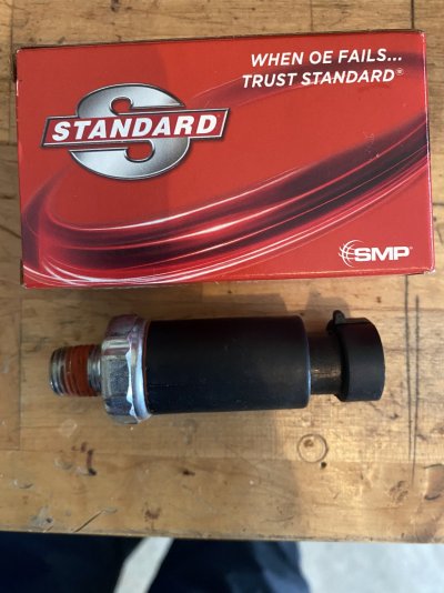

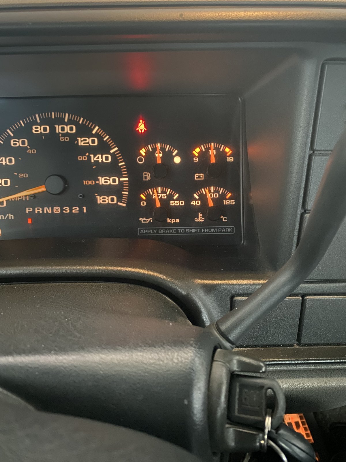

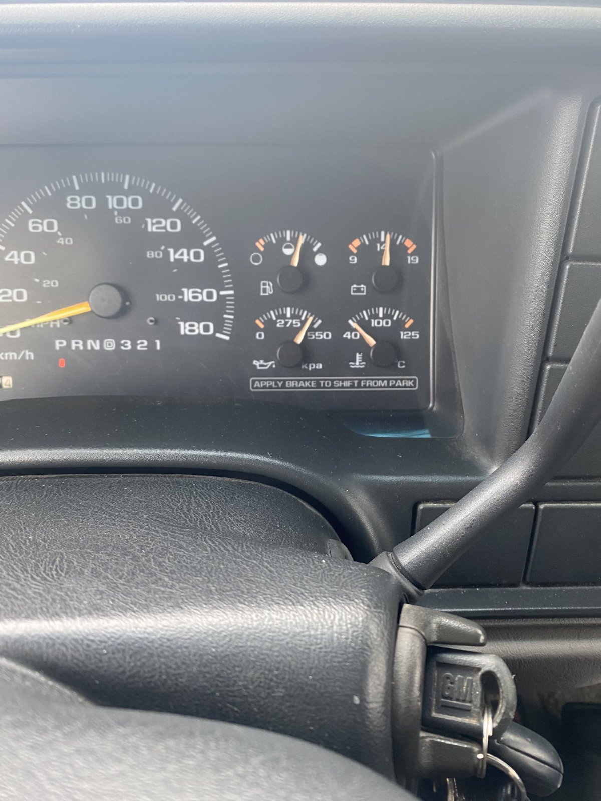

Oil pressure switch replaced with OEM part. Picture of oil pressure Cold at idle, and Warm at idle.

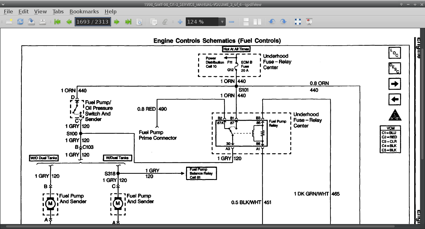

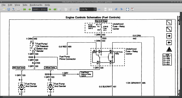

Apparently there is a circuit in the oil pressure switch, that will cut power to the fuel pump, in the event of total loss of engine oil pressure. I am thinking this may be a safety precaution in case of a rollover crash? It would seem that this circuit shorted in my cheap aftermarket oil pressure switch, allowing my fuel pump to run direct from battery even when the key was off.
Does anyone have a wiring diagram they could chime in with?

I pinned out the two contacts parallel to each other on the bad pressure switch, and the circuit was closed. On the new switch those contacts had no continuity.
