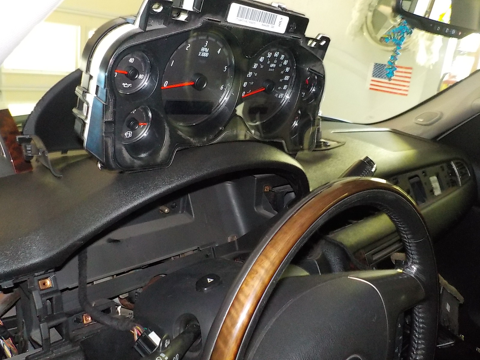

Replacing the fuel sender/pump module in the tank didn't fix my fuel gauge with a mind of its own. So today I removed the instrument cluster from the dash and will take it to a local shop tomorrow to see if they can fix it (maybe a bad driver). Maybe even get it customized :)

Local shop loaned me a good used cluster. No change. Fuel gauge in loaner cluster acts wonky too.
Local shop thinks there a bad ground or chafted wire somewhere since I've already changed the fuel pump/sender module.
I ohmed my old sender thru its range of motion and it looked good/linear, no spikes or dead spots.
I'll keep looking for a bad wire/ground under the vehicle.

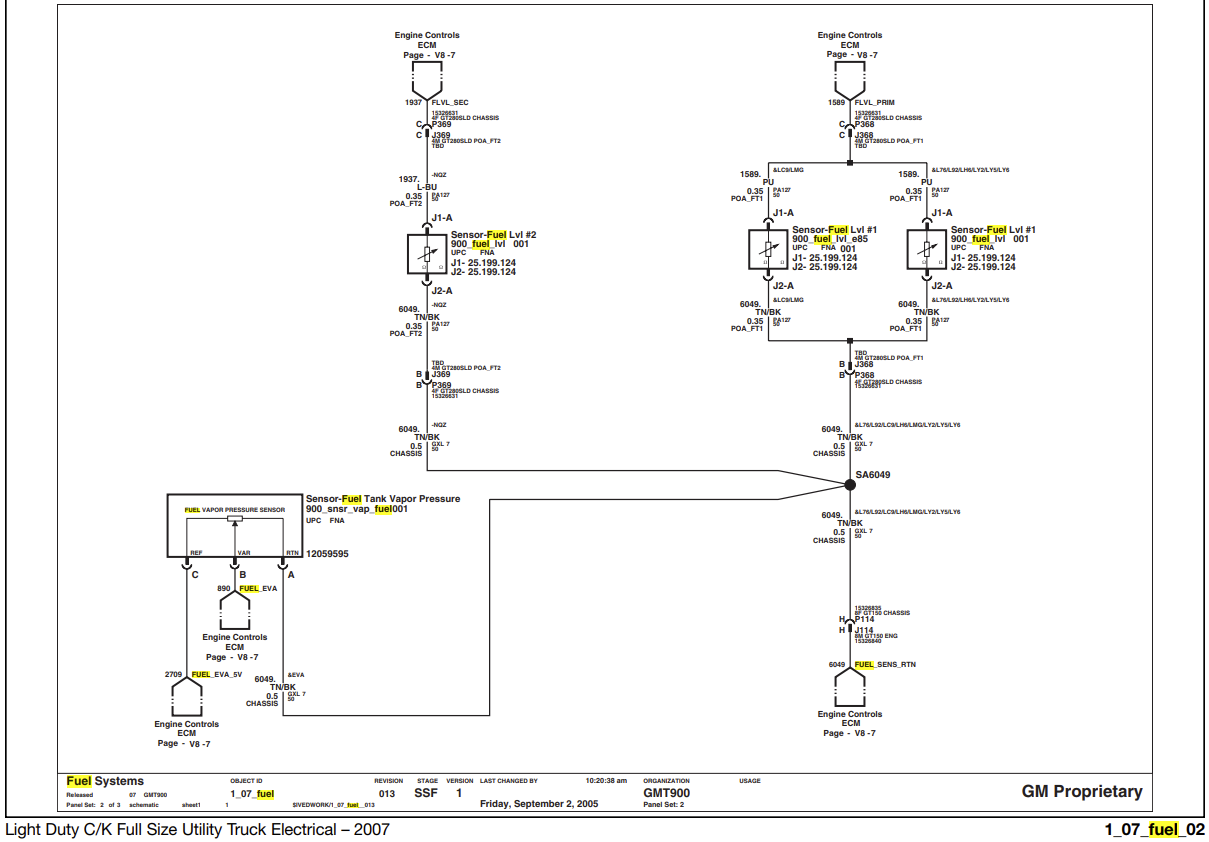

mikez71
Mar 9, 2023
3,370
4,175
Maybe vapor pressure sensor messing with the fuel level signal?
