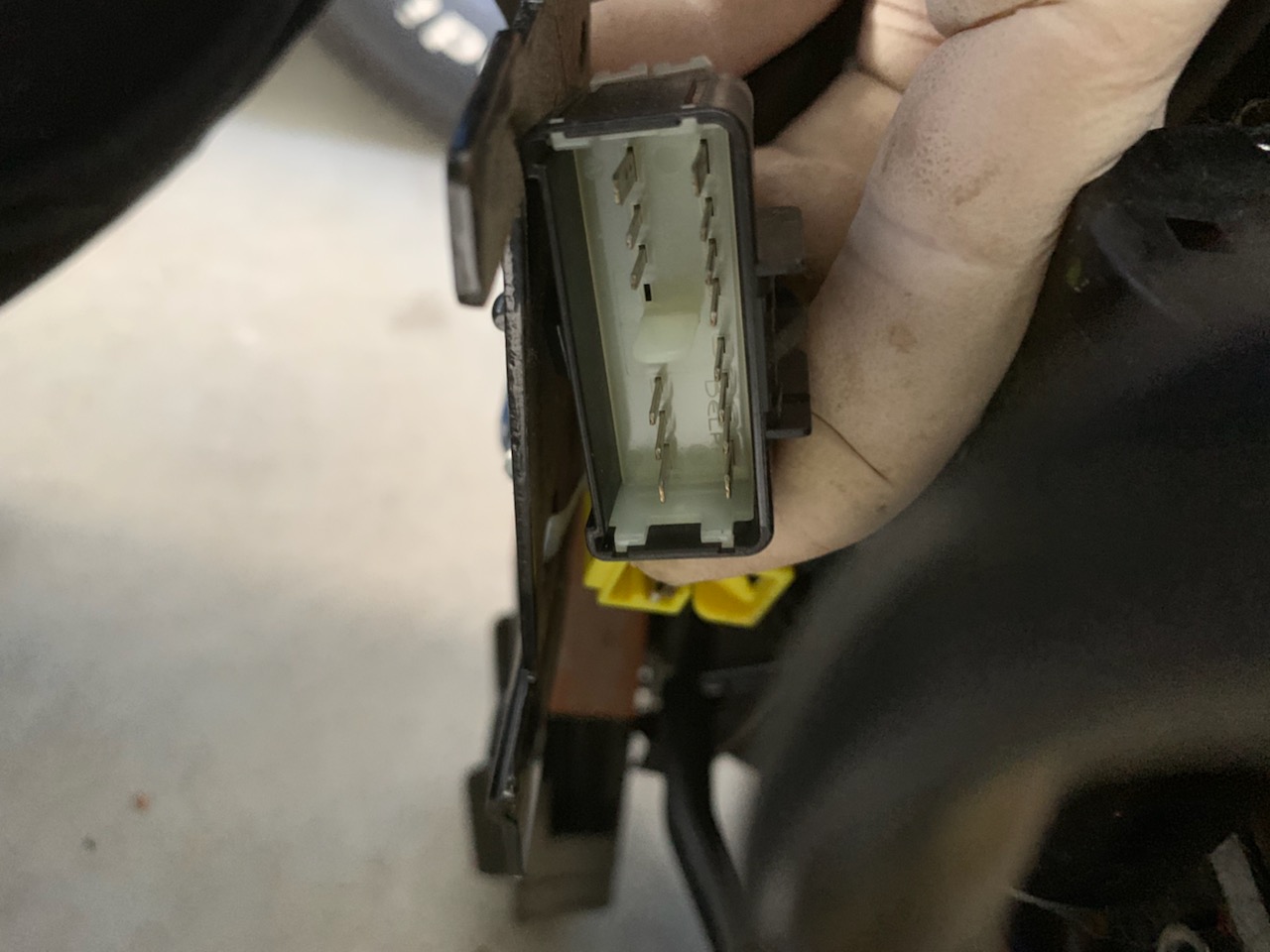

I wonder if my plug in for my 2002 seats will plug right in to a 2003 NBS up to 2006.

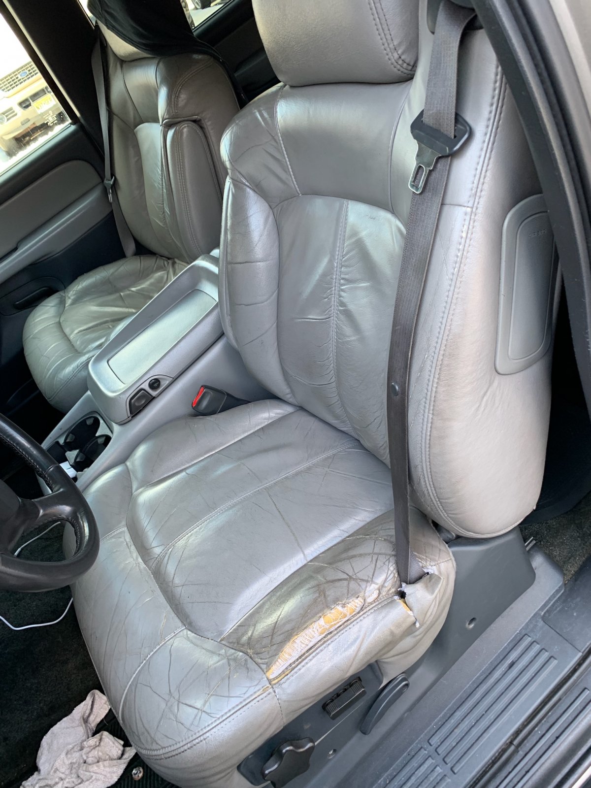

My driver's seat has no tears but the leather is just starting to come up out of that belt hole. I know an upholsterer and he may be able to just stitch there to save it.
That pic of that bad seat is what would happen eventually.

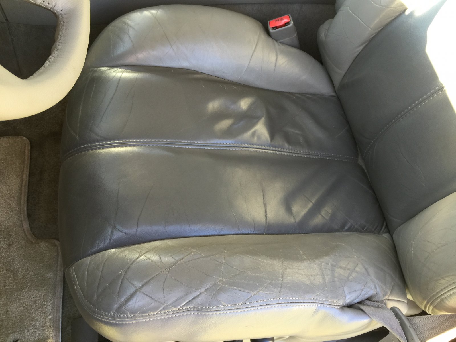

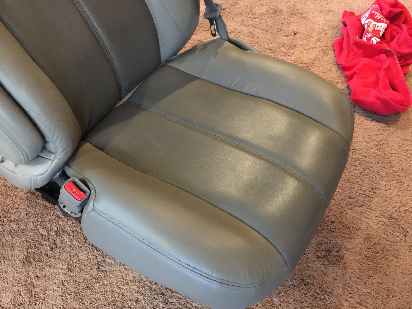

Mine had no tears either but it still looked bad and made the whole interior look worn out. I replaced it and the carpet, repainted some parts, and the interior looked like new again. I used a foaming bathroom cleaner on the rest of the leather and it cleaned it so that it matched the new parts. Best investment ever, the seat bottoms and carpet.

Plugs won't fit.

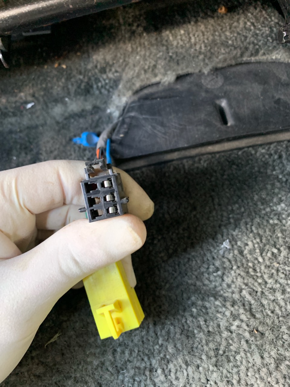

same truck so they bolt right in. wiring isn’t shit bit one power and one ground. the plug has like 10 wires to it but you only need 2 of them for all the functions work. even the lumbar will work off of just hooking up the power and ground.
