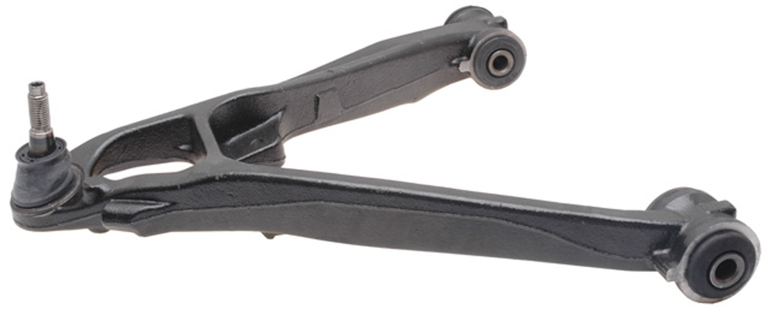

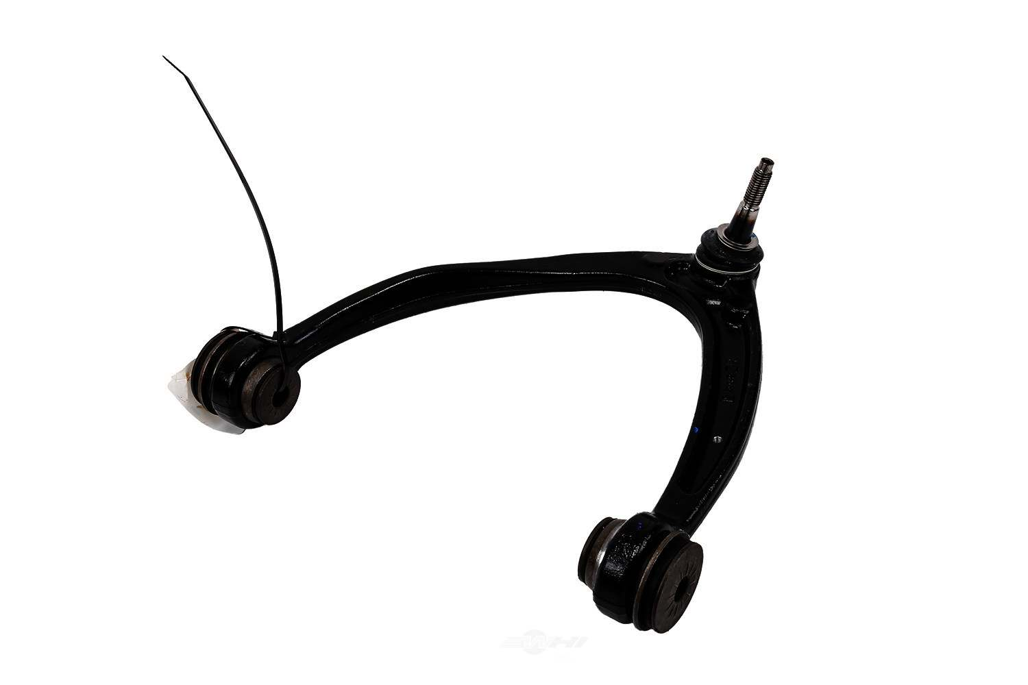

Question: do you have a picture of what a cast iron CA looks like vs. a forged steel?
21,324
30,320
Forged Steel on the left, upper ca, cast iron on the right, lower ca:
It is my opinion that the difference in quality resides in the bushing materials, not the control arms themselves. Assuming of course they're all made to the same standards.
Charlie207
Apr 13, 2021
3,009
5,906
LFOD, New Hampshire
View attachment 459344View attachment 459345
So, forgive my ignorance, are there only cast-iron LCAs, and forged steel UCAs? (discounting aluminum for this question)
As in, there are no steel LCAs/iron UCAs?
