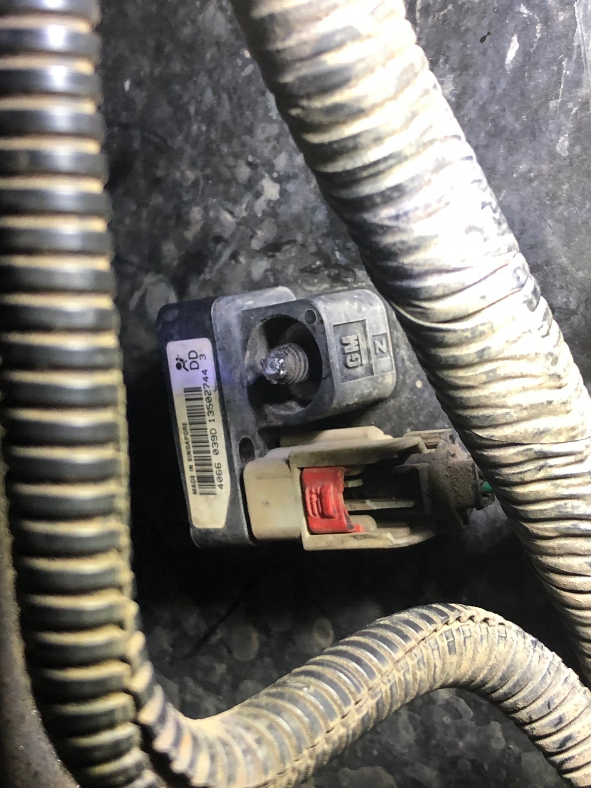

So I've had an airbag light and service airbag warning in my DIC for a while. I've doing research and ordered the part. Everything I've read and watched says it's easy DIY. Located under the radiator, remove the skid plate with 15mm, remove sensor with 10mm. I get under the truck remove the skid plate the sensor is under the radiator but I have to remove the fans first. Is this specific to the Denali?

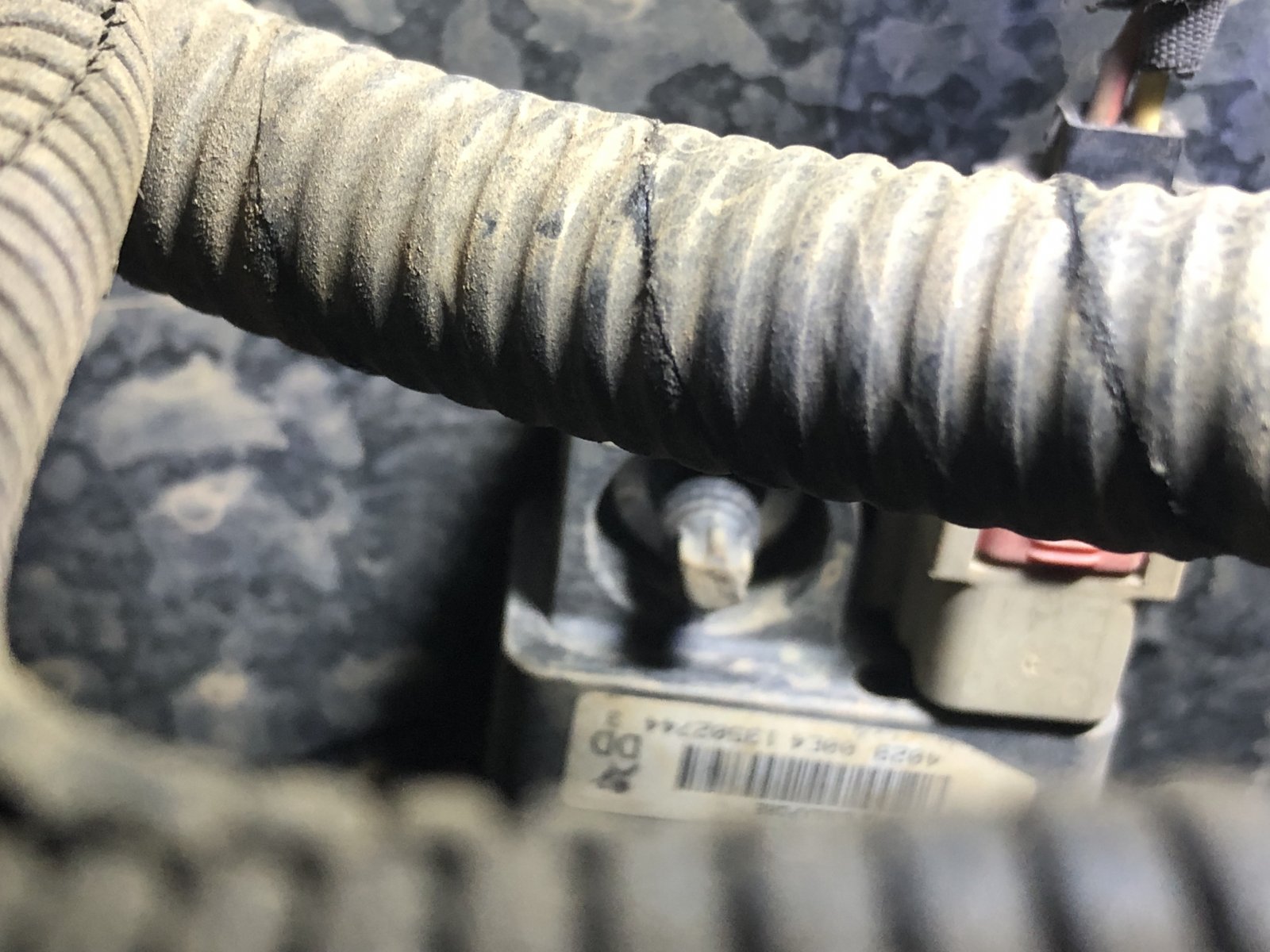

I took the splash guard off. My sensor is not held on by a 10mm bolt. All the videos show a 10mm bolt from the bottom up. Mine is attached from the top down. I can’t tell what size or type of fastener is holding it on. The head of the bolt or screw is above.

It’s a 2012. Both sensor are mounted this way. I put the splash shield back on. I’ll get a picture tomorrow morning.

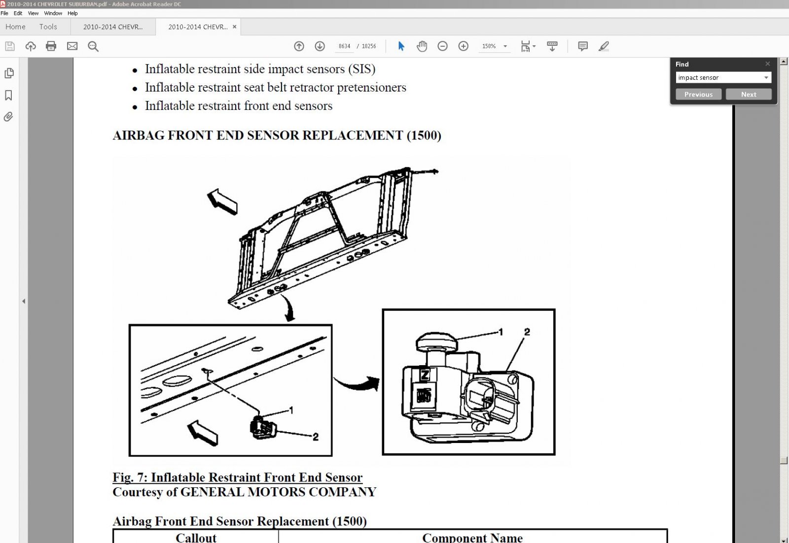

mine is a 2012 there on the bottom, they have been since at least 00 as far as I know, even the GM service manual shows it on the bottom

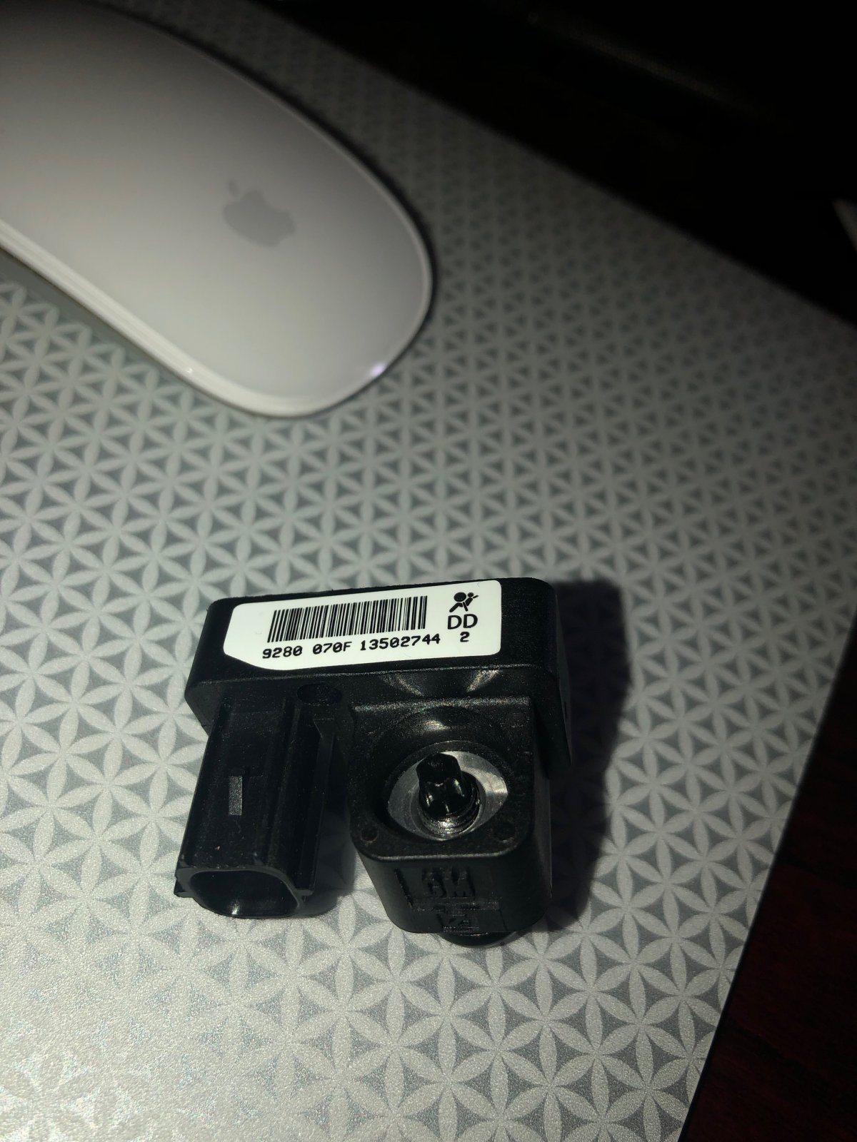

Yes, I have the one in your picture. Dorman 590-225. Dorman 590-224 is the one everyone on youtube is replacing for pre 2010. What your picture doesn't show is the fan right on top of the radiator support or whatever that frame piece is. No room between for even my hand to touch the screw head. But I'll jack it up again and try to get a decent picture. It's funny that there isn't any videos on youtube for a 2010+ Silverado, Sierra, Tahoe, suburban or yukon airbag sensor.

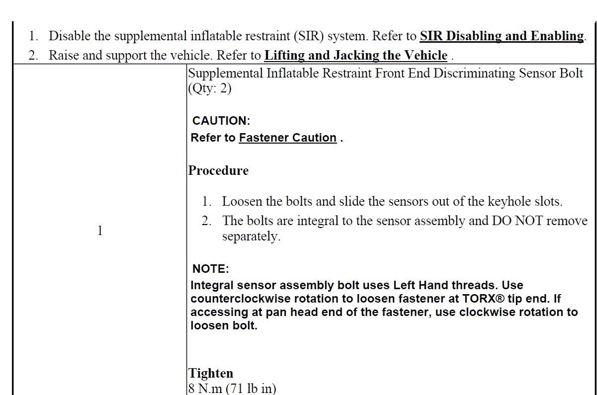

that picture is from the 2010-2014 factory service manual as is the procedure to r&r it in the next photo, if you had to take the fan out it would say "remove fan" etc, etc
looks like it has a torx bit instead of a 10mm, you will need to loosen it and slide it out of the notch

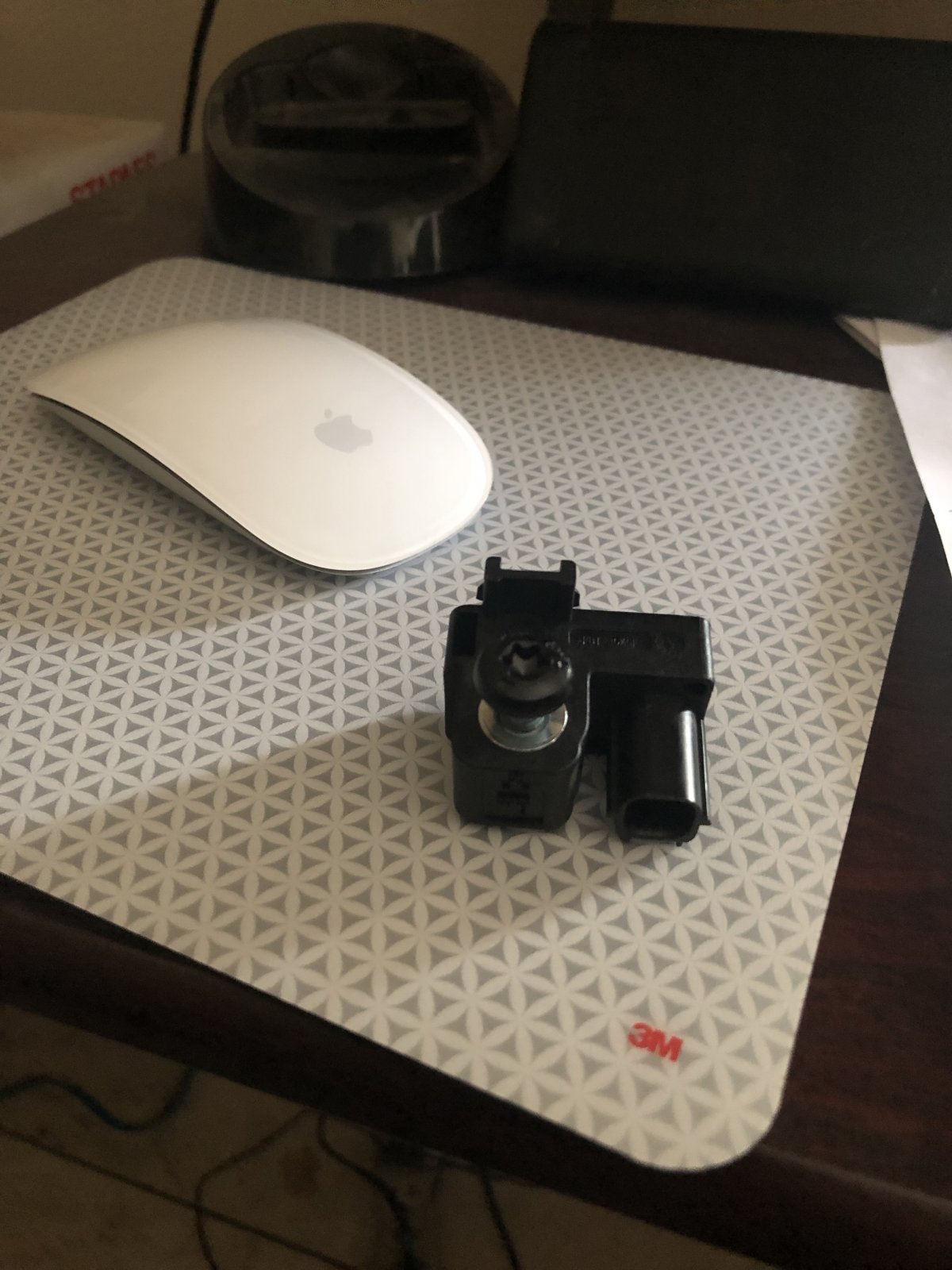

I couldn't tell from under the truck and I have never seen a hex head with male torx tip screw. I just saw the hex head on the other side when I examined the new part. So now I just need to buy a torx socket set. Thanks again bro. You're awesome.

Broke the tip off. I guess I have to pay someone. It's an E5 torx if anybody tries in the future. I don't know how I could have not broken it. With a 1/4 in drive ratchet I couldn't put much torque on it. And it looks like someone else tried and broke the plastic clip. Bummed.
