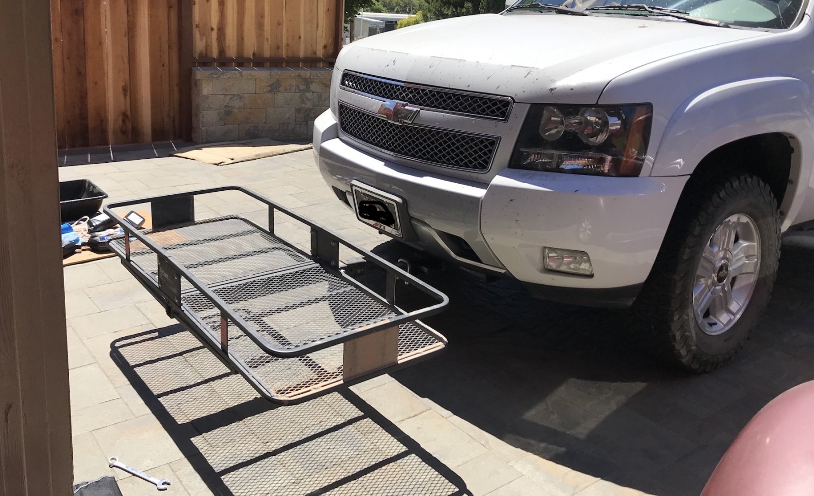

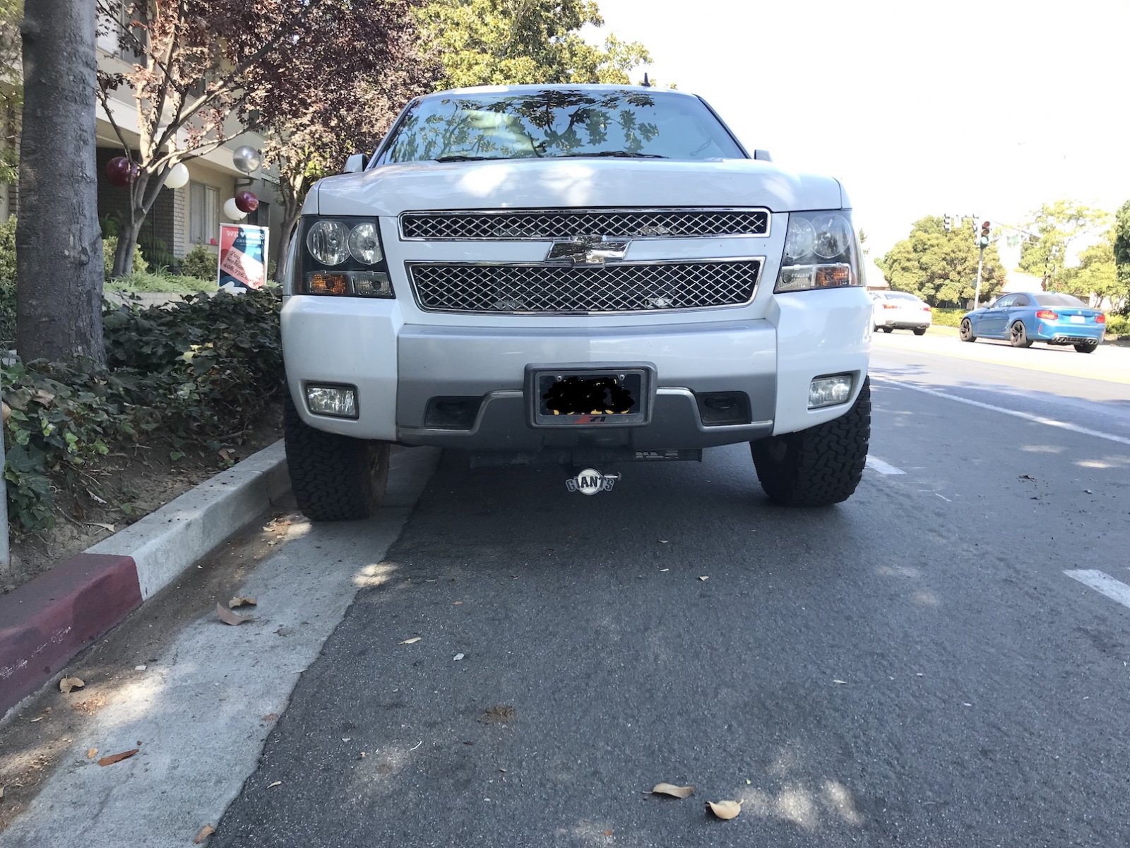

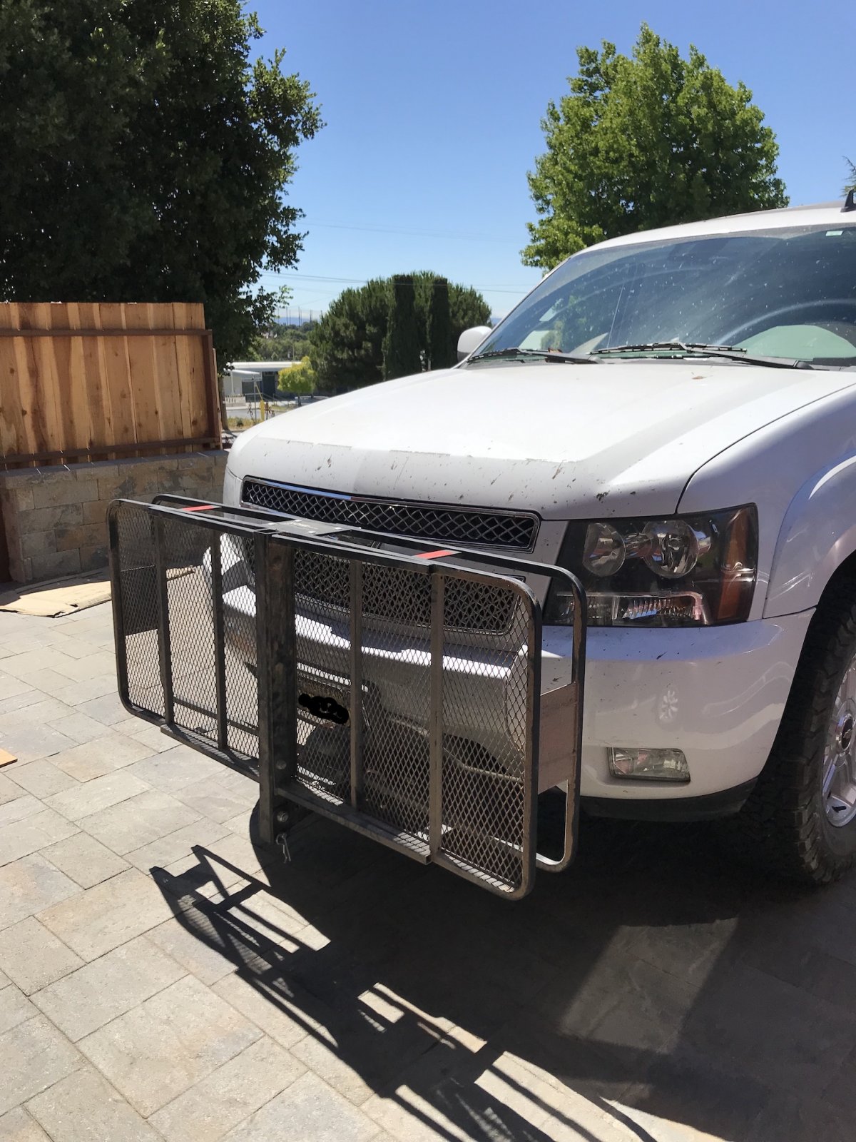

This is my z71 with a 2" leveling kit running the Curt front hitch. I wouldn't install a hitch if I wasn't leveled, the angles wouldn't be very usable. I do scrape the Giants logo on the hitch when I'm roaming the mountains of southern Utah but that's only when I stray from the dirt trails and I'm making my own roads. I did have to notch the bumper just a bit for the hitch to fit, but that was it.
