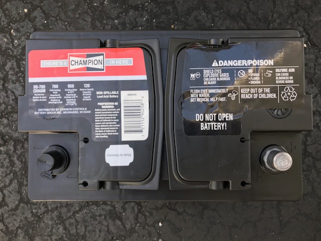

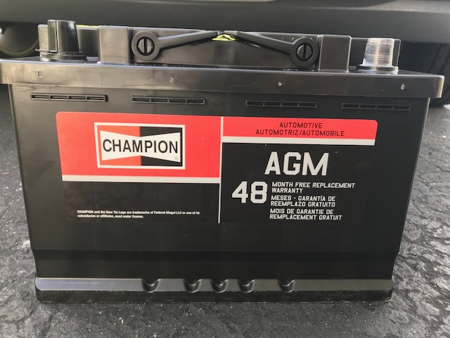

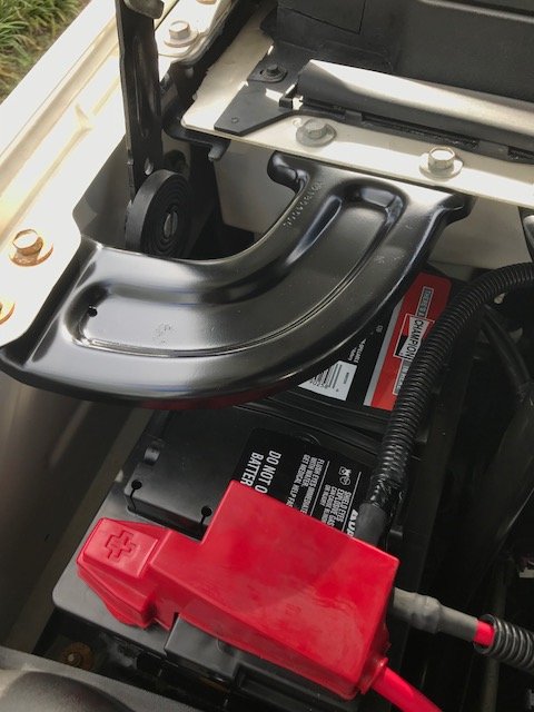

Thx for all the input and good discussion regarding batteries.
I went with a Champion H6-760 AGM battery from Pep Boys.
25% off the battery ($47.50 discount) a $100 gift card that was set aside for truck parts and out the door for $53.37 with a 4 year warranty.
Dropped it back in the tray, had the cables all cleaned and ready to clamp on. Threw on a fresh set of battery post felt pads and added some Super Lube Dielectric Grease for good measure since we had some in the tool box.
Job done and the wife's DD is back in business.

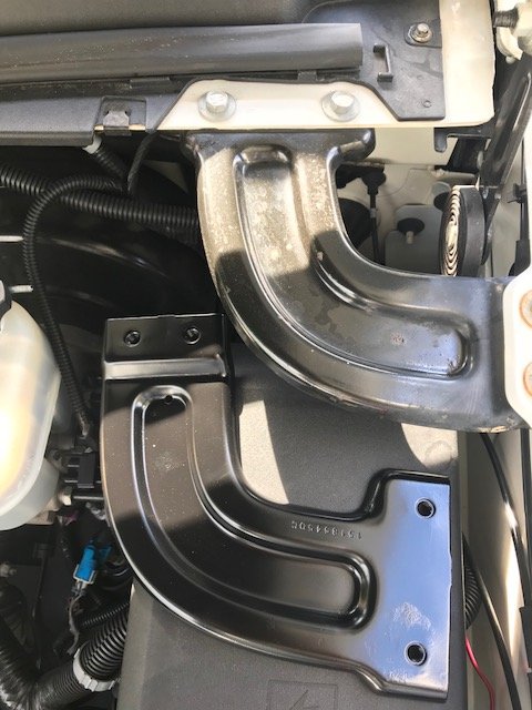

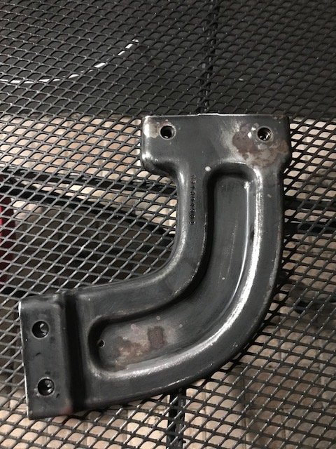

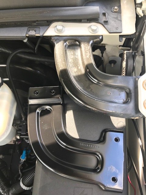

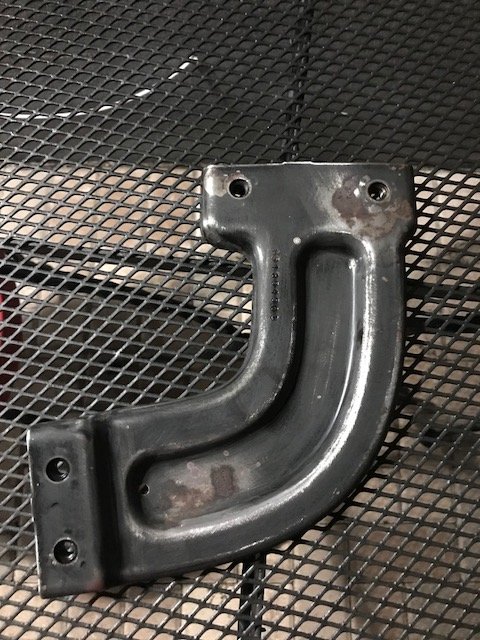

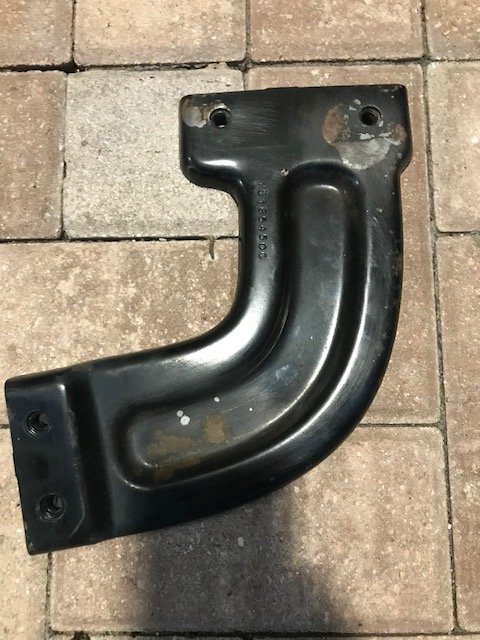

While I had the fender brace off to replace the battery, I gave it a sand and fresh coat of paint. I also drilled a drain hole at the bottom of the brace (my NBS has 2 drain holes pre-drilled in the fender brace), so that the water can drain out and not sit there and rust out the brace like you see in the first picture.

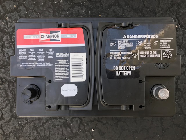

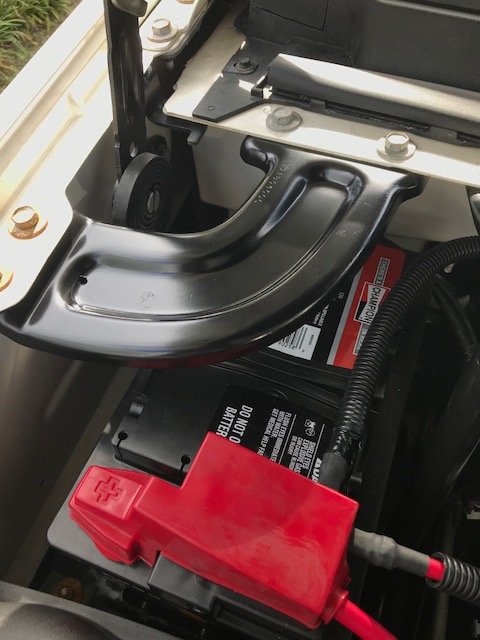

View attachment 208076 View attachment 208077 View attachment 208078 View attachment 208079
In case you didn't know. DON'T OPEN THE BATTERY. Know how I know? The top of the battery said so :D
View attachment 208080 View attachment 208081 View attachment 208082
:lol:
gd foss... every time you touch something it has to go back in perfect, I love it
