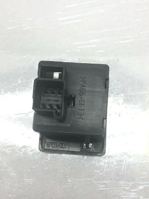

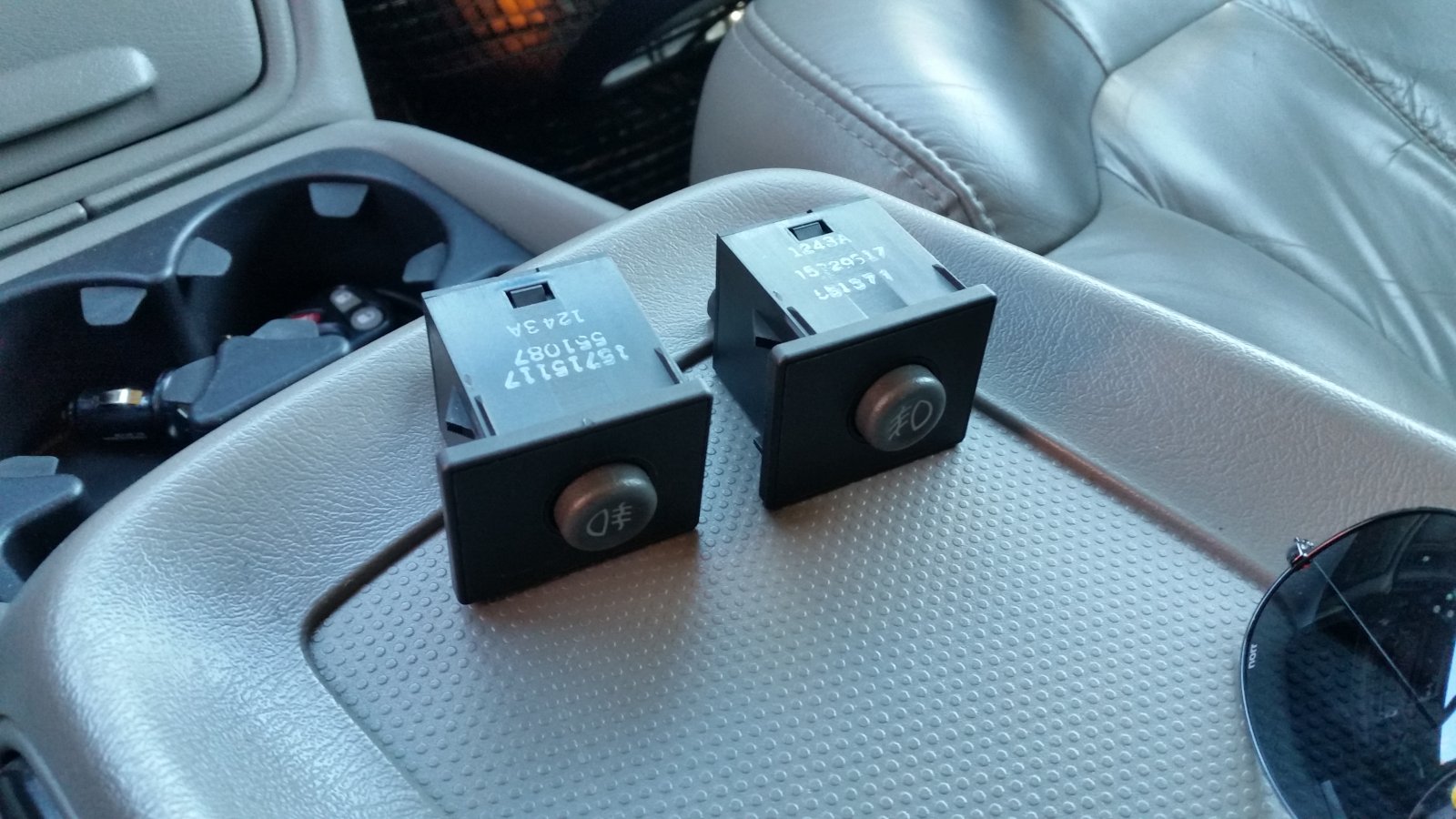

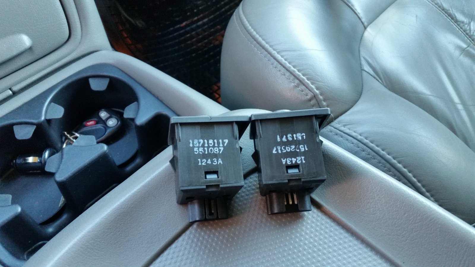

@1BADI5
Here you have pictures how they look. :)

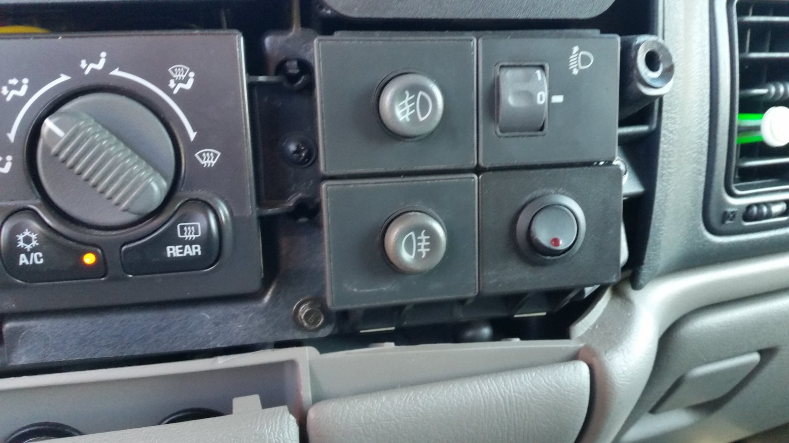

USA switches have a little LED that lights up when the fogs are on. These pics show the backlighting.
Fogs on:
Fogs off:
Your switches don't seem to have the yellow LED indicator.

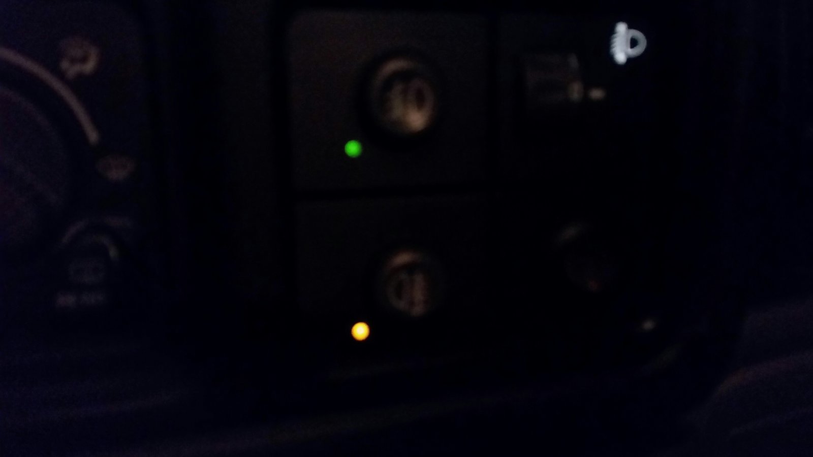

Thanks @Fless :)
Your setup are more logic both in place and where you maneuver the function.
Now my pictures lies, my phone do take in more then three times light against what I see.
Did see the background lights doesn't exist.
Good I really need new switches.
I apologize for the poor quality...
Off
On

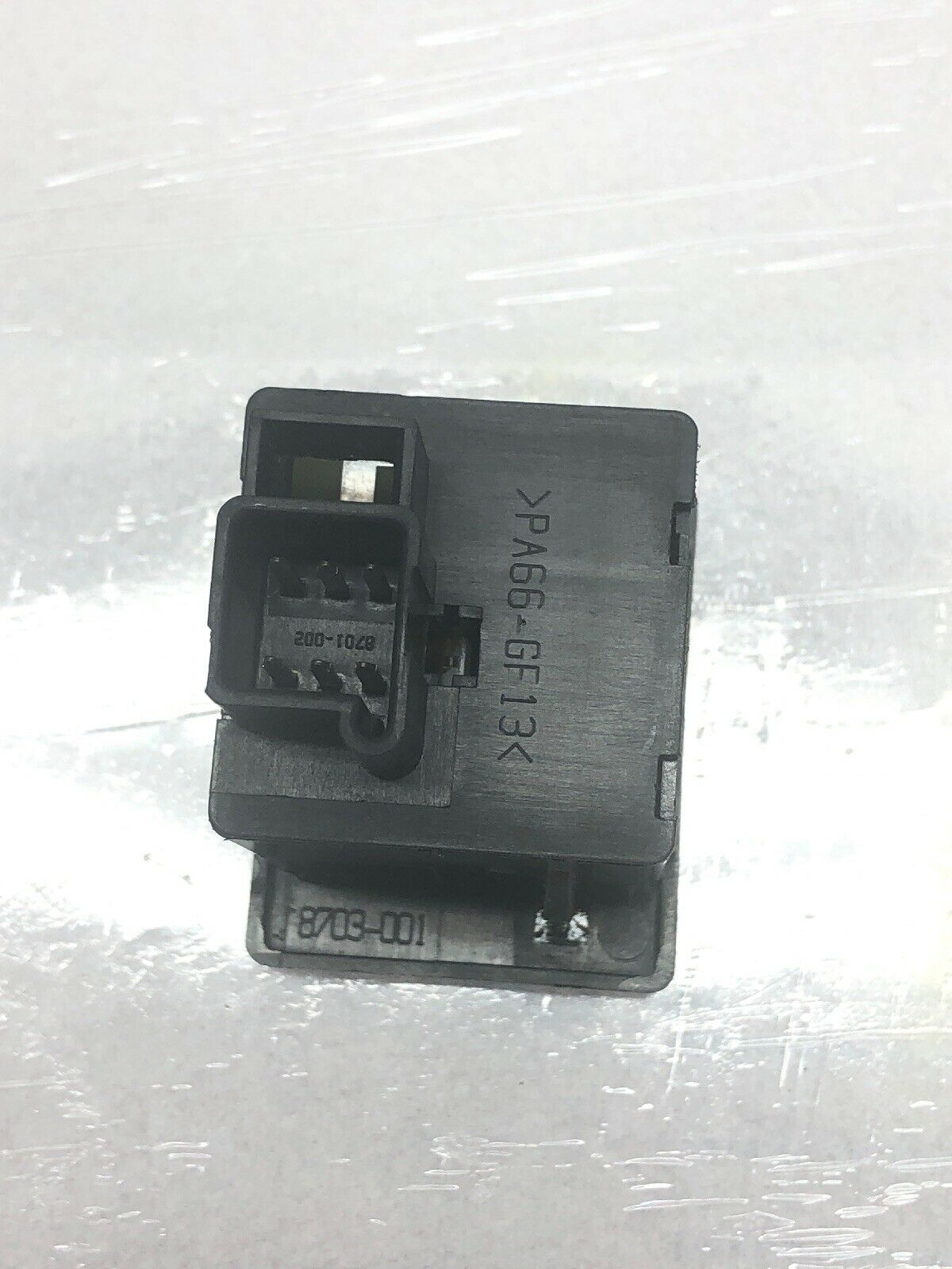

this is the USA version of that switch
(this lights up the bed Aux lamps on the silverado GMT800)
I had a silverado I remembered that switch
is the pin out the same?
https://www.ebay.com/itm/99-06-CHEV...AMP-SWITCH-SILVERADO-GMC-SIERRA-/381583326334

The buttons I have can as you say just be a flip over but they have different led inside but otherwise they are the same.
But the one you linking to do have a different connection, my have 5 pins in a row, the pins do sitt connected right to the circuit board so will be a big operation on a small thing. :)
Cut the original harness and connector doesn't feel so good, I really appreciate your help but I think I will try find the right part or go with the ones I have. :)
