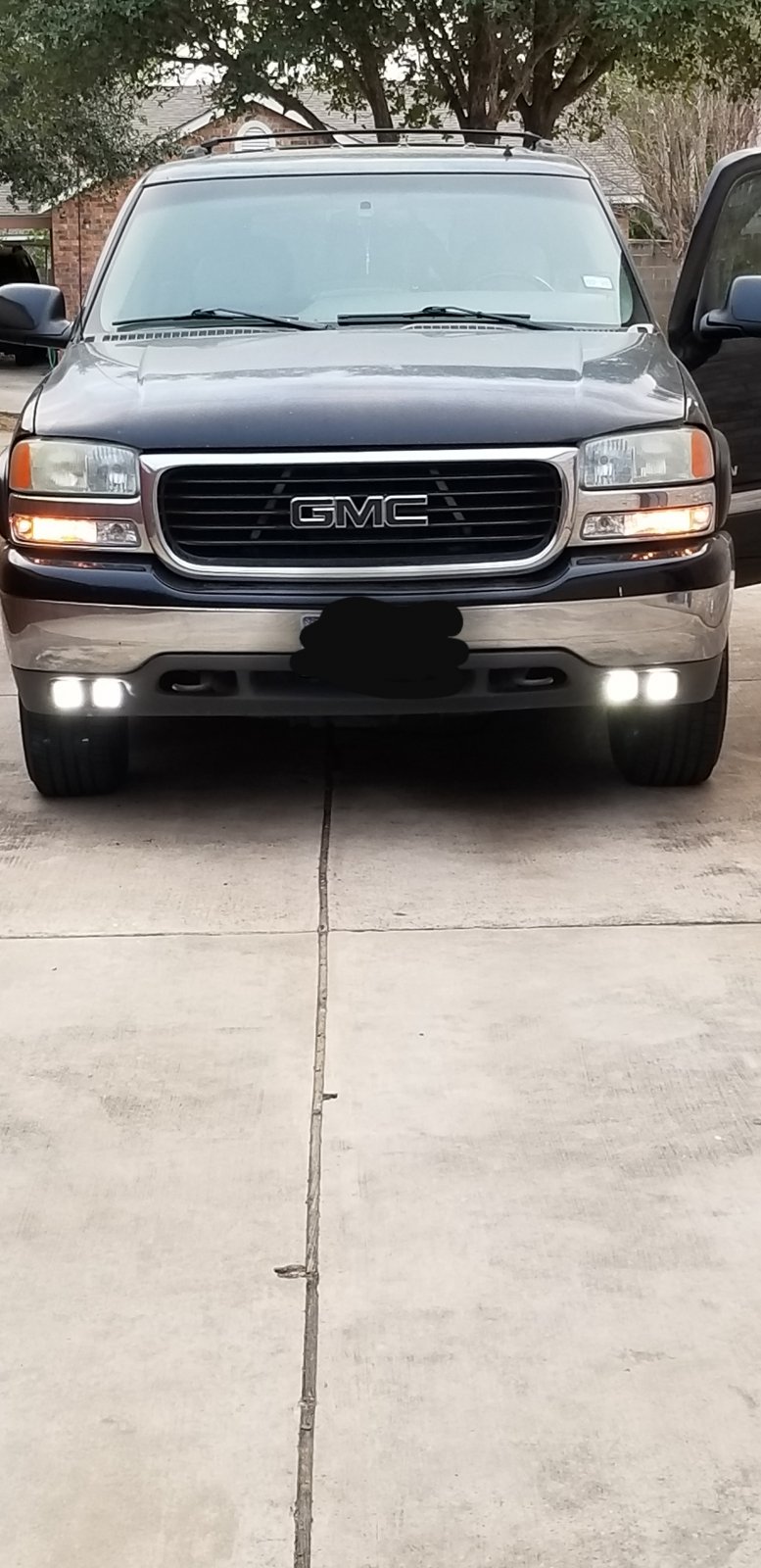

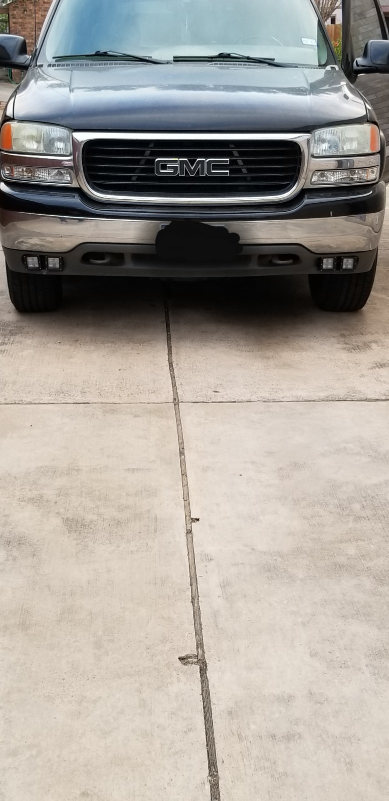

I try my best but one led is crooked i try fixing it but couldn't. I would say not bad for my first sort of retrofit fogs. One of the fogs is not giving enought bright i tryed raising it but still dim i think it might be bad have to switch it.

Nice install. Next time take off your plate so you don’t have to edit the pic:thumbsup:
