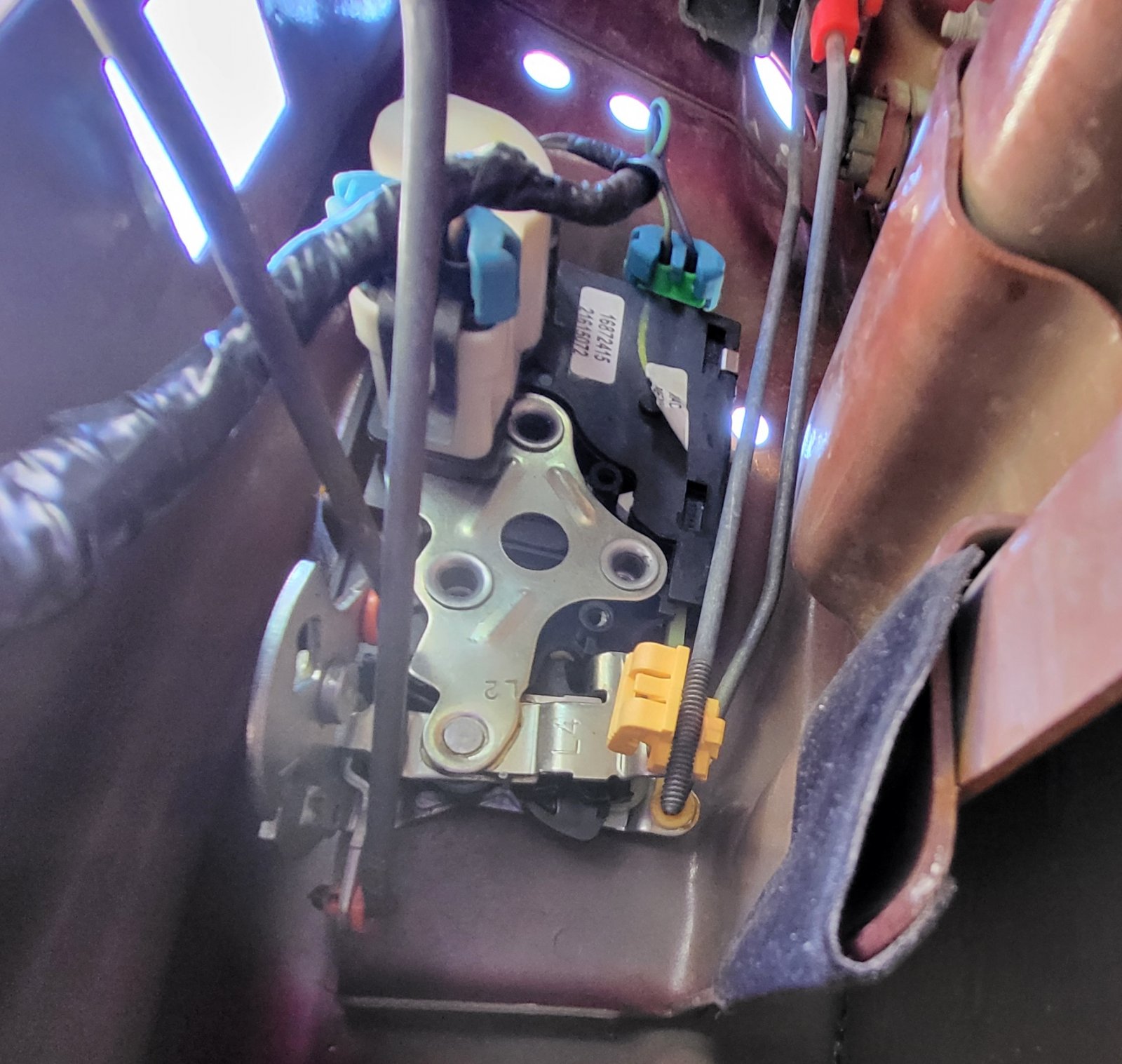

Help me understand -- when you say that the door key stopped unlocking the driver door, do you mean that it wouldn't turn the cylinder? Or that the key would turn but the latch wouldn't unlock the door?
If it would turn the cylinder but wouldn't unlock the door, either the short linkage that goes from the cylinder to the door latch has come out of the plastic retainers, or the door latch itself is defective. I suspect the latter or a poor electrical connection. I think that the lock mechanism from the cylinder is mechanical, though. You may have more issues than that.
Probably looks something like this inside the door panel (the open - in the pic - yellow plastic latch on the right is the bottom link to the door handle; the round yellow one hidden behind it goes to the lock cylinder linkage, red plastic at the top):

Good question, thanks for asking and adding color. The key will not turn the lock cylinder on the driver’s door.
I figured these lock cylinder was bad, at first, until I noticed that it seemed to matter if the door was locked from the fob v. Locked by the power lock switch.
