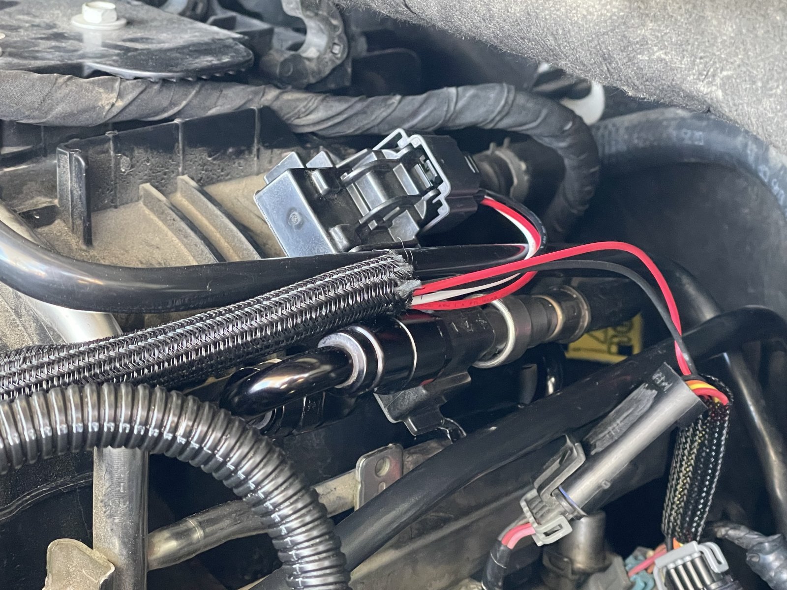

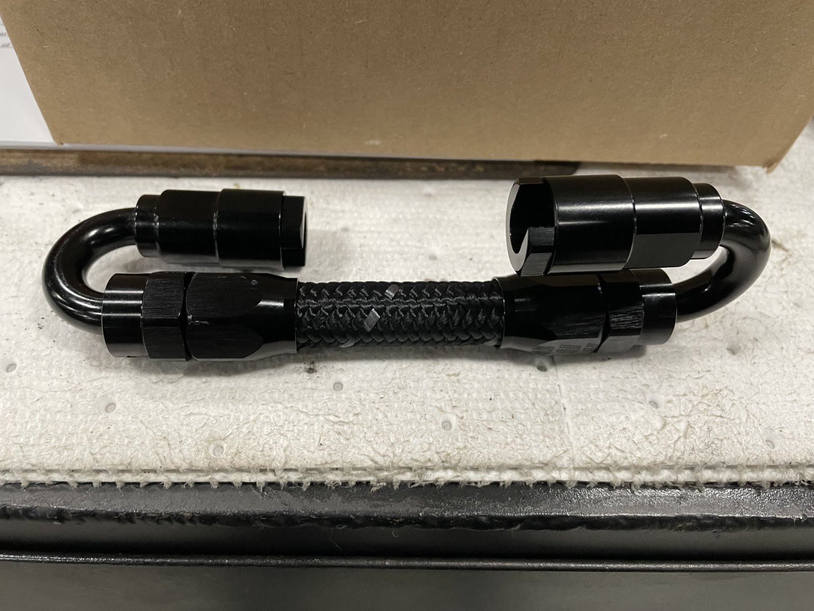

Installed my sensor this past weekend. I followed a thread from performancetrucks forum. Ended up making my own fuel line. I also bought a breakout harness from ballenger motorsports for the power and ground. It plugs into an ignition coil so you don’t have to splice the wires.
Parts I used:
Ballenger Motorsports CONN-85931
Russell Push-On EFI Fittings 611233 from summit
Summit Racing™ Premium Braided Nylon Hose -6 AN 3 ft. SUM-240603BP
ACDelco GM Genuine Parts Flex Fuel Sensors 13507128
Hoypeyfiy flex fuel sensor harness from amazon
GM part #13575575 - Wire for pinning pcm
Truck is cammed and remote tuned by GPI so I already had a flex fuel file to load in once I had it hooked up. I didn’t take a picture of it installed but I will get one.
