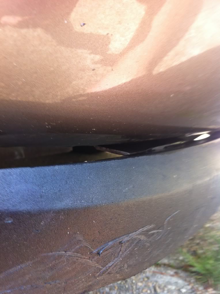

1.The front valence is coming off. Is there somewhere to order another? I know you just slide it on but then it is really bent and doesn't stay on long.

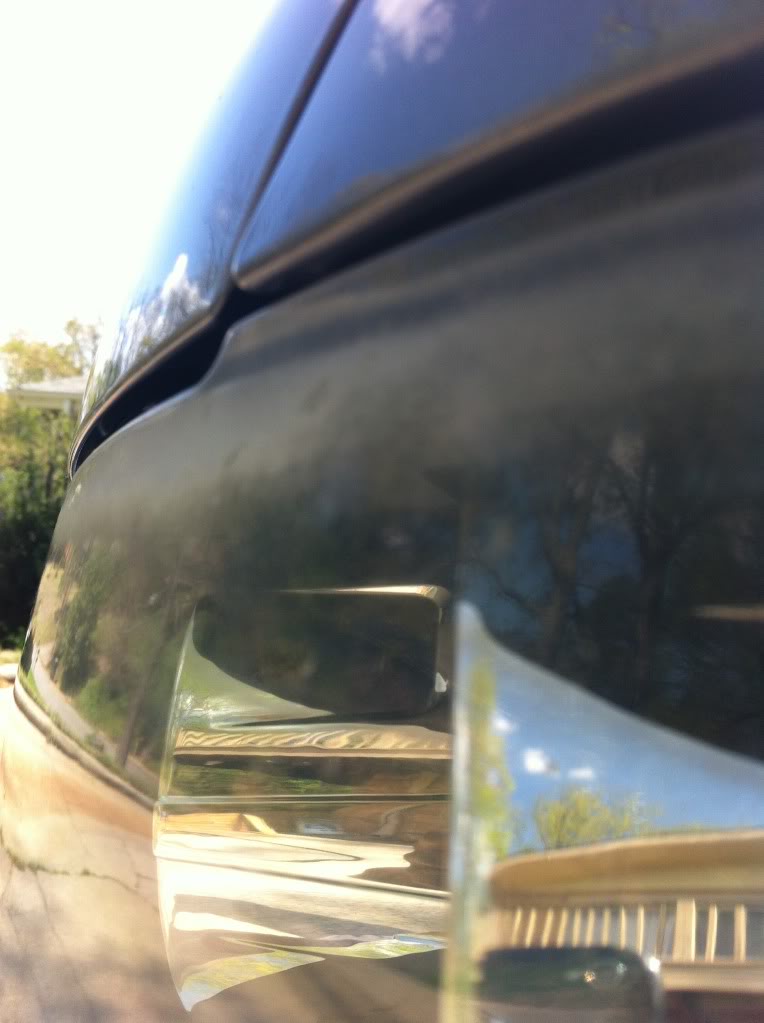

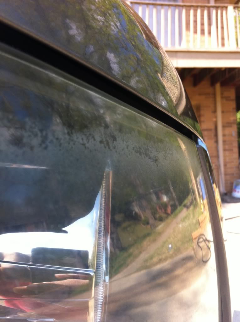

2. My head lights have this film on them that doesn't come off. Is there like a solution I can by to get that off or is it best just to buy new headlights?

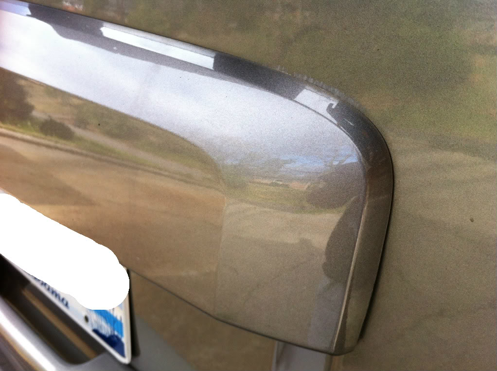

3. The rear applique or whatever isn't secured all the way on the rear, and it slides up and down and just moves alot. Is that normal or how do I have to go to the dealer to get it secured better? You can see it in the bottom right corner of the applique and the top right corner.

1. The valance, if it doesn't have broken tabs them you could secure it tightly.
2. Go to your nearest auto parts store and buy headlight restorer. Many brands make them.
3. I'm pretty sure the appliqué shouldn't move at all you should have it checked.

Looks from all the curb rash that valance might have missing tabs.
Headlights are in need of that plastic cleaner stuff, simple.
Hatch inside cover must be removed to gain access to bolts for applique.

for the back trim piece, those pieces are screwed on from the inside panel, dont bother going to the dealer to get it fixed. just un pop the inner panel and ull see them plenty of holes to get at them. i noticed them wen i did my rear wiper delete on my 08.

Alright I will do so. The valence on the front doesnt have the spots to put it on permanately anymore so how should I go about getting a new one?

I ordered my replacement lower valance piece directly from my locla dealer. It was less than $60 and it came with the 2 screws that secure it on each end and all new tabs through the middle.
