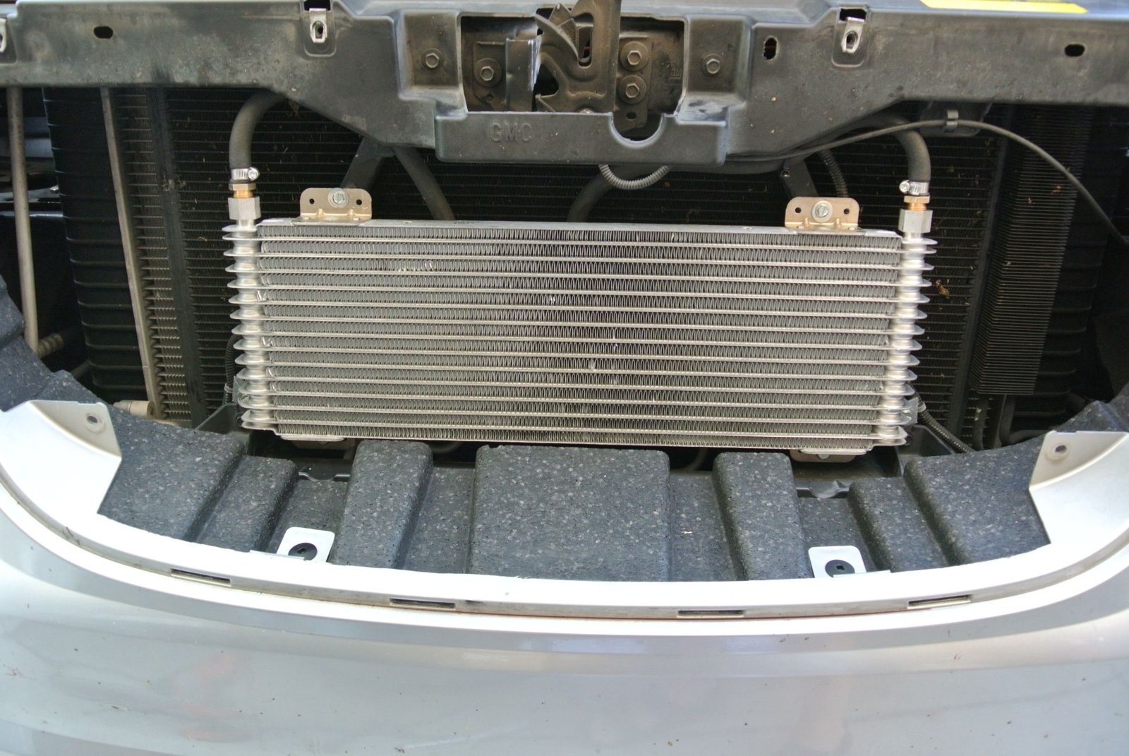

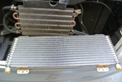

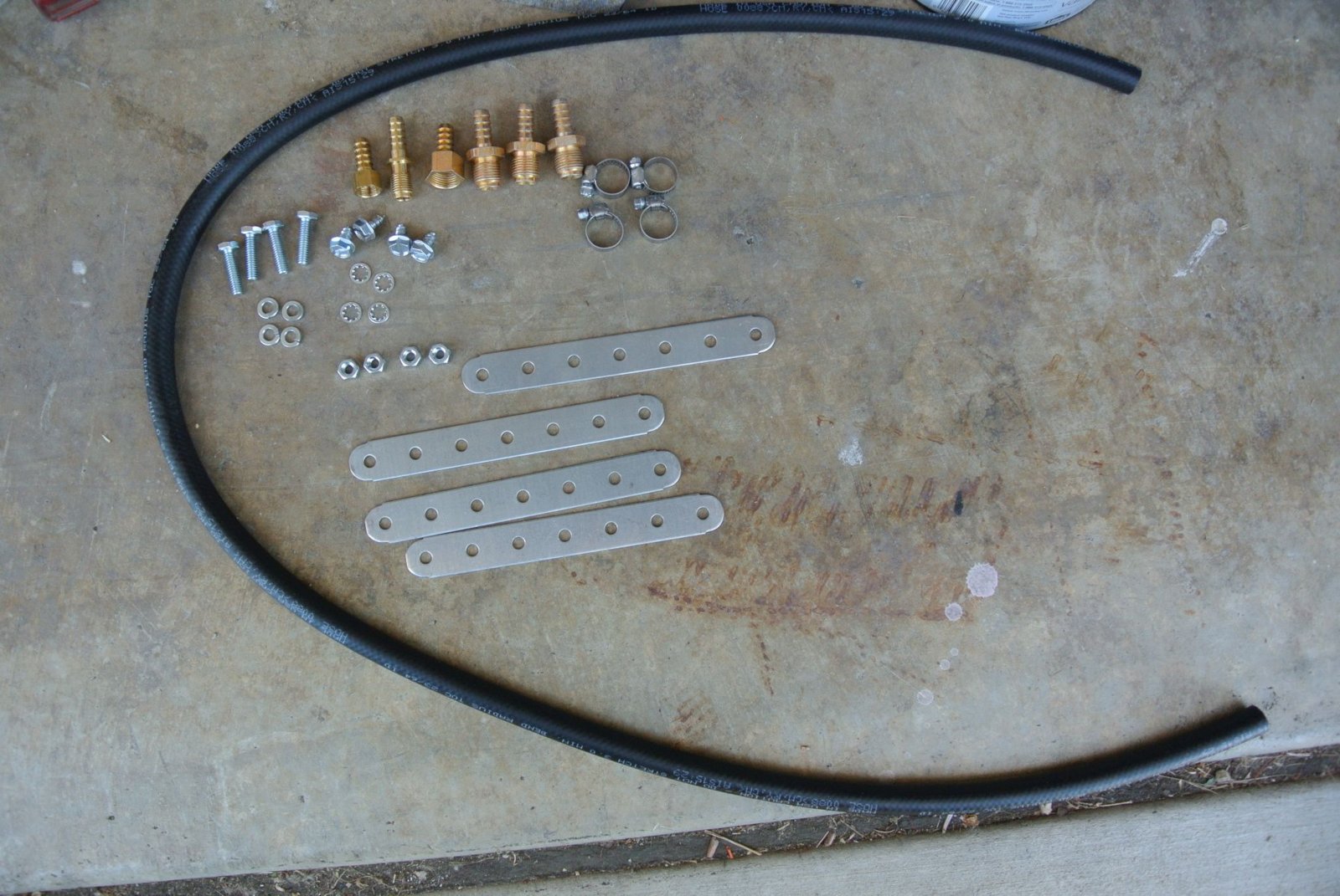

I haven't gone the mishimoto radiator route (yet), but they posted on the forum a couple of months ago about it. the transcooler is a Tru-Cool Max LPD 47391 I have pics of it installed, what it comes with (hardware) and then with it compared to the flexalite, you can find it reasonable on ebay or amazon
30,774
48,481

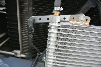

I had to make minor modifications to the mounting bracket holes with a dremel tool to get the bolts lined up on top, then on the bottom I just lined up the brackets where I needed them and then cut them shorter, I also used standoffs behind the mounting bracket so nothing was rubbing, you may want to pick up some standoffs from the hardware store there not included with the kit. I forgot I also had to move the ambient temp sensor to the side on a bracket because it was telling me it was 150deg outside, you can see the standoffs and the sensor in this picture
