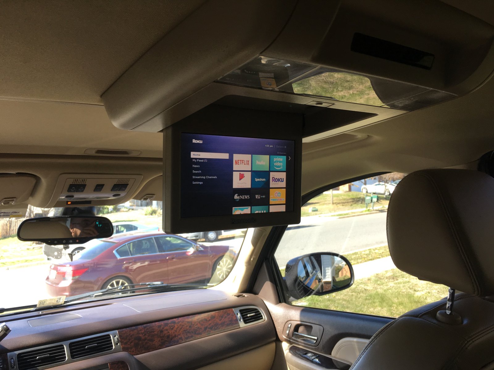

Finished adding Roku Device to the Truck
Sep 6, 2016
69
44
Northern VA
delightskinned1
Sep 6, 2016
69
44
Northern VA
You talking about splicing into those cables in the console?
Was Pretty easy this is what I used...
* Roku ( or any streaming device )
* HDMI in Composite cable out converter box.... Both devices require power
* Additional GM Video Input terminal GM#10375379 ( or splice into the existing one )
* AV cables to connect the two
Everything is tucked and powered from neatly behind the panel, did not even have to unscrew anything!
Other than the roku which was just a spare I had in a drawer everything cost about $30 total off of amazon.

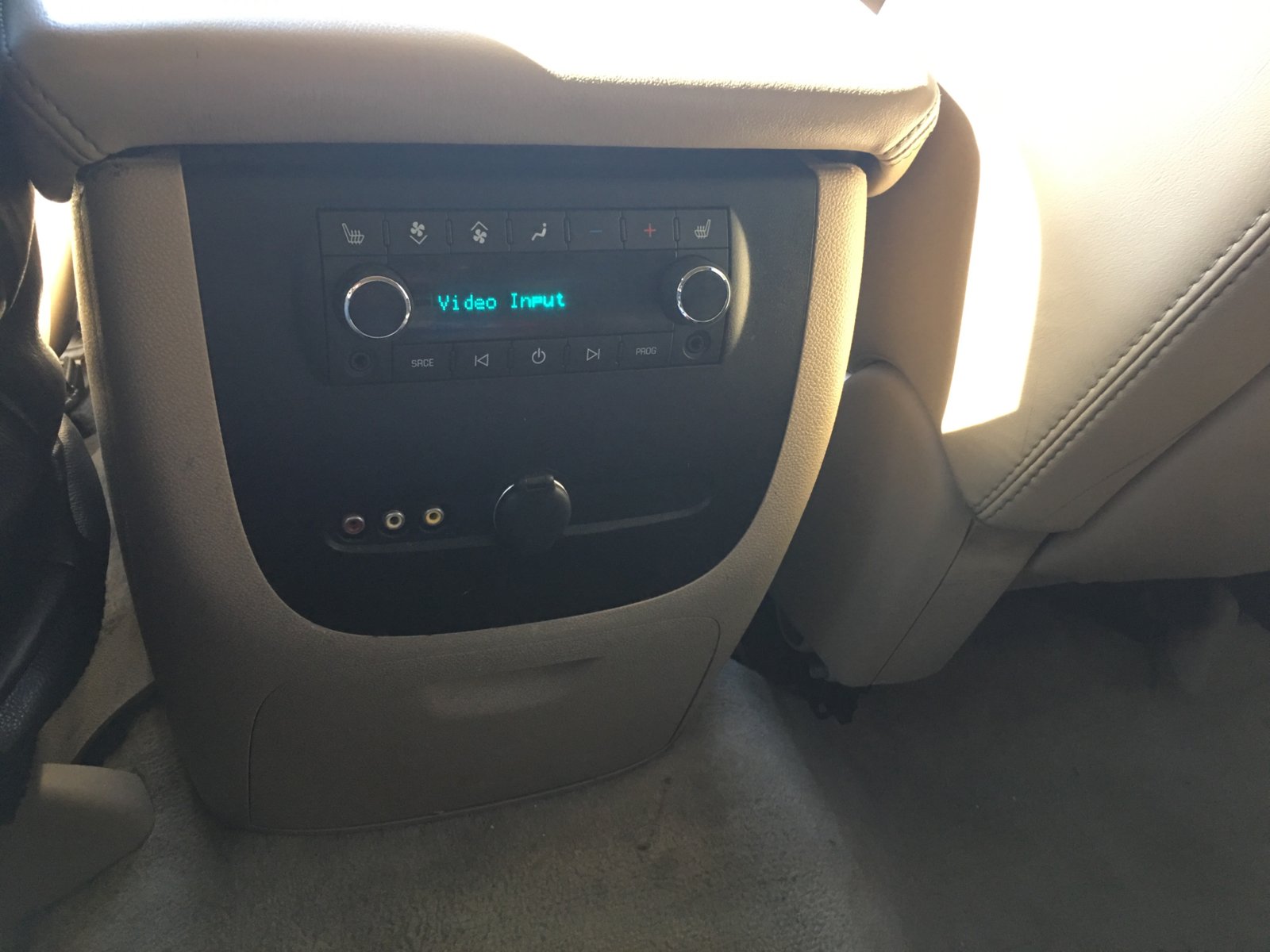

What did you do with the additional terminal?
delightskinned1
Sep 6, 2016
69
44
Northern VA
I installed it So I could keep everything hidden and still use the original set if I wanted to play something else... For $9 it cost kept the install a lot cleaner. The most important part is that box Because just a standard adapter won't push the signal because of the older style hookups on the truck
Mrhug3
Nov 25, 2011
82
91
Midsouth?
Did you just unplug the original and leave it in place? There is a Roku now that uses RCA style connection. I'll just get that.

There may be an easier way. I just realized this setup is special because its with the OEM HU. There is an A/V to HDMI cable you can buy off amazon which would convert the A/V output on that back panel to HDMI. Wouldnt that alone allow the Roku, Amazon Fire stick, chromecast work without any other additional work? Similar to plugging an old video game system. You could power it with the cigarette lighter under the center armrest too.
Just realized it wouldnt be hidden without something custom done so this route you went seems pretty good :)
The simple adapter does not work ( I tried that first ) but the converter box was just a few bucks more... and yes I did tap into the power source you referenced under the armrest of the truck. I did the extra spicing work to make the instal cleaner and still allow me to use the plugs for anything else that may come up later on down the road... I have 4 kids so I have to make sure all the outlets are always available for trips lol
