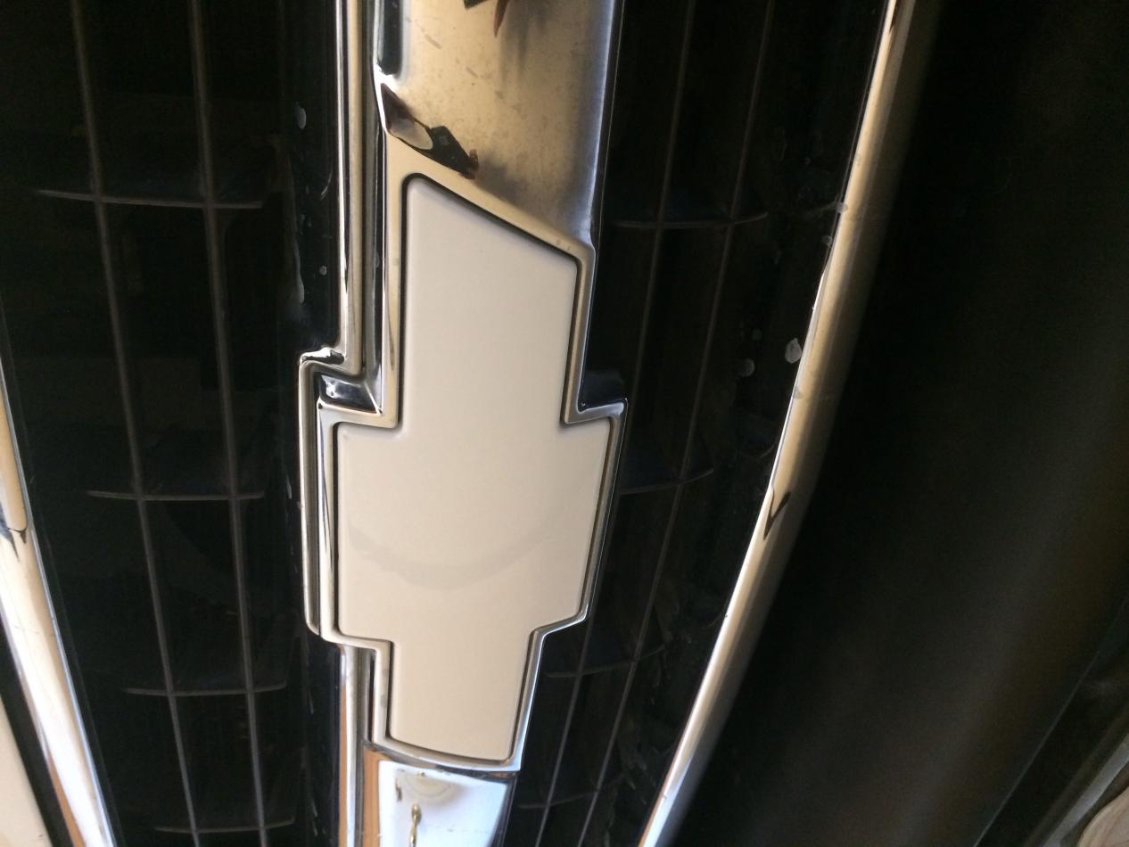

Sanded, 4 coats of primer, sanded, 4 coats of white, sanded, 4 coats of clear sanded, and then finally 2 coats of clear again. Came out nice I say.

Been thinking about doing this or buying a black one, my question tho is why do you sand so many times?

That looks great, looks better than my blacked out bowties
I was gonna do black but I see that all the time even pink so I figured white will do for now. Mossy oak would be dope!
---------- Post added at 06:45 PM ---------- Previous post was at 06:43 PM ----------
Cause I sanded before my primer so I could get oils off then sanded my primer so the white has a better hold to the primer then the clear so I could get the small marks that were bugging me. I'm kinda OCD I hate minor imperfections I still got some body work to do
