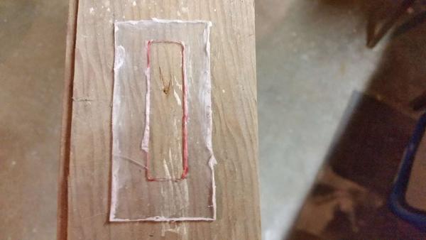

To build my confidence I first dremeled a hole in a CD case cover. Got some practice, and then ended up with a template.

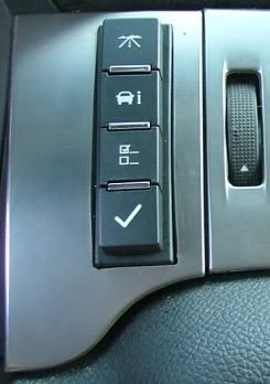

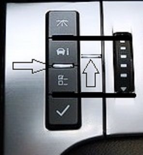

I looked at the pictures and used those to measure. I saw that the length of the silver line between the buttons was the same distance between the switch and the line on the right edge. Also saw that the switch sits a bit lower than the vent control.
Looking at a factory one I should have opened it up around the edges a little more. But I also gave myself room in case I screwed up. Instead of the factory type cutting I could keep going and trim it out on the second shoulder if I needed to correct a bad cut.

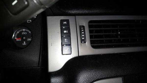

Used my glue gun to mount the thing when I was done.
Not perfect, but better than having it hang out of the trim as it has been sitting for months.
