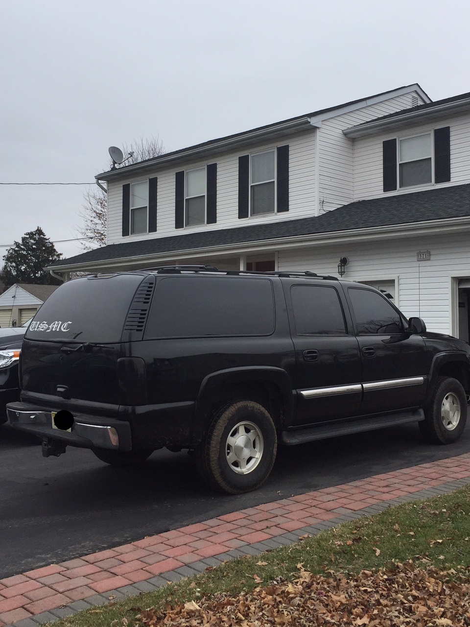

Finally got around to it. Cranked the keys up front to match rear. I ordered the shock extenders from this kit from rough country but the side bolt holes were off by quite a bit. Bottoms holes matched perfectly. http://www.roughcountry.com/gm-suspension-lift-kit-219c.html Don't think its bc this kit is for 07+ but anyways i'm pretty sure I don't need them so ill be returning them.
I also put the auto ride extenders from suspension maxx. Not sure I needed those either it was a tight fit they didn't really seem to be enlonged. Ride is not bad. Loving the way its not super now anymore. Once my toyos are done ill get some 33's. One thing I did notice is my front left shock is leaking oil. I do have the front shock extenders but I couldn't figure out how to lower the control arm far enough to attach to the new extended position. Id like to hear your comments or suggestions. Thanks in advance

These should work

Get new shocks $320 for 5100s and they are lifetime warranty.
