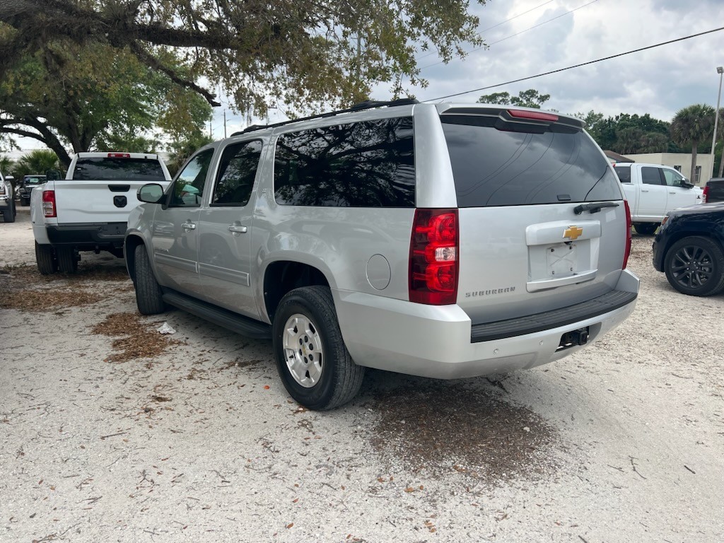

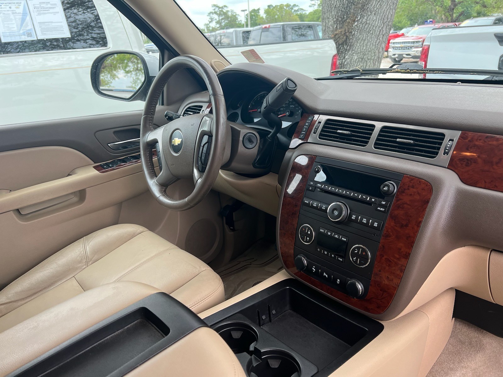

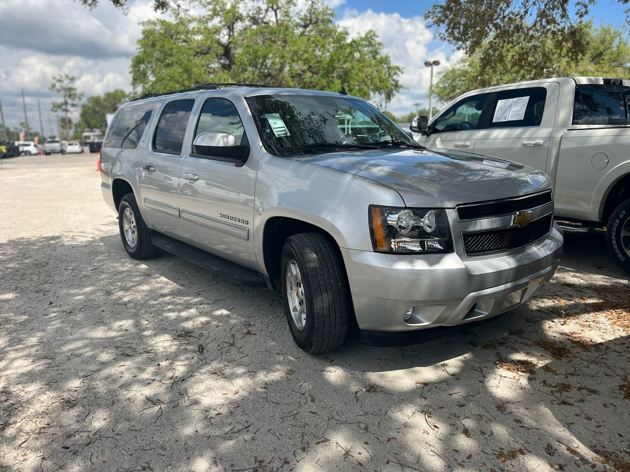

Well here she is, not quite as loaded at the Yukon that we totalled.
2014 Suburban LT, 5.3L, 4x2, and I like the dash color.
All in all not a bad price for the current market for it at $13K with 108K on the clock.
I do have a couple questions:
The backup camera looks like it might've got water inside it, what's a good aftermarket replacement that will fit properly with little to no modifications?
AFM kinda scares me a little, should I drop the money to remove it or just let it ride?

Nice looking rig, and great low mileage!
AFM: disable 100% ASAP. If you’re up for it, a mechanical disable would be preferred, and of course, there would be a nice list of “while you’re in there” parts.. :naughty: , but definitely do the AFM disable, via a Range device, or similar.
21,322
30,319
Looks to be in great shape and that price is a steal!
I don't know about aftermarket cameras, sometimes there are used ones with your color on Ebay, otherwise a new camera with the applique is about $500 and needs to be painted or covered with chrome cover.
As for AFM, get the truck tuned by BlackBear and have him turn it off. Your truck has all the latest improvements and it is quite reliable but still prone to failure when the solenoids get out of time. As always, keep the oil and transmission fluid clean and fresh and she'll last a long time.
