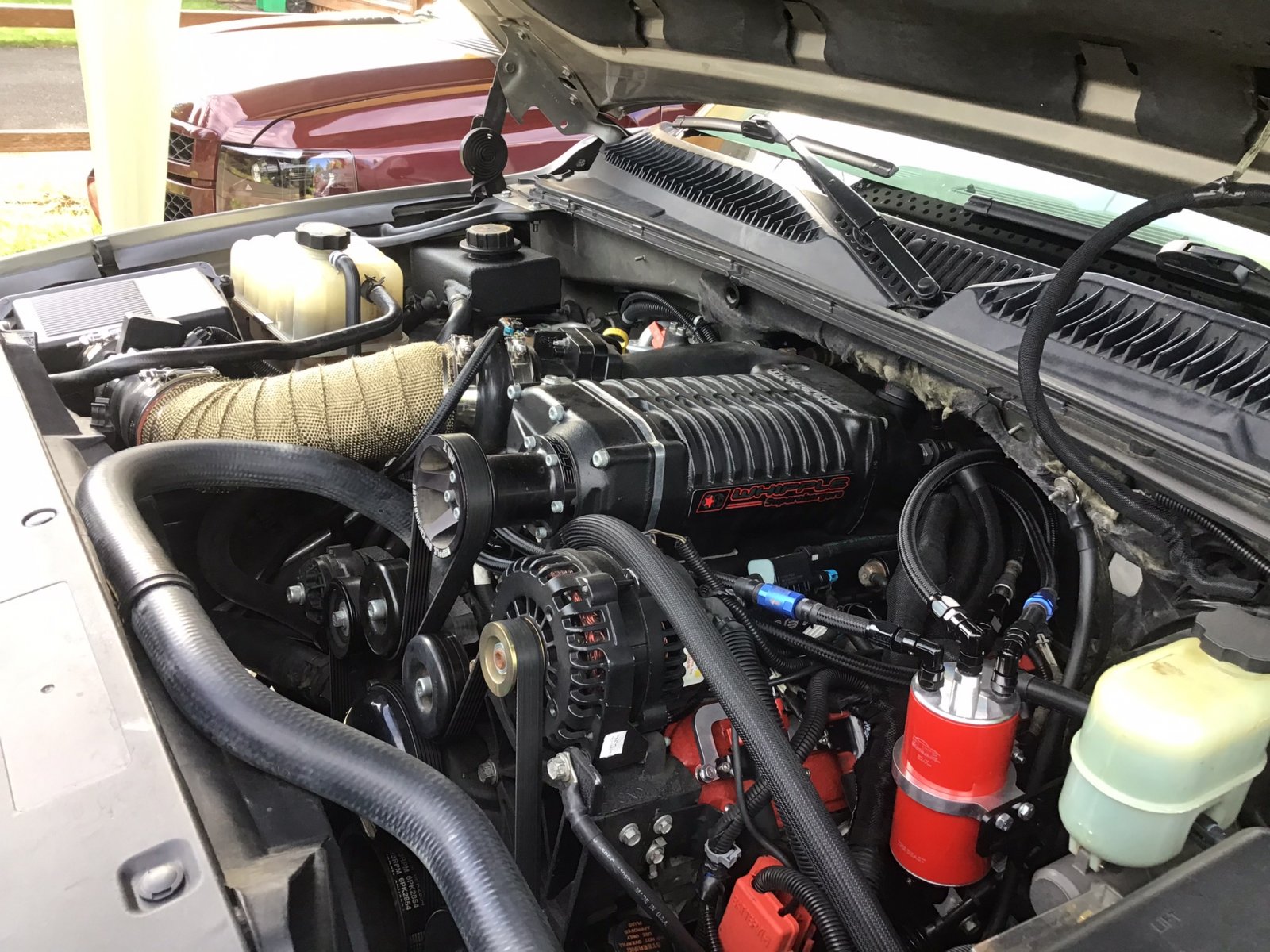

Plus blowers look and sound cool. ;)

Plus blowers look and sound cool. ;)View attachment 365441
Blowers 10000% sound/are awesome. I love whine in all forms. Previous vehicle I did solid mounts for motor and trans plus solid shifter bushings. Nvh was thru the roof but it was straight rally car and throw bearing sounded like marble in a blender. I loved it. The wife did not.
