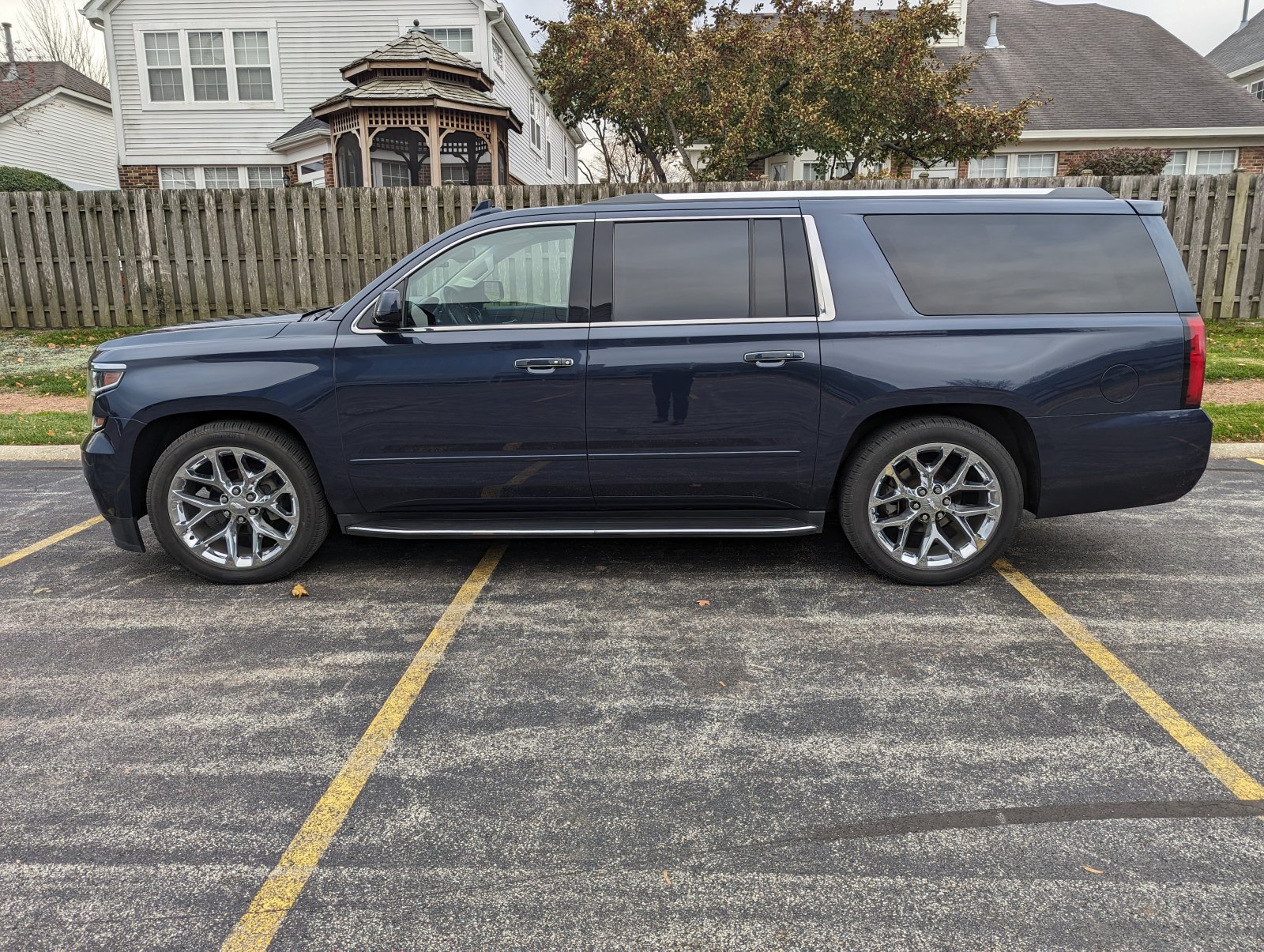

2018 Suburban Premier Lowered with Belltech 1019 Kit, . Kit claims 2"/3" but in reality it is about 1" in the front and 2" in the rear. I'm happy how it turned out.
DF 35-5/8" --> 34-1/2"
PF 35-1/2"--> 34-1/2"
DR 37-5/8" --> 35-3/4"
PR 37-3/4" --> 35-1/2"
If you just want to lower the rear 2" use the https://www.belltech.com/products/b...or-3-quot-lowered-rear-ride-height-23301.html.
