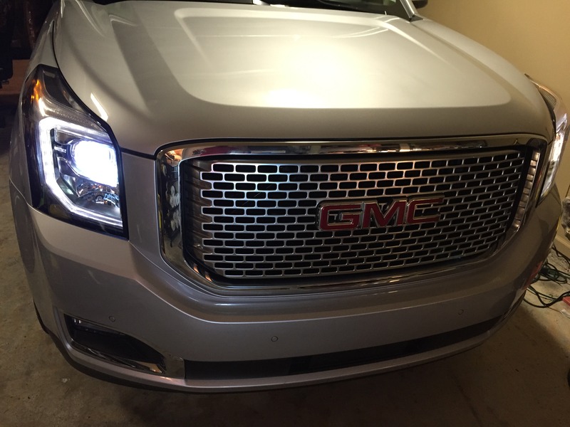

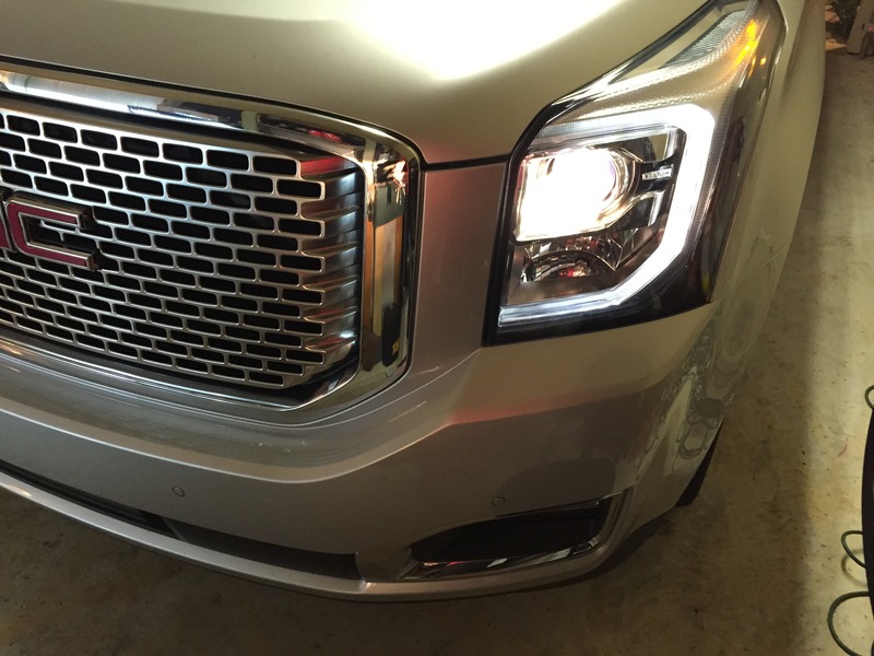

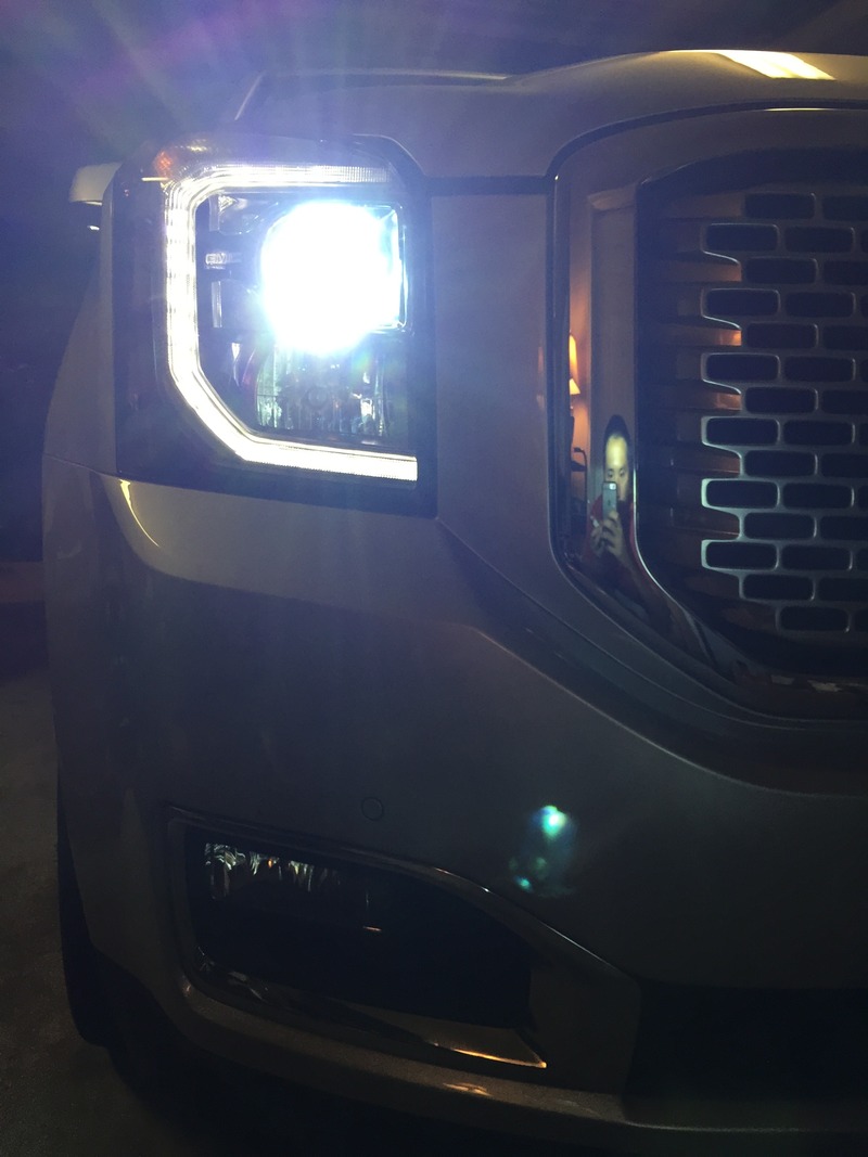

So aggravated. Friend helped me put kit in. Everything works before we put passenger side MAF back on. Once everything is zip tied and Intake reconnected ******* driver side light goes out. FML!!!! Here is a pic of the one side that works and a comparison between halogen driver side and HID passenger side:
---------- Post added at 10:42 AM ---------- Previous post was at 10:42 AM ----------
Not sure if it's ballast or bulb...

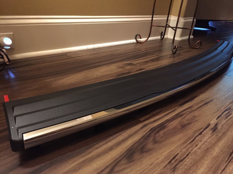

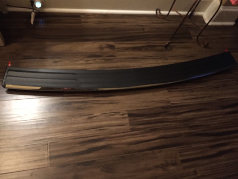

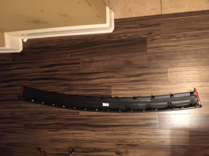

Step pad with chrome trim from 15+ Denali's. Looks to be a little under 5" in width. Which is the same as my step pad. So it SHOULD fit. Gonna try and get this done tonight along with the Philips LED reverse lights.

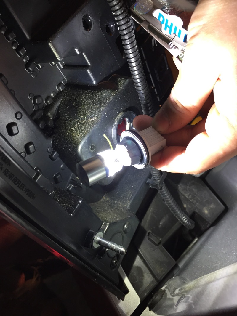

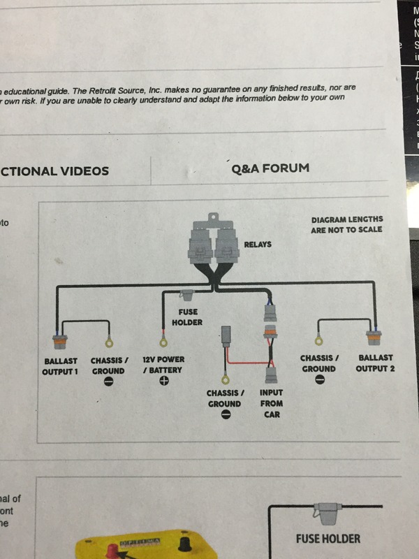

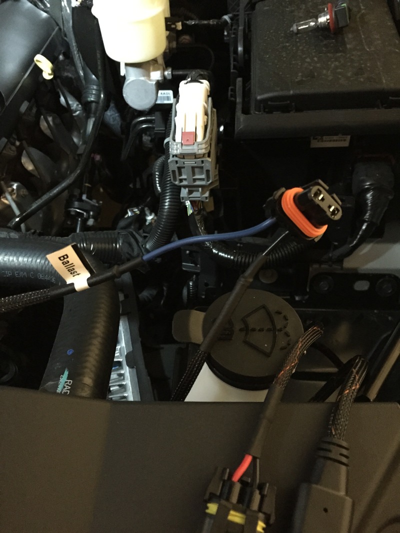

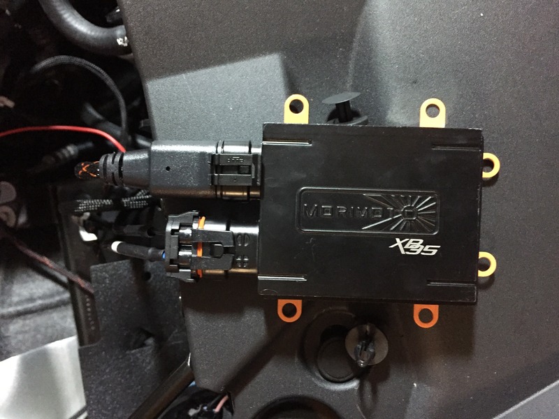

This damn Morimoto kit is pissing me off. If I unhook the relay to the drivers side it works when hitting the unlock button on the key fob but once you turn it on it starts flickering. If I hook up the relay according to the diagram, it doesn't turn on at ALL on the drivers side. I've tested the ballast, bulb, and individual wiring both on passenger side and it ALL WORKS. SO confused. If anyone has any ideas let me know here's some pics of when I got it to work. Reverse lights and chrome trim with new Denali step pad is also on.
Driver side with HD Relay not hooked up (only way to even get it to function, but flickers when car is actually running). Capacitor was hooked up to both sides (which is supposed to prevent flickering so so much for that...
New step pad and chrome trim from '15 Denali's:
New Philips LED reverse lights:
Only time it actually works to show all ballasts and bulbs DO Work. Passenger side is using HD Relay, Driver side isn't... so jacked up:
Video of the flickering once the car is on with it hooked up this way... I hooked it up like it is in the diagram above and the driver side doesn't work at all. Help... someone?!
