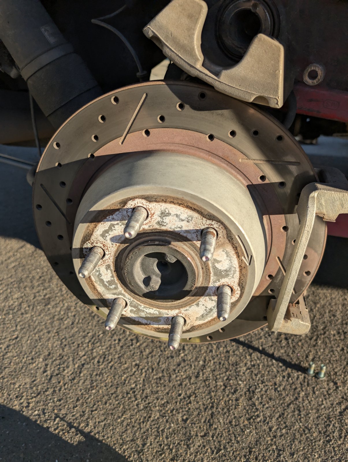

I was going to say if you had drilled & slotted rotors the discs clean themselves. Then I see this …
Proof is in the pudding. Slap those new pads on and apply the supplied grease to the backside and ears of the pads.
