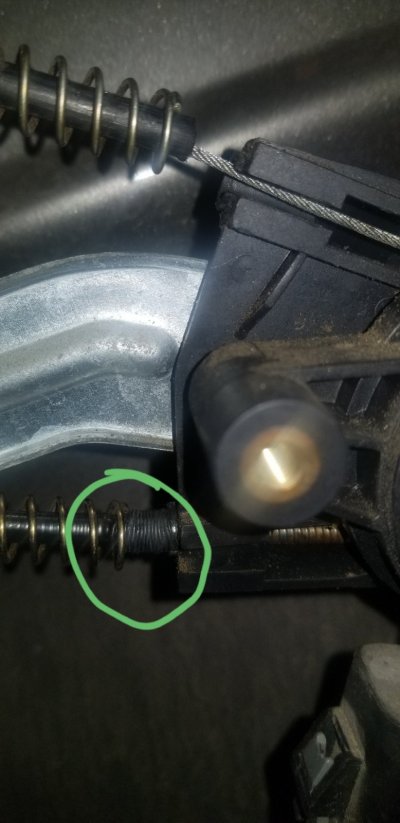

I got it to go all the way down by messing with the top cable. It wont go up though without pulling on the glass. I pulled the motor and it seems strong. I couldn't stop it with my kung fu grip. The area I circled seems to be the problem.

Some things to consider:
1) lubricate the window
2) check your grounds
3) test the power getting to the window motor.
20 year old motos can really be hamstrung by such things.
