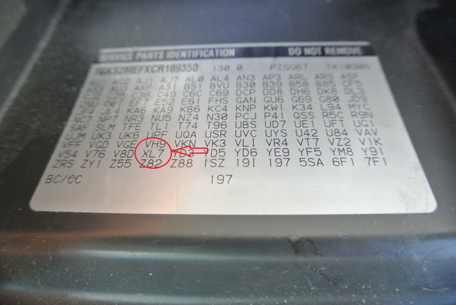

you could take the sensors out of your old wheels and put them in the new wheels, OR check your glove box for rpo code: Option XL7 is the 315 MHz system, option XL8 is the 433 MHz system
once you know if yours is 315mhz or 433mhz you can then order some sensors off of ebay or amazon.
on a side note are you sure that the previous owner removed the sensors? if there still in there it's a 50/50 chance that you could just do a relearn

I have XL7 rpo on my 2012 and it was also listed on my 2011

Well, while you have the RPO codes for one or the other the matching process is like the older ones. Set the parking brake, turn the key on, press the lock and unlock buttons on the remote at the same time until the horn chirps. The parking light on the LF will light up, empty that tire's air until the horn chirps. Then move on the RF, RR and LR. When the last tire is matched the horn will chirp twice. You have two minutes to match the first and 5 total to match them all.
Make sure there are no other remotes from that truck or other GM cars around, and no other GM cars parked nearby when you do this.
