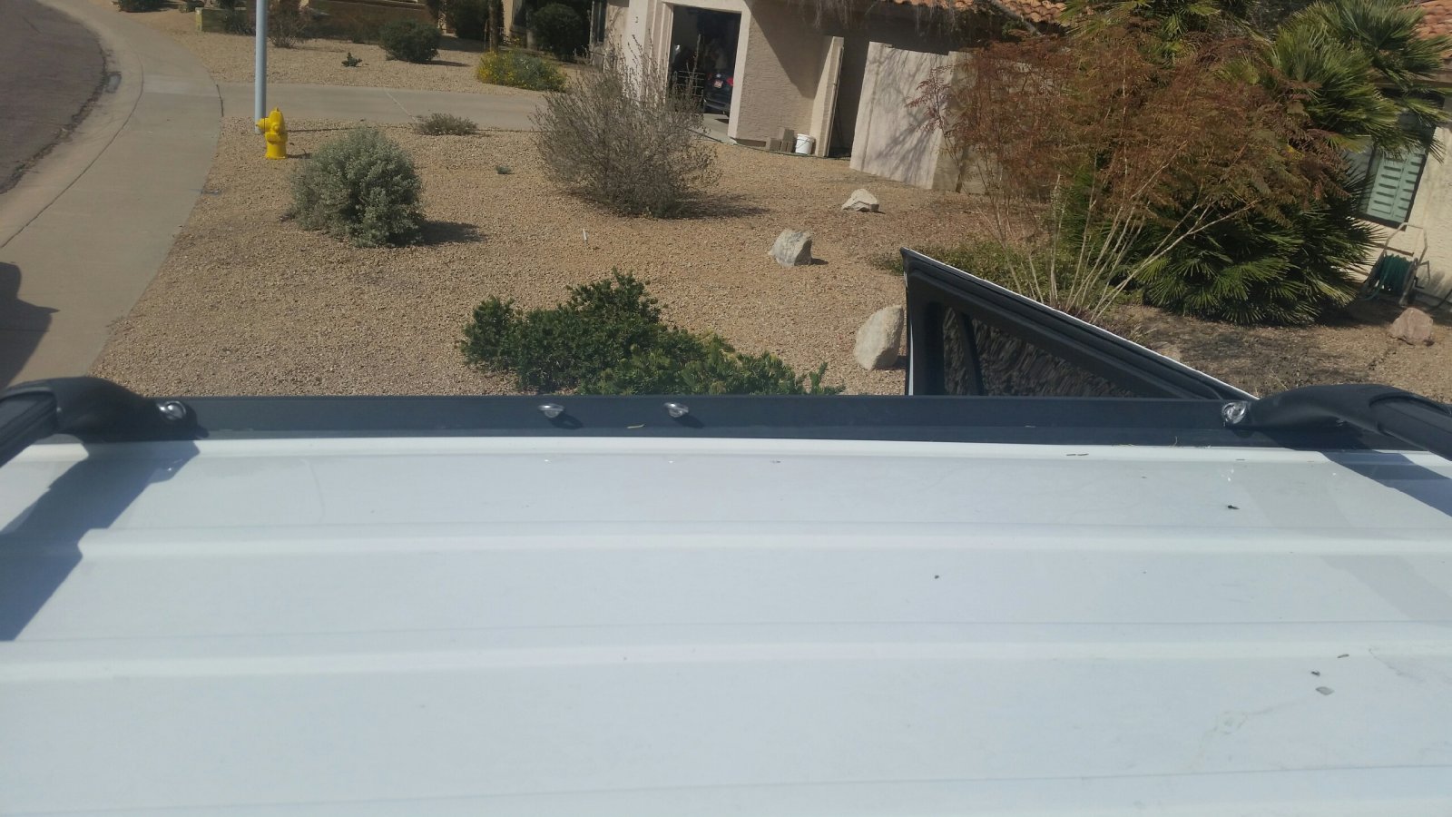

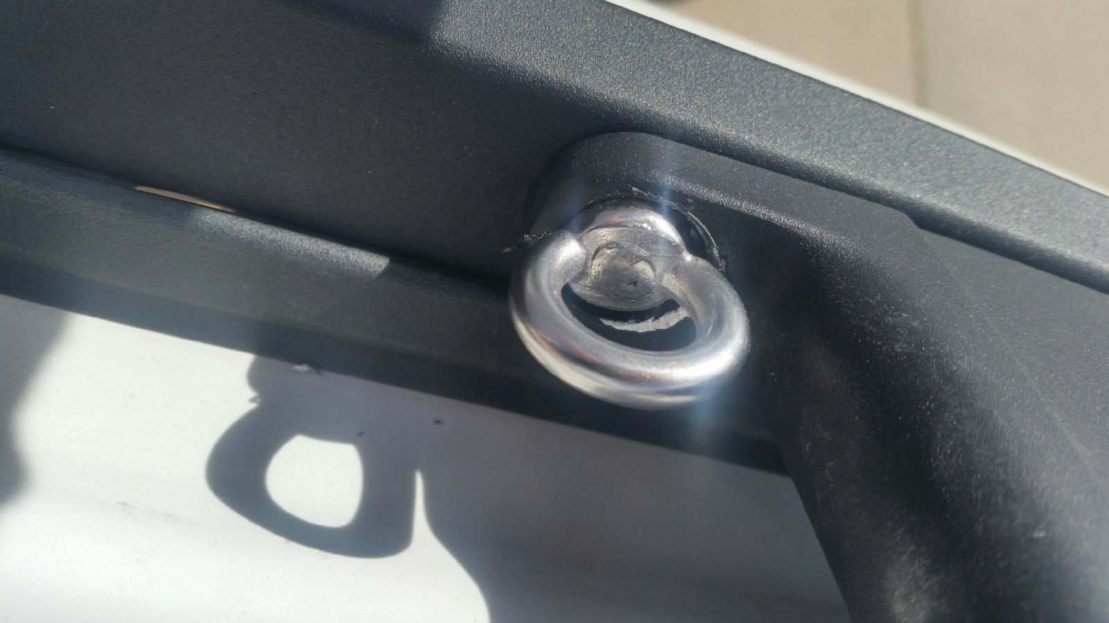

Not sure what the nimrods at GM were thinking offering ZERO opportunities for a tiedown anchor on these racks. I understand that they are moving these trucks to more-and-more of a mall-crusier model, but damn! Surprised the GM Nav is not pre-programmed with all shopping centers.
Anyway... After searching my industrial supply catalogs I came up with these, which will have to do.
304 Stainless, M6 x 1 is the thread, ring I.D. is 17mm, thread length is 25mm. I could have ground/filed the shoulder of the ring-bolt shoulder to eliminate interference with the crossbar bolt hole, but it is very slight.
View attachment 240305 View attachment 240304
Did you fab these or are they over the counter?

How sturdy are the mounting holes on the rails? I wouldn't get grazy with a rachet strap but are they solid enough to use as tie down points? I planned on hauling a couple inflatable paddleboards and was thinking of just setting rhem on the roof and running a couple straps across them using eye bots in the rails. Then i wouldn't need the cross bars.

I put stuff like an ez-up and storage totes with a 2" ratchet strap without an issue. Threads are fine thread, eyebolts are bomber, so I guess it comes down to how good is the GM casting. (Hopefully better than their condensers).

They are available ready-made. These should work >> https://www.parts-express.com/stainless-steel-eye-bolt-m6-x-25-mm-3-pcs-eyebolt--243-260 L
Likely you may/could find them someplace cheaper, but parts-express is the first one I found when I went looking.
I just ordered them, thanks again Kurt.
