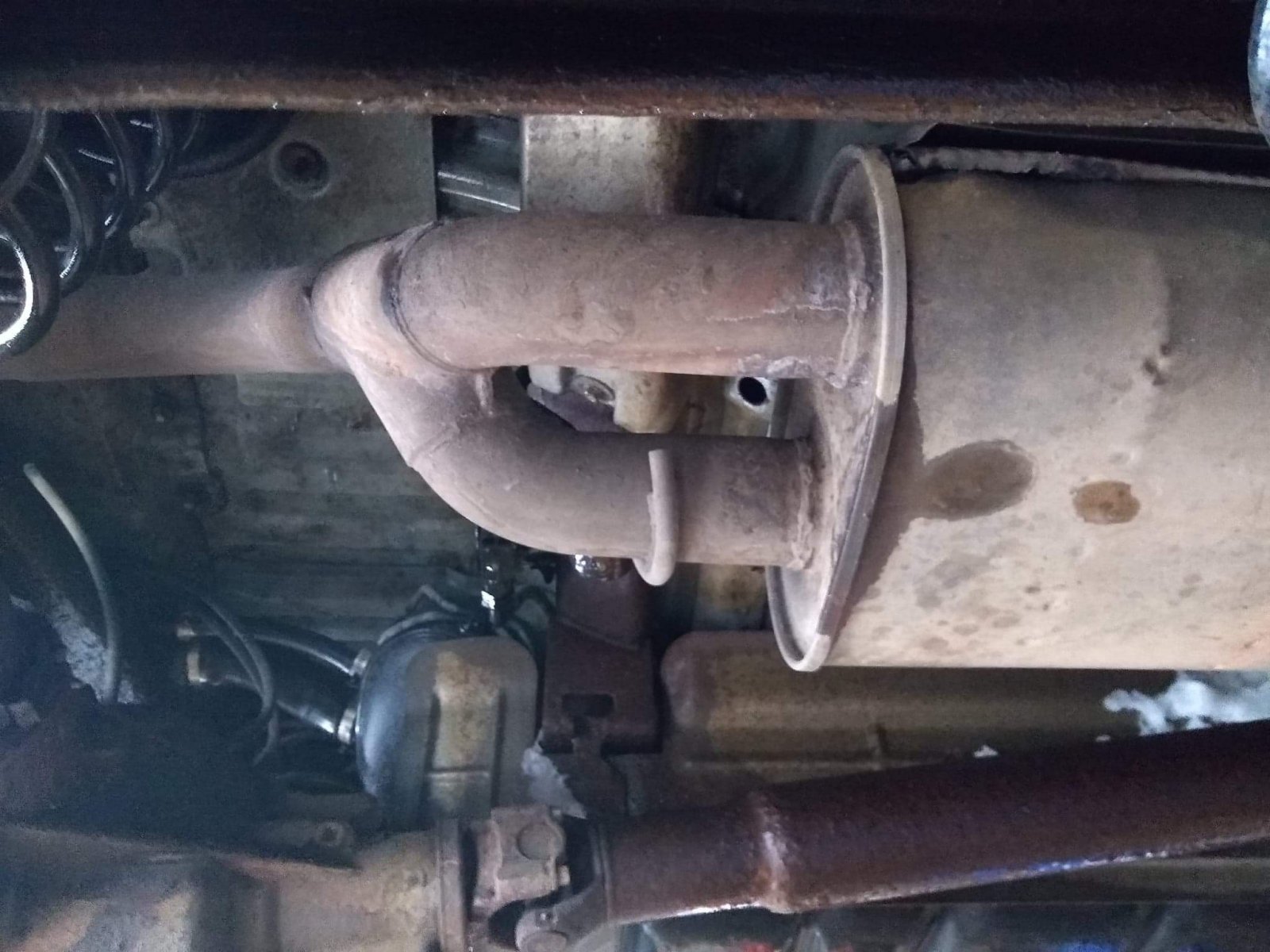

I can slide under my suburban in a couple days if needed.
Seems like it is 3 1/2" it comes two pipes into the muffler, and two out then a"y" into one for the tailpipe.

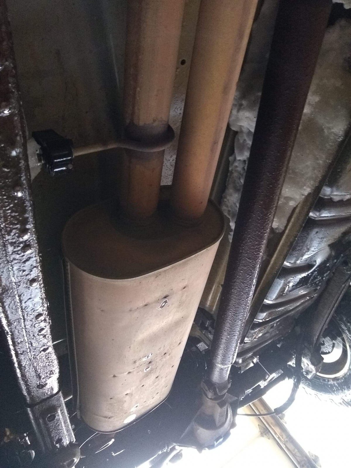

This is what the oem muffler looks like on both ( this one specifically is our Denali. A tape measure or calipers would tell the size of the stock pipe easy enough, ( pretty sure the Denali was 3" and the 8.1 3 1/2., Would be minimum of this Evening that I could find out. )

This is what is on the Denali now, my avalanche had an actual dual in muffler , but the exit looked basically the same as hers.

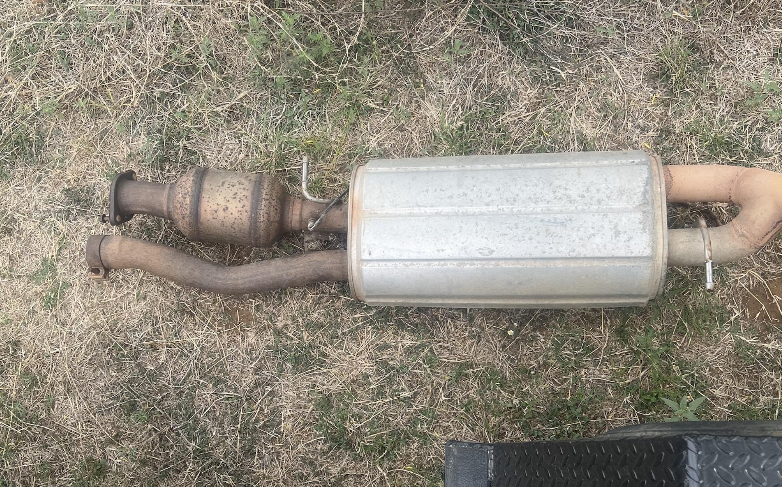

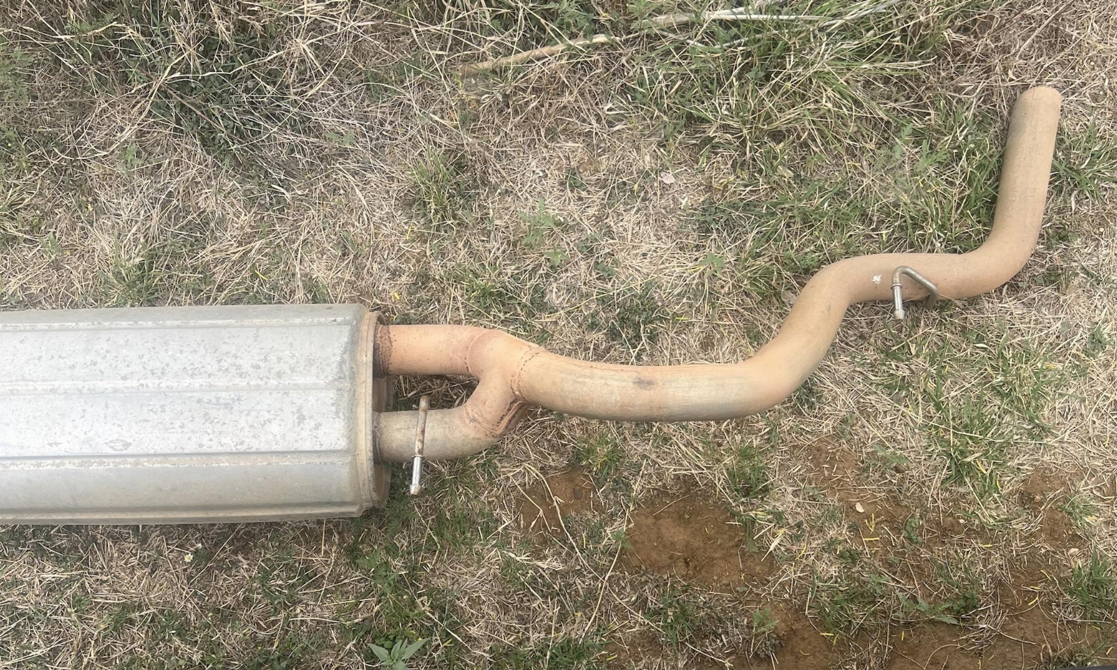

View attachment 368141View attachment 368142
That is what came in my 8.1 Burb. The inlets are necked down to under 3”OD. The exits are 3” OD. The tailpipe exit is 3” OD as well.
The muffler is 25” long X 12” wide.
Excellent! This is what I needed to see. Now we know what to look for since we can't trust what's listed in online specs.
