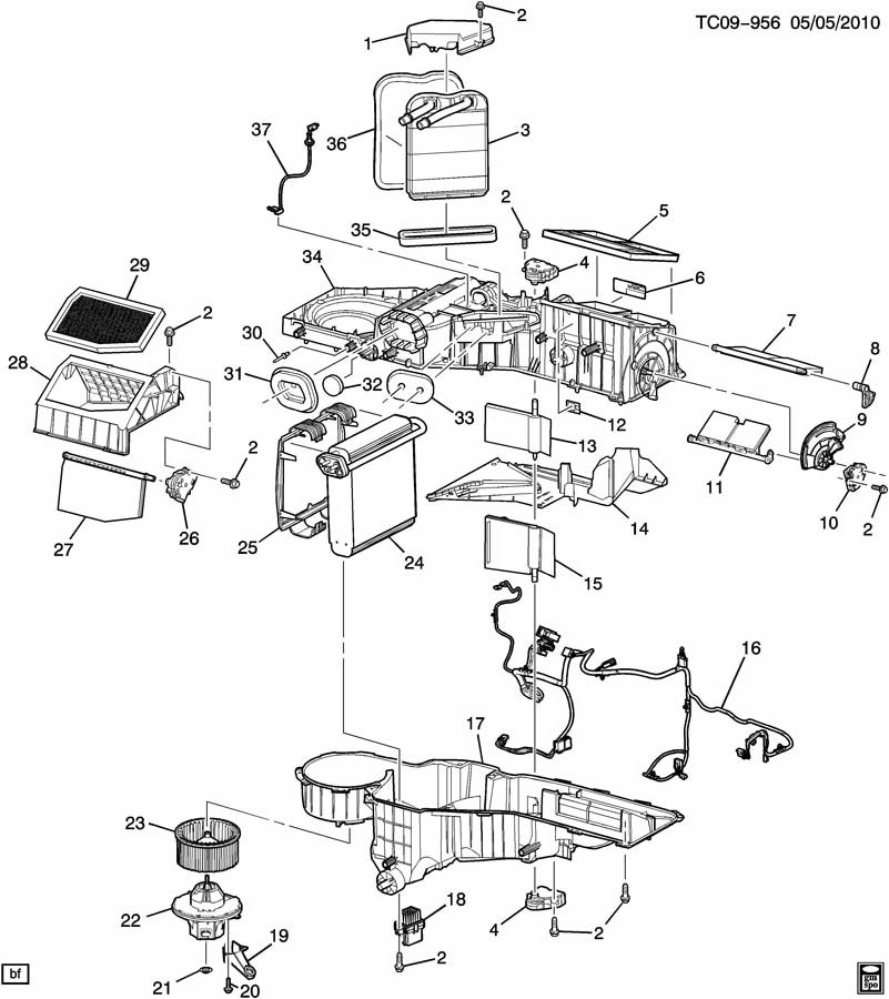

Looks like if you had it it is on top of the airbox or just inside with the heater core, #37 in the drawing.

I was looking at that diagram too, and follow steps from a member on here, definitely no sensor that at all
