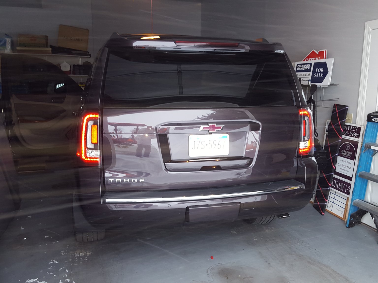

I went with the aftermarket light smoke Eagle Eye Yukon Tail lights for my Tahoe ...very bright and work well

Here ya go...best pics i can do in the snow storm

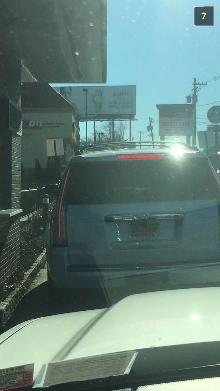

Anyone any one have this problem this is what two pairs of the vland tail lights look like when the brake is applied when it is sunny out look how the third brake light is much brighter any ideas I really like the look of these lights but this is not safe and like I said I have two Yukons with these lights on them View attachment 58444

I don't think you need to compare with another car
You can tell by this video that these 'brake' lights are pretty dim on his, too

Thats right but under direct sunlight most lights are the sane. We need a comparison to a normal car.
I can tell its definately dimmer than original escalade lights
