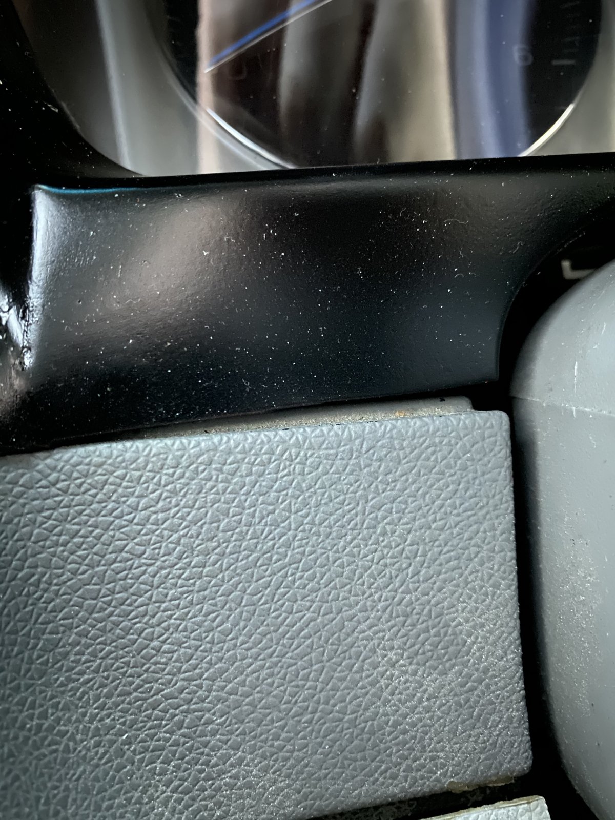

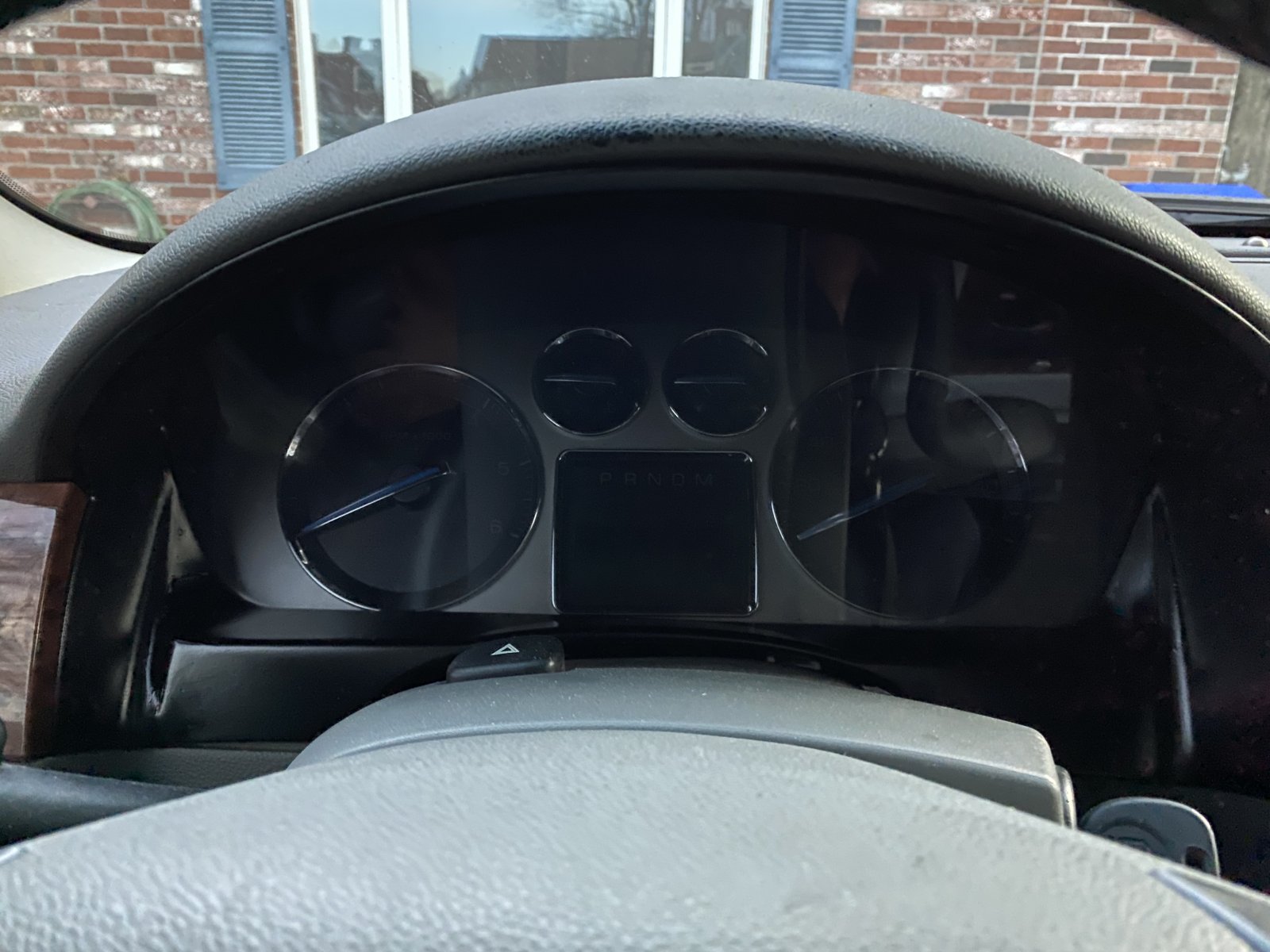

still waiting on the harness but wanted to get the cluster and bezel thrown in to see how it looks. Bottom picture shows the one flaw. Cut the bottom where it meets the dash too short on one side. No biggie since it’ll rarely be seen

Yep, it’s PIA to get them perfect. Now you see why it took me a couple tries.
I’m not a big fan of the seen so I might try to do something about that. I used a satin black but it came out glossy
The best paint for the black interiors, and it matches perfect, is Krylon Fusion flat black. You can’t tell which parts I painted with it and which are factory.
damn it. I used krylon fusion satin black. Figured

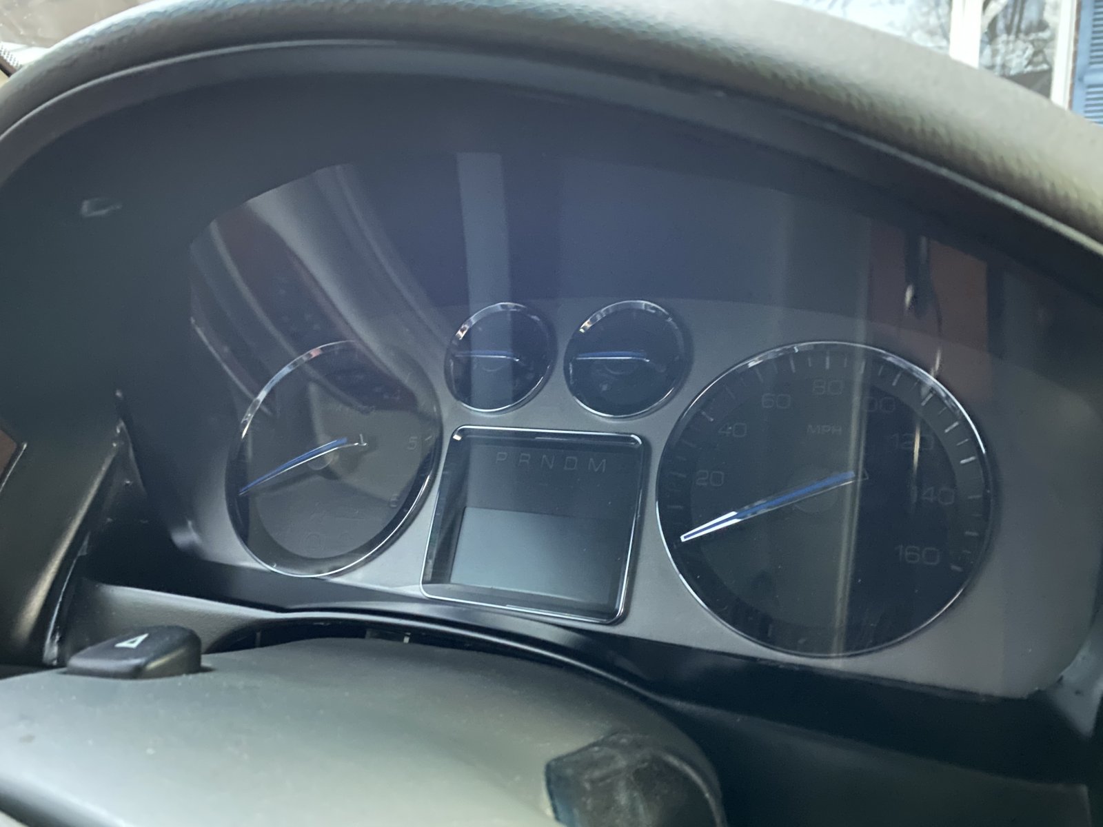

So an unanswered question to me i can see everything else working, so does the cluster display the Digital Speed as well?? Because that'd be the only reason i'd consider jumping down this rabbit hole would be if that worked since id really like to have a digital speedo
Yes it does, the only thing you really lose is oil change life... If you get a KPH one from out of the country, you can also change it to MPH in the settings and then you get a 200mph speedo as well, not that I would ever need such a thing ;-)
Yes. You can toggle through the DIC buttons until that is displayed, and then leave it like that. It’s handy for radar traps.
