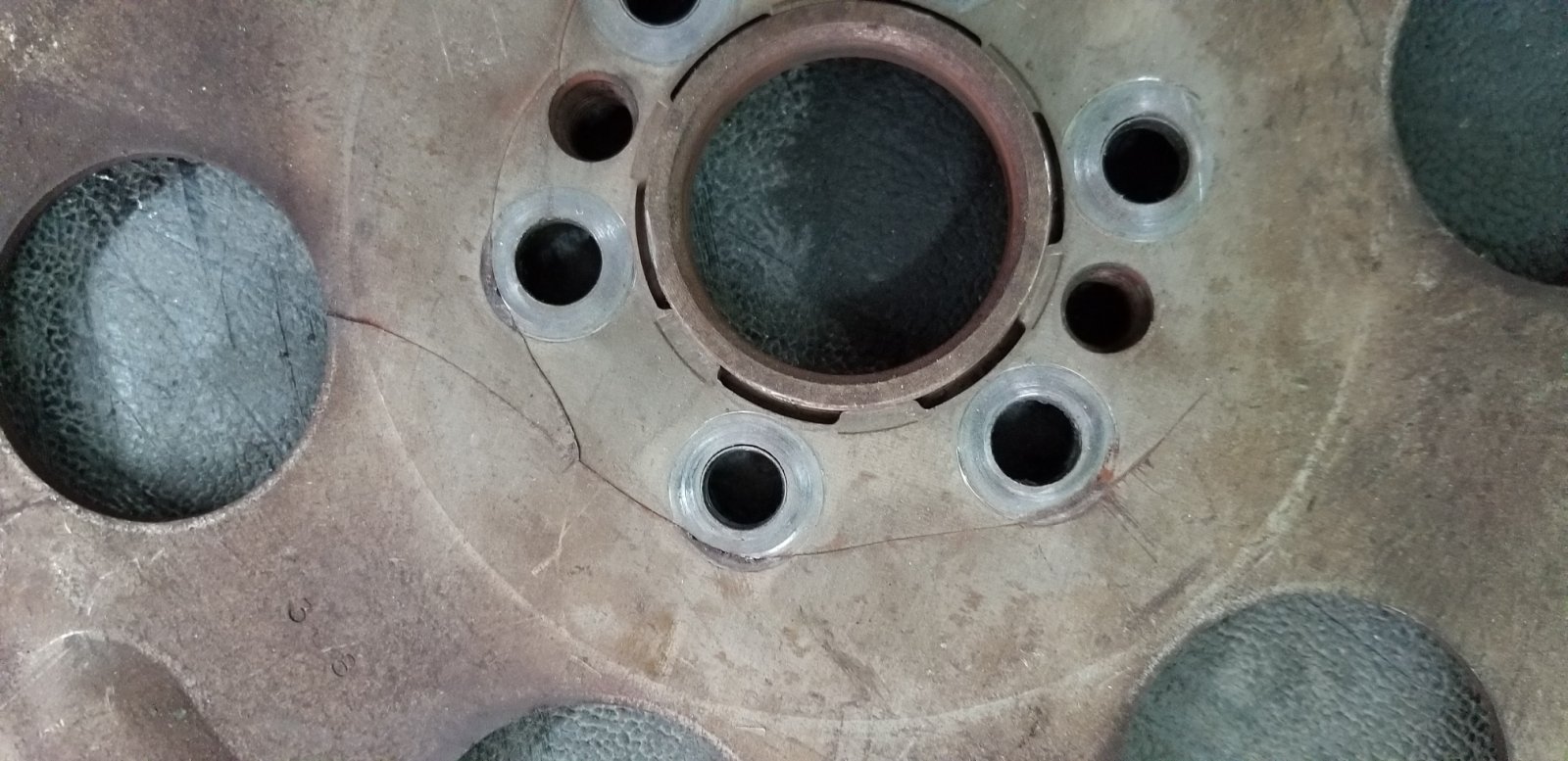

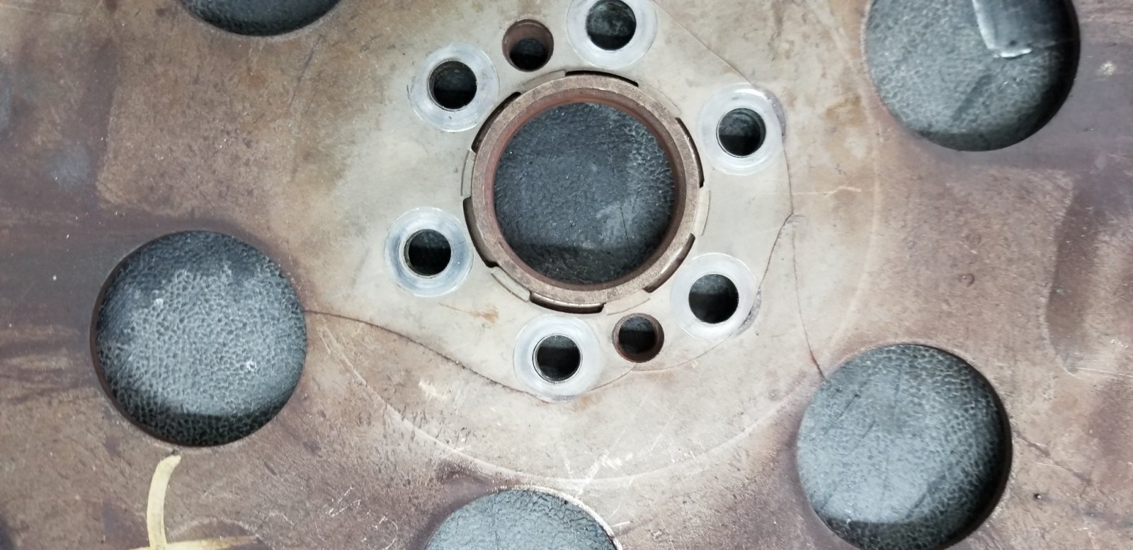

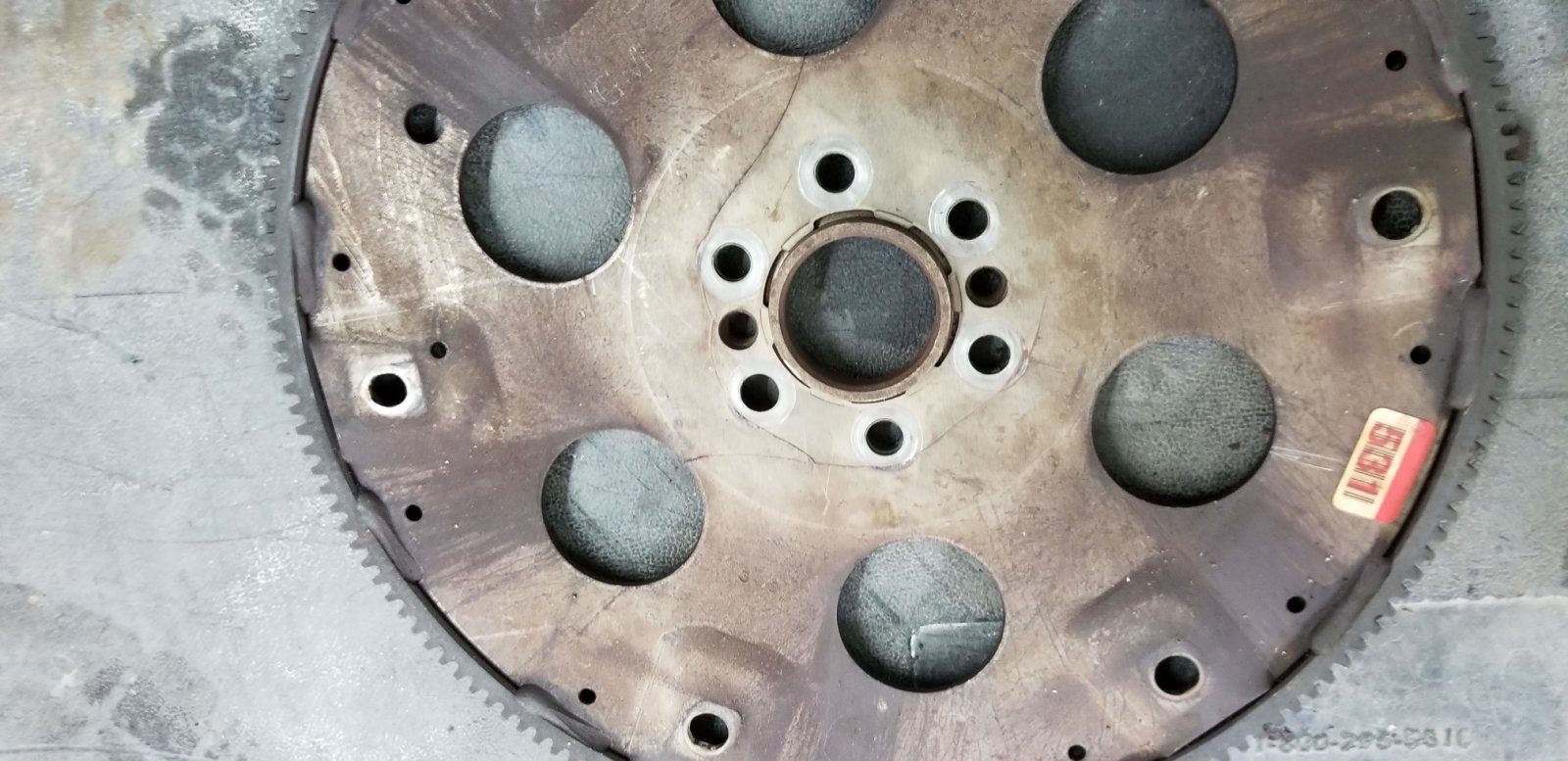

This is more of a Hail Mary check, but get a good flashlight and check the flexplate for cracks.
Neutral/park/drive. Anytime it gets to around 3k, below that nothing. did some closer listening, it doesn't really sound like a lifter tick. I'm gonna have someone rev while I listen tomorrow, maybe get a closer listen and see where it's coming from.

Hope it isn't the flexplate. Happened to my Express van with the 4.8. Was a metallic sound. Was cracked almost all the way around the bolt holes of the plate.

I'd check the flexplate and listen to the bottom end with a mechanic's stethoscope if the flexplate checks out.
Is there an easy way to check the flexplate, like using a borescope or something and looking through those inspection areas? I'd hate to pull the transmission if I don't need to yet. I'll pull the valve covers and check for a bad rocker this evening. Really appreciate all the input.
52,956
There’s an inspection plate, it looks like the bottom of a soda can. It’s on the bottom of the bell housing.
