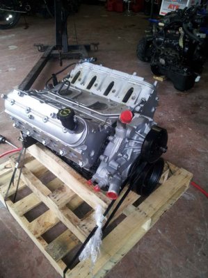

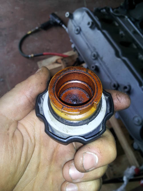

I recently swapped the old 186k for an "alleged" 44k mile engine that the salvage yard now has no available VIN record for. (This will be addressed via sworn complaint with the Wisconsin Dept. of Justice - Division of Criminal Investigation where the engine was shipped from.) There are several issues with the swap:

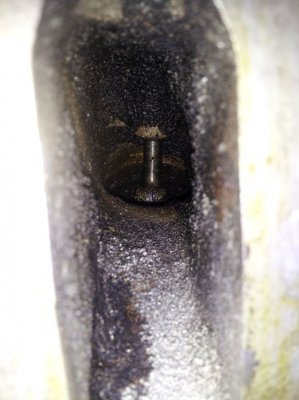

1.) There was more carbon build-up on the intake than there was on my 186k engine. (See photo of #2 intake valve.) The salvage yard declares that carbon build-up on the intake is from "cold weather." Apparently they are trying to say that cold air contains more dirt seeing as to how it's on the intake side.
2.) Following installation it spit carbon deposits out the exhaust that sounded lovely but was undoubtedly expected based upon the build up I had observed. I ran some fuel treatment through the system but now fear doing a top side cleaning.
3.) On the third start-up it had to turn over several times before ignition. The next time it started after 2 revolutions but initiated at 200rpm, went to 900rpm, back to about 350rpm, and then leveled off at ~530rpm. Now I have to assist ignition by depressing the accelerator. There is a bad shudder as well in addition to a tapping on the passenger side top half. The tapping began after about 40 miles....lifters or valve lash? (Thoughts?)
http://youtu.be/46Z2ttWkdSo
*In the video, I placed the camera on the truck so that the shudder could be observed.
4.) I replaced the IAC seeing as to how that was a possible issue before I swapped it from the old engine. The intake manifold gasket was replaced and has now been smoke tested. (Smoke does slightly come out the side of the throttle body where the spring is....normal?) Dealer computers showed a slight voltage irregularity with the MAF so I replaced that. The only other issue the dealership saw was a slight stick in the EGR so that was cleaned. There are no CELs or stored codes.
I'm getting HORRIBLE gas mileage and don't know where to go next. The dealer says $90 an hour to get into it in depth. To top it off, the salvage yard was advertising the same alleged 44k mile engine for sale weeks after my purchase and changed the description to a 64k mile engine after I questioned them on it. They claim it was due to my failure to clear cookies. Well, it was a new quote number and I was on a different computer that had never accessed their site. (I screen captured the new quote and saved the source code before talking to them.) Unfortunately I don't have the funds to be having this problem. Any suggestions on which component(s) to check would be extremely helpful and greatly appreciated. Input about the tapping would also be a plus.
Thanks.
*The TB shown below was not used

wow, where to start... first im sorry youve ran into these issues. im sure this project was a pain in ass but u toughed it out thinking the truck would be like new again.
1. carbon doesnt come from "dirty air".
2. i would run cleaner thru it like theres no tomorrow, you shouldnt hurt anything. i would take the t/b off and clean it by hand, but i would seafoam the rest of it.
3. how are all the other diagnostics? how oil pressure? fuel pressure? that does NOT sound like a lifter to me. that sounds like rotational contact of some kind. im really hoping it not inside the motor, but check anything that rotates. does it speed up with engine rpm? could be the fan slightly hitting the fan shroud(thinking positively).
4. the more i read, the sketchier the salvage yard seems that youve been dealing with. collect all the evidence you can such as that screen shot, just in case this doesnt get solved quickly and to your likings
