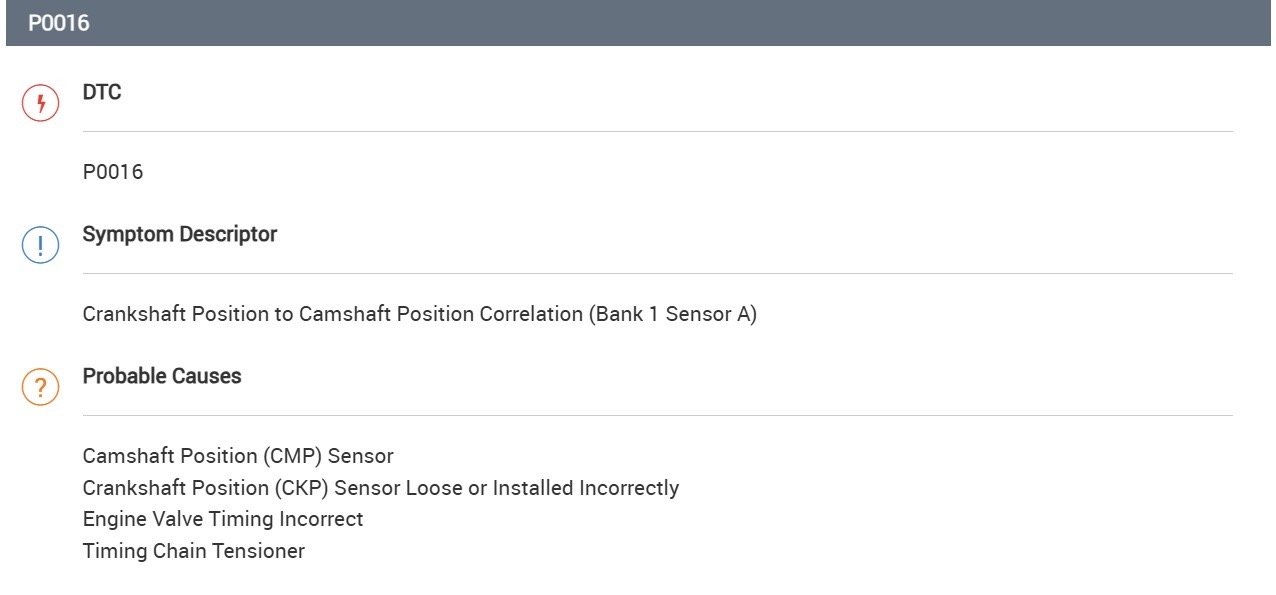

this morning car started up fine, this time after it’s got to operating temperature we stuck to just steering inputs and lo and behold car shuts off, and now finally it gave us an error code. See photo for more info.
For everyone saying dealership should be doing this. The dealership is garbage here. I have some off-road lights and a dc to dc charger installed and after the first non start I disconnected it all. The dealerships first action was to blame the lights even though it’s not connected. Secondly the dealership never worked on the car when it was in its non starting condition. The very first time I took it in the cold started it, saw a code for low battery and they changed a battery sensor, did no testing and released the car to me. 10 minutes later it died, I knew it was going to die cause a battery sensor does not make sense so I stayed close and on small roads cause I didn’t want the car to die on me on the freeway (Now imagine someone that has little to no knowledge about cars, they’d be driving on a major road car dies in traffic which could then cause serious harm to the operator.) This is after the service advisor told me that he is 100% sure the car is fixed.
When I suggested to them that it could be the fpcm he didn’t even know that such a part exists and he straight away dismissed me and didn’t even relay my message to the tech. The second time I took the car back in, same story the tested the car the evening before just before they shut, got it to stall and then parked it cause it was end of shift, and only the next morning did they try and diagnose it, again while cold starting and car running fine. They didn’t even try to ask what caused the car to stall, while the car is running fine they were gonna change the fuel pump. Didn’t make sense so I took the car back and gave it to an independent who works on my 16 Tahoe and that too very well.
Now waiting for parts to arrive to finally try and get this problem sorted. Will update you when I have further information
Thank you everyone for your inputs, very good to know the support and care this forum provides, even when dealerships let us down. <3

@sasso
thanks for the update. glad you have something concrete to work off of.
What is the plan--change cam and crank sensor?
This code makes sense that you would get a hard start after a shutdown.
I'm interested to see if this is also causing the steering input malfunction as well.

If the dealer is covering the crank sensor, then let them replace it since it triggered a code. But also undertand that the P0016 code is a bit funny, it is not necessarily indicative of a faulty crank or cam sensor. It could point to that, but it indicates the crank and cam sensor coorelation is more of a problem.
This could be more of an issue with a grounding, wiring or Voltage spiking issue.

Sooooooooo, replaced crank sensor, cleared codes car started.
And then proceeded to stall once load was applied. Literally 20ft of driving.
Gonna try what jfoj suggested next time it is running.

During this time, has a CASE relearn been done? It's quick and easy with a capable scanner, and will sync the cam and crank sensors so they know their relative positions. It's just something to rule out and should be done any time either sensor is changed (and if either sensor is suspected as the culprit).
