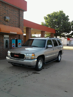

Hello there,
I'm new to this forum and not sure how to go about this but..I have an 03 gmc yukon I picked up a few months ago and haven't done to much it except replace the motor because I was being a dumbass and threw a rod.:emotions122:
The motor is a 5.3 with like 2500 miles on it haha and already has a mild cam in it, not a lopey one but you can feel the difference. Intake, muffler and some royal purple is about all i've done since then.
Anyways, I was wondering what performance mods I could do to make it quicker and benefit from it and what not, anything at all would be helpful..
Thanks:favorites37:
