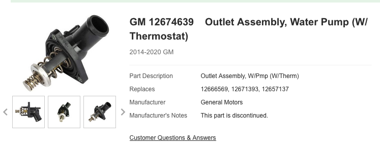

A month ago, the sensor went out again and figured while Im elbow deep in the engine bay, Ill replace the thermostat, again with some generic thermostat from Oriellys. Drove it probably 1500 miles before I noticed one day while driving to colorado that it was getting above 220. It would get to 225 but then go back down, just enough of a difference to move the needle on the guage. For the rest of that drive (300 miles) I logged the temps/speed/engine load on my phone. All was ok. Drove it back to Texas the next day, everything was fine the entire drive (1k miles).

Does anyone have any ideas? Im to the point where im thinking about running a 160 degree thermostat, as well as buying the GM temp sensor, but not sure. I wouldnt think its an air bubble in the cooling system, since it waited almost 1500 miles to show first signs, but then didnt do anything until roughly 3500 miles (after thermostat replacement)
