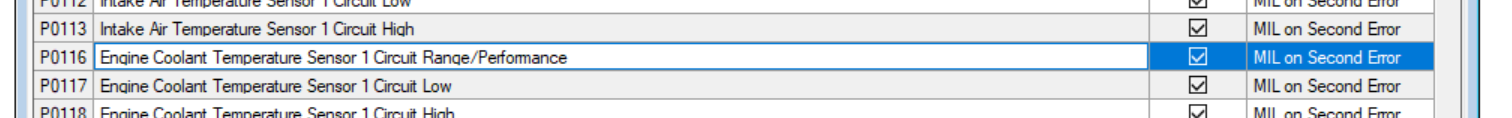

Please know that if you hook up your own custom block heater or have the factory one and cut off the special thermostatic plug, you will most likely get a Check Engine warning light. This applies to at least the 2007+ trucks. Lots of people have tried to “fix” the factory block heaters as they do not actually activate until it is below 0 degrees Fahrenheit; they would cut off the plug end and install another male plug thus force on the block heater even it was above zero degrees. Unfortunately this sets a trouble code. I read it has something to do with emission controls.

If you modded your block heater, or have aftermarket, you can turn off the DTC with tune.
