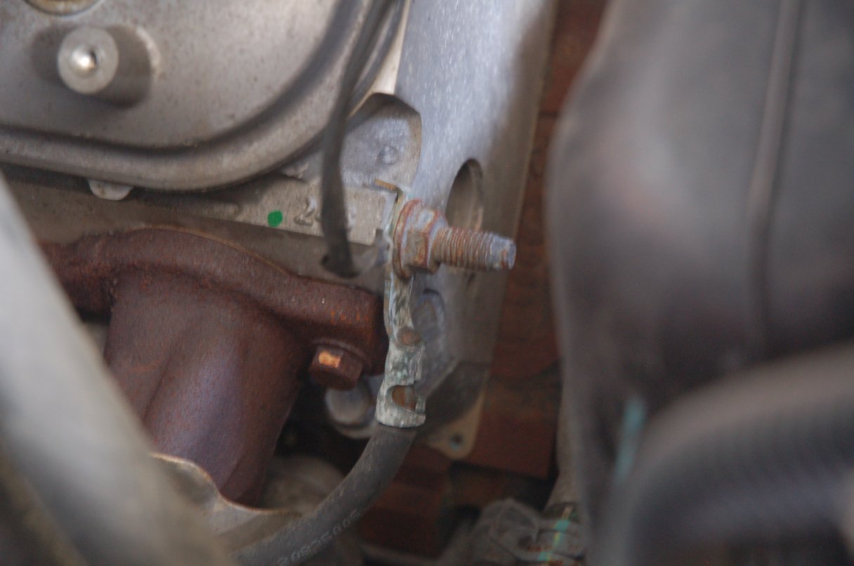

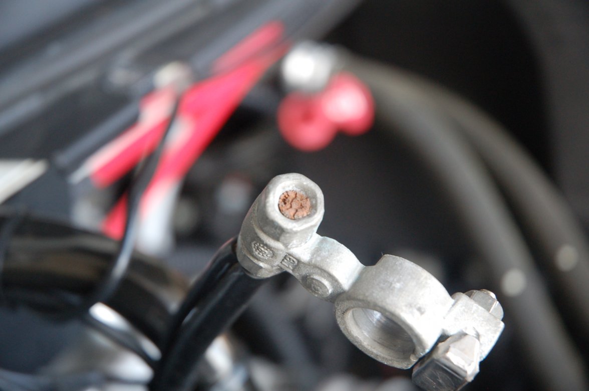

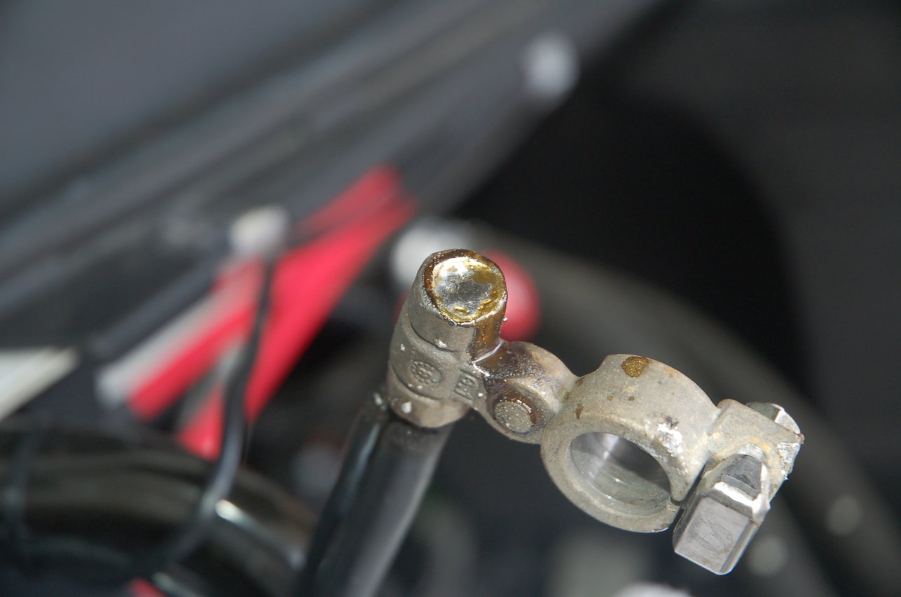

I had the same issue with my 2009 Tahoe Z66 PPV. I started looking at the battery cables. The negative battery cable if you would wiggle on it the lights would come on. So today I had some time to take a look at things. The negative battery cable has a poor connection due to a poor design, it looks like its crimped on.
So I took out the propane torch and some electrical rosin core solder and heated the terminal up and flowed solder in it and its now rock solid. The photo 305 shows the stock negative battery cable. Photo 306 shows the connection at the block. Note the corrosion. Photo 308 shows the soldered battery terminal. Make sure you use rosin core solder for electrical work for this and not plumbing solder. As plumbing solder is called acid core solder. If you can get some rosin flux to put on before you solder the connection that will make a better connection
