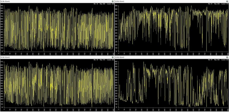

I want to say Delco parts. I have replaced them a few months ago and no longer have the boxes for them. I bought the cap and rotor at NAPA, my sensors at AutoZone. The cats I have gutted and I’m only getting the p0430 and not p0420. That seems weird to me, I figured they would through the code for both post cat banks. Yup 10 PSI drop on each, I have not done the injector coil voltage test as I don’t have the adapter to test it with this scanner. I will need to look through again to make sure I need an adapter.
I will post some saved data later but it’s of a cold system not warmed up to operating temp.

When clicked on image can be looked at a little easier.

420 and 430 are for both cats and the readings look normal for a gutted system. I would put new ones in there. until then your fuel trim will suffer. not to mention among other things it is illegal.
