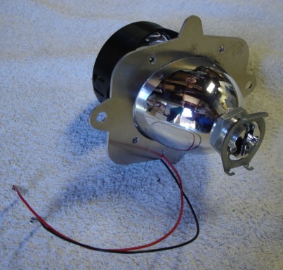

Everybody knows HID performs the best with HID housing, but taking too much work to retrofit is not worth to me. That's why I have been wandering for years to find an easier solution. Finally, the solution is here, the unloved OE headlights must go.
The solution is nothing more than bolt on, plus some silicon. No baking, no Dremel. Denali headlights and Morimoto Mini H1 are employed, check here for details in ********.com/f63/how-morimoto-mini-h1-denali-retrofit-2606.html *
The adapters that make this easy solution happen are here:
********.com/f21/denali-morimoto-h1-hid-projector-retrofit-adapters-2434.html *
Here are my part list, costs including shipping/tax:
Denali headlights -- $252 from 1AAUTO (Eagle Eyes, 3 year warranty)
Morimoto Mini H1 -- $133 from The Retrofit Source
Adapters -- $42 from Nick ([email protected]), money order
4500 H1 HID kit -- $62 from DDM Tuning (not received yet)
Although the tutorial is for Mini H1 v4.1, the adapters seem no problem to fit v5.0 (Actually, I can't tell which version I got, TRS says they are v5.0)
All the parts came in within one week, except DDM HID, even they charged the most for shipping and are closest to me.
Since the Mini H1 is bi-xenon, 4 hi is a must have by-product. It will be a true 4 hi, not a 2 hi + 2 lo. There is an easy way to do it for 01 Yukon by grounding the yellow lines of low beams,

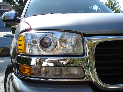

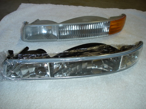

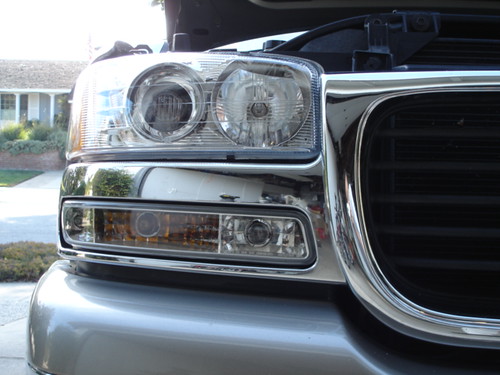

The Denali headlights have the same mounts, were put in within 5 minutes. Could be sooner if you can unplug/plug wire connectors faster.
The retrofit work has not started yet, the first thing is to test fitness of this Eagle Eyes set,
( I know, the bumper lights appear to be dated, new $25 clear ones are coming)
The light mounts are slightly off from vertical, that's why you can see from the pictures, the gaps between lights and grille bezel are not even. This cannot be adjusted by the bright metal sticks. For retrofitting, I have to re-assemble the mounts anyway. I think this can be taken care during the re-assembling ( Correction, I really need to bake them to disassemble the projectors from the lenses).
The Eagle Eyes material seems satisfied, so far no wiggling observed like some reports against Depo. The light output with regular 9005 is definitely better than my OE reflectors with PIAA 9006. The cut-off plates inside projectors make the focus reach 10 or so feet further without blinding upcoming traffic, a perfect low beam distance to me. However, the light output pattern seems not very even, comparing to my wife's Mazda HID, has room to improve. That's why the retrofit is on the road map. I will give them 3 or 4 stars if I review them in Amazon, because of these uneven gaps. If you just want Denali projectors without retrofit, look for something else.
