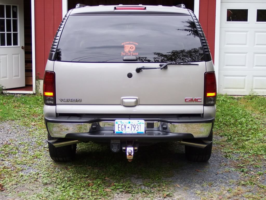

Unless you plan on throwing a high horsepower engine in your truck the stock exhaust is sufficient. For all that work you won`t really gain much if anything at all.
I had a custom dual side outlet catback for my yukon with three inch pipe from the Y pipe to the muffler and 2-1/2 inch tail pipes all in stainless steel for $800.

That looks bad ass! Was yours custom? If not where can I buy one?

It`s a custom job. I first tried a flowmaster catback with the same dual side outlet and i could never get the tailpipes to match the same angle and they were a lot lower than the ones in the picture and i didn`t like the way they looked. And it only lasted about three years before it rusted apart.
So rather than waste another $450 i went with the custom stainless job for $800 and it should last the life of the truck or more. And the tips are 3.5 inch slash cut SS about 18-22 inches.
If i can find a picture of the old setup i`ll post it.
That`s it with the ugly little bolt on tips that came with the catback.
And with similar to what i have now tips i had welded on.
