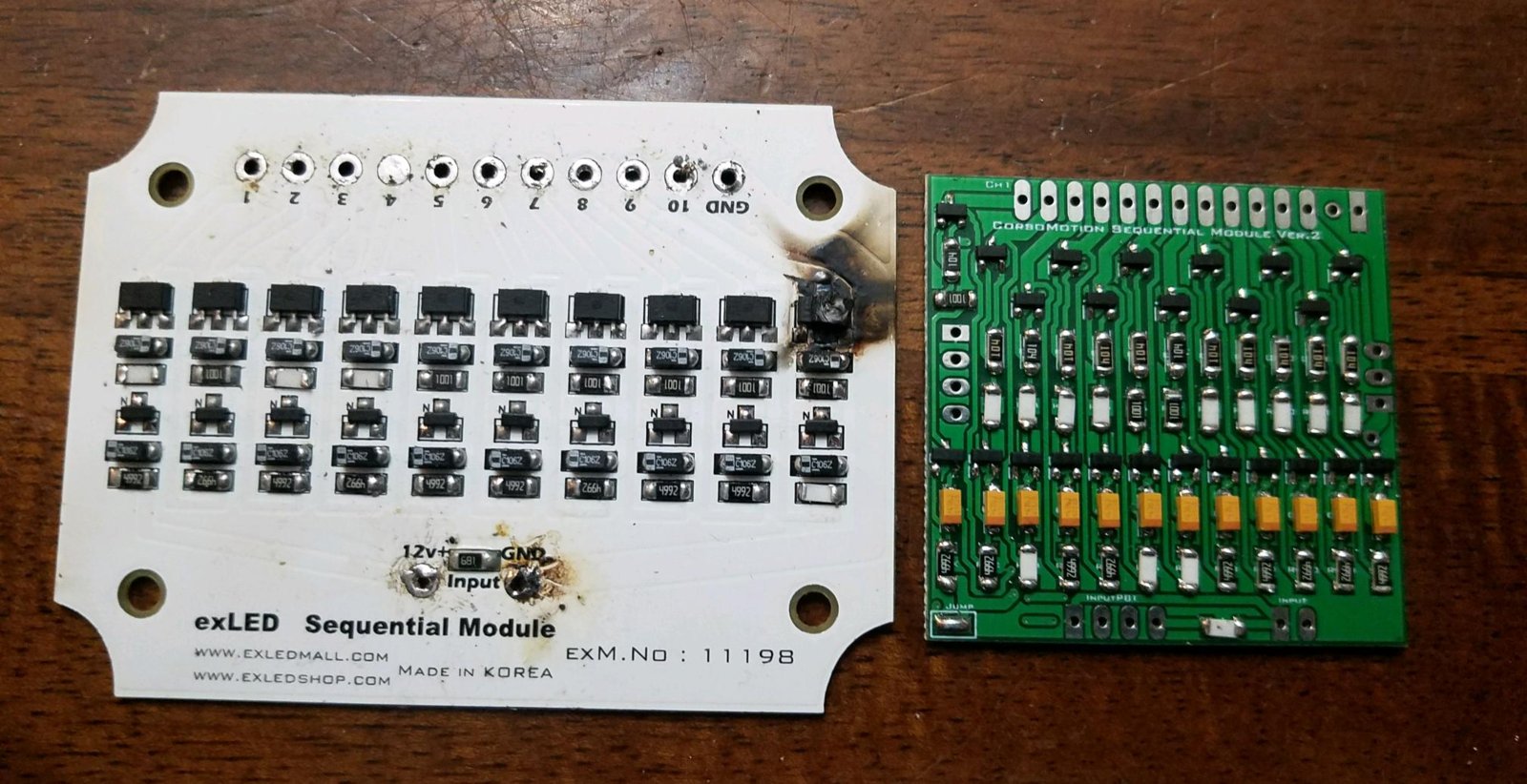

I have a spare set of the older 10 channel version of these....
https://corsomotion.com/collections...ntial-controller-module-10-channel-ver-1-each

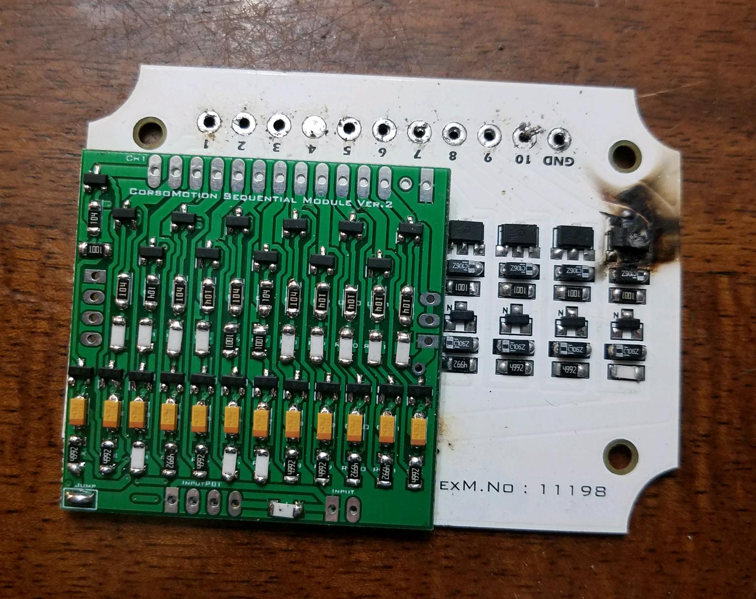

I had the 10 channel version on my Esky 3rd and burnt up the 10th channel so I upgraded to the 12 channel which has a higher amperage rating (.75A vs .5A)... still burnt the 10th channel on one side... need to open the Esky 3rd back up and figure out what is causing the extra amperage draw.
They keep each channel lit until the sequence resets.
That's exactly how I'd like it to function. It looks like I would just need two of the modules and 2 cases? Since I'd only be using 3 bulbs, I would just wire in channels 1,2,3? They don't have any install or descriptions on the page. Thanks for the lead!
kbuskill
Mar 11, 2017
5,822
9,833
NE. FL.
Yes.. 2 modules and 2 cases.
Just a heads up... the new modules are quite a bit smaller than the old ones and when I got the new versions they didn't have a case that was the correct size.
The new modules will fit inside the old cases but the cases are really to big for them.
As far as wiring them... you could use channel 1, 2, and 3 but the flashes will be very fast and the sequential effect (or rice effect if you prefer... lol) won't be as noticeable.
I will probably use channels 1, 5, and 9 to slow down the sequence a little.

What a big size difference. What are the dimensions of the case? Thanks again for the info.
I don't have them in front of me but they are roughly 3"x4"x1.5" thick.
