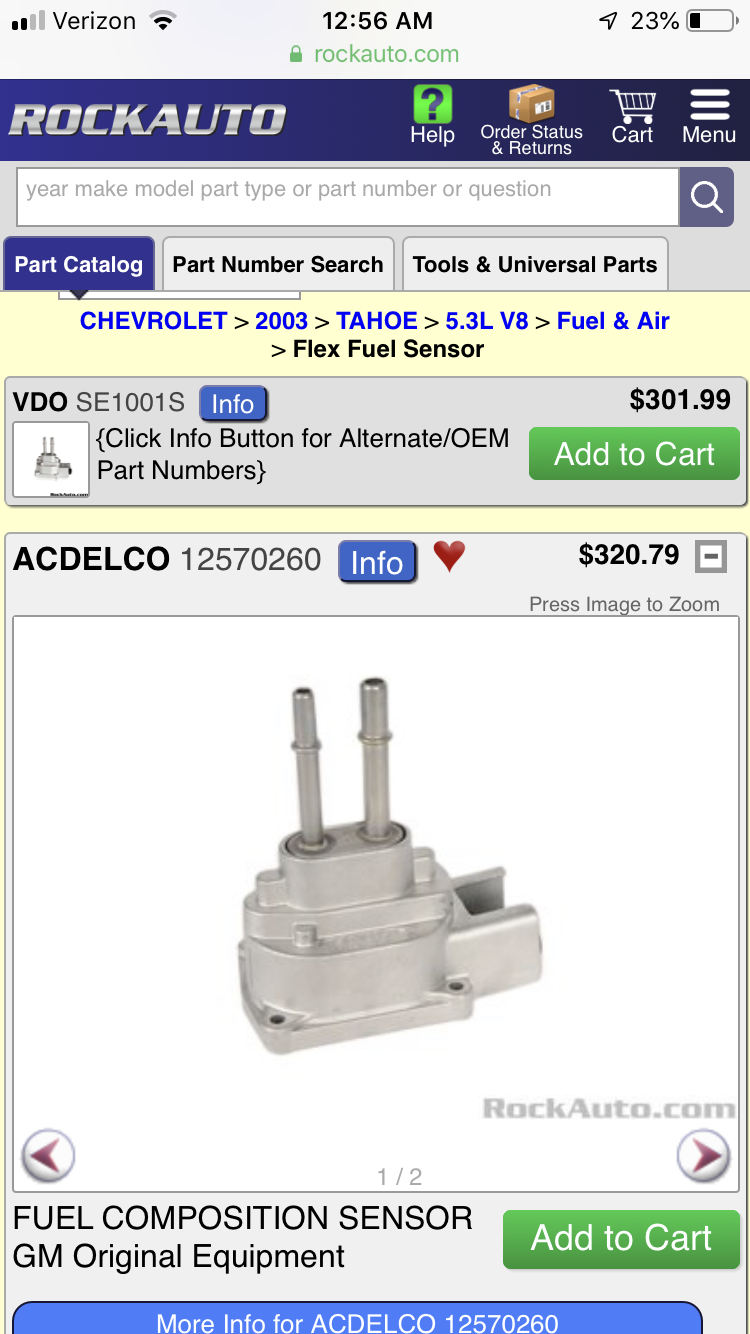

Ok took it in today and they said fuel consumption sensor P0178B and of course my knock sensor P0327B
not sure how to find the fuel sensor looked on Amazon wasn’t very successful.
wjburken
Dec 26, 2017
10,315
29,545
Eastern Iowa
I would look on Rockauto.
