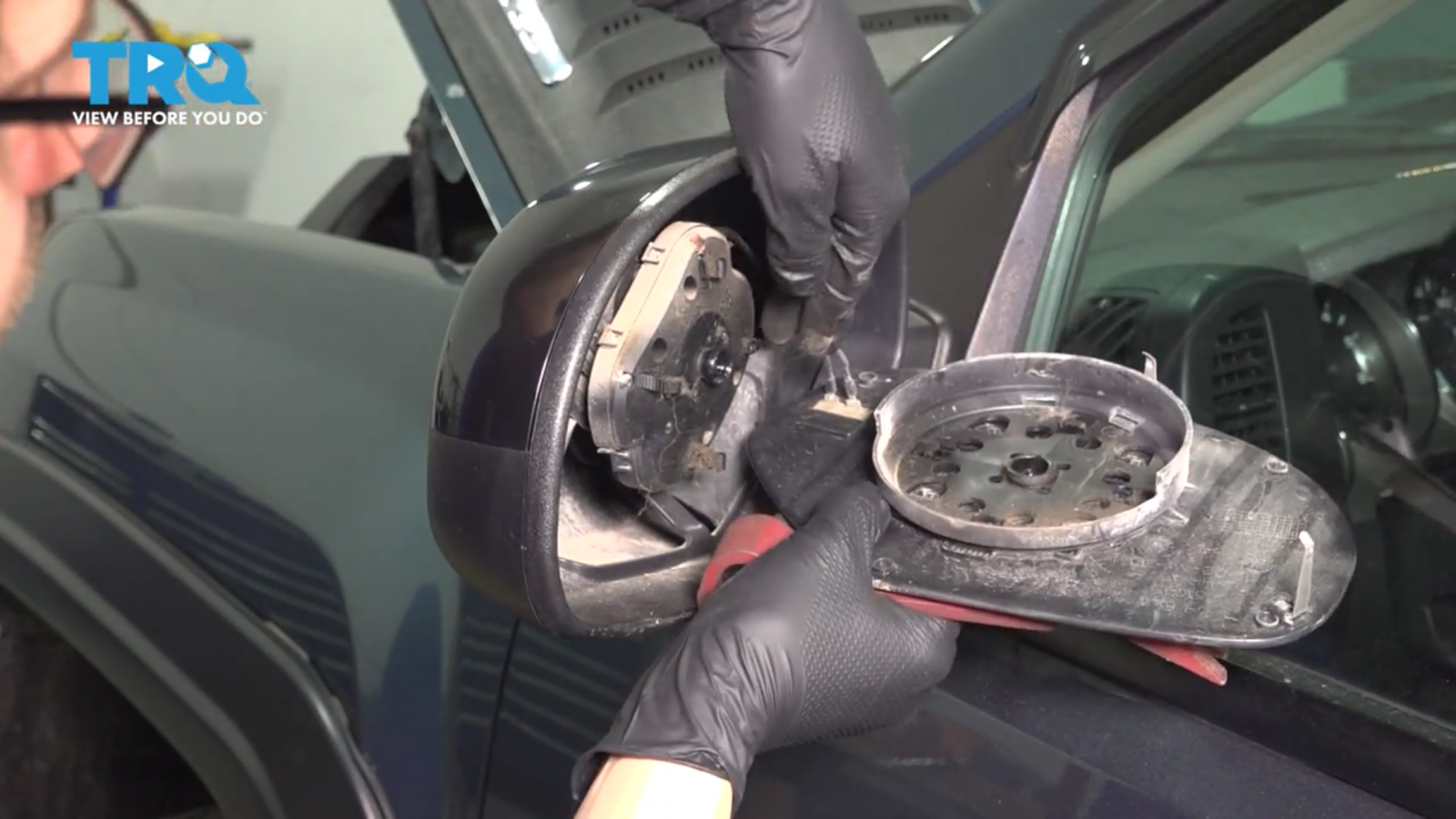

Thanks for that link and the video on removal!
The video I found had me prying the glass upwards to disengage the tabs, instead of outwards to remove mirror with mount. Will update if I get around to replacing just the mirror glass.

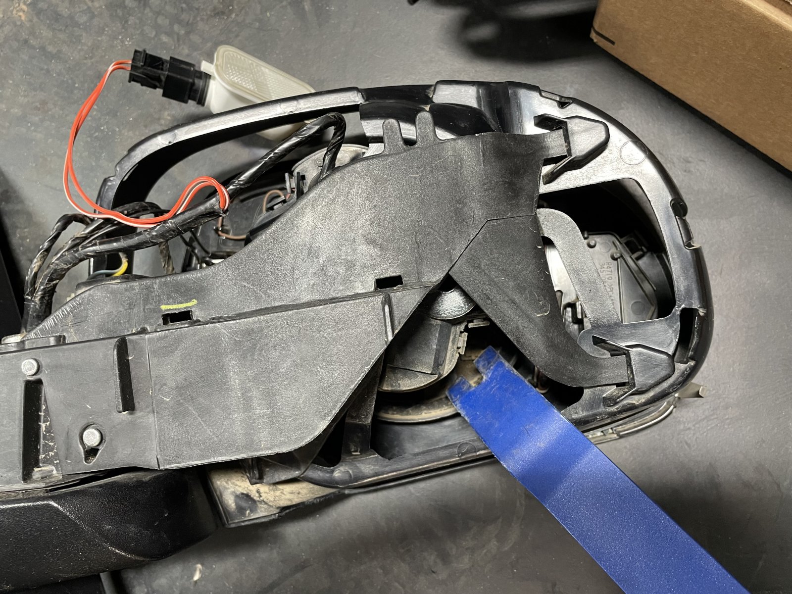

The glass plus mount pops out really easily with the cover off, or the puddle lamp out, you can reach right behind and push on the bucket mount.
I did not try prying from the outside edge much. One had damage near the edge which helped in prying the cover apart.

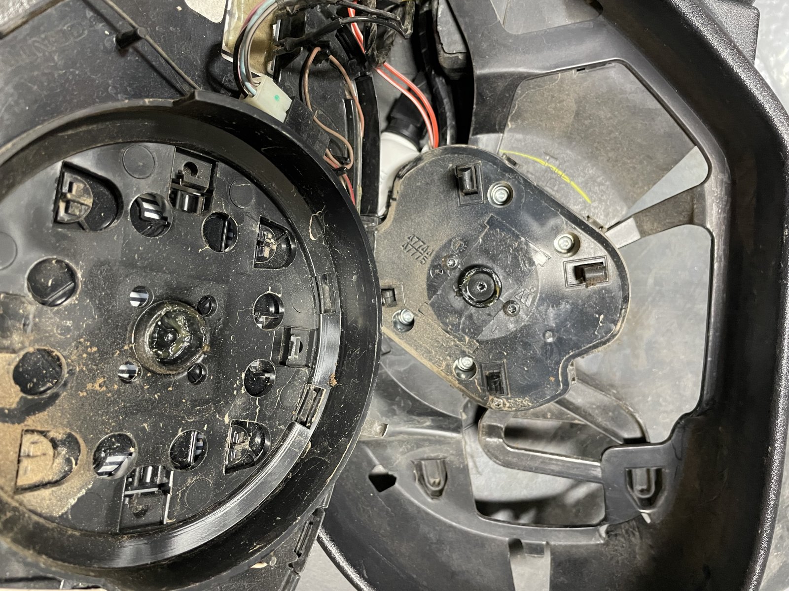

Will probably remove the other cover soon to replace with a matte black one. Here are some pics..
looks like 4 torx screws holding motor on.

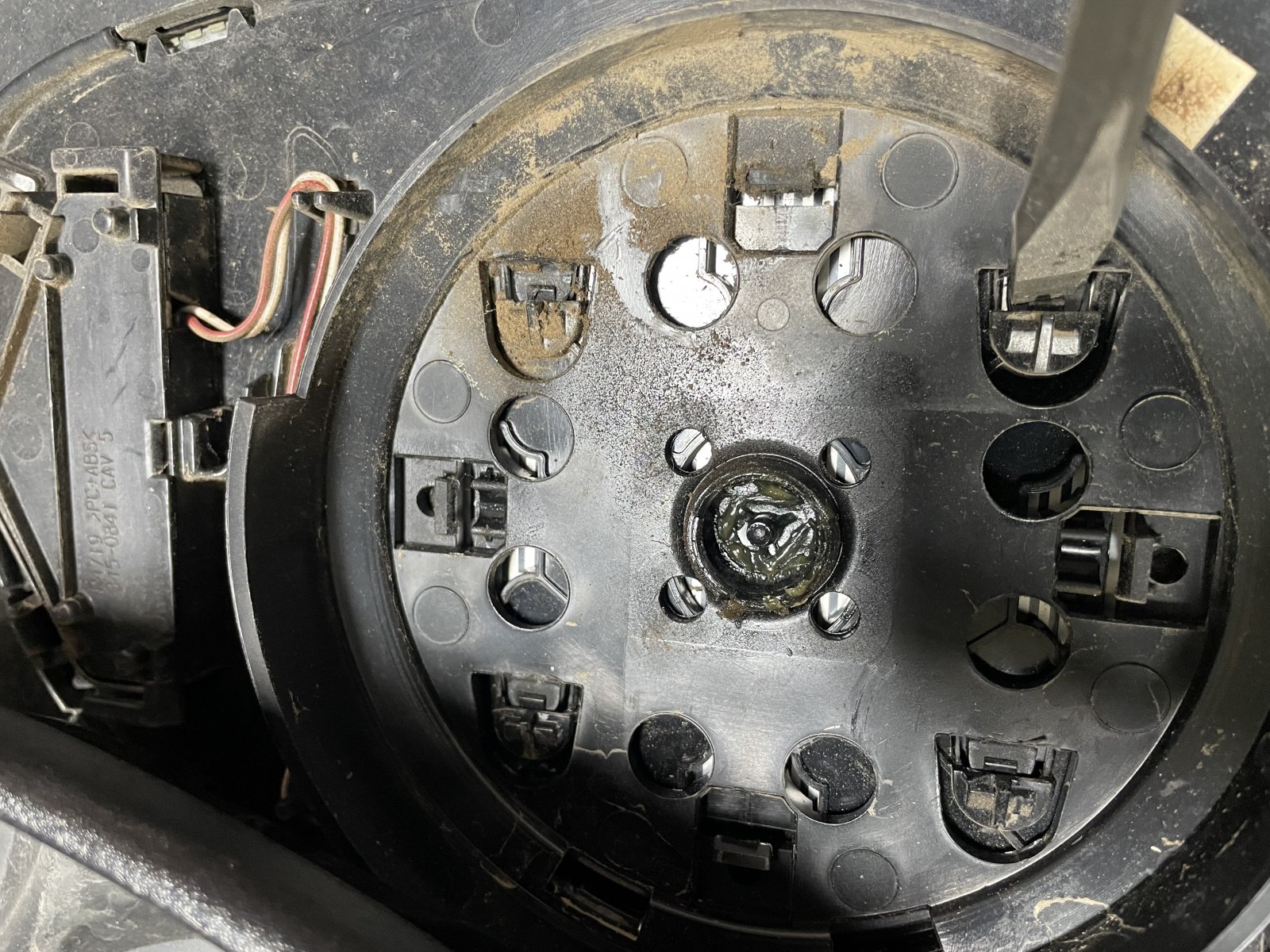

pry here against 4 tabs (1 at a time!) to separate the glass from the bucket mount.
