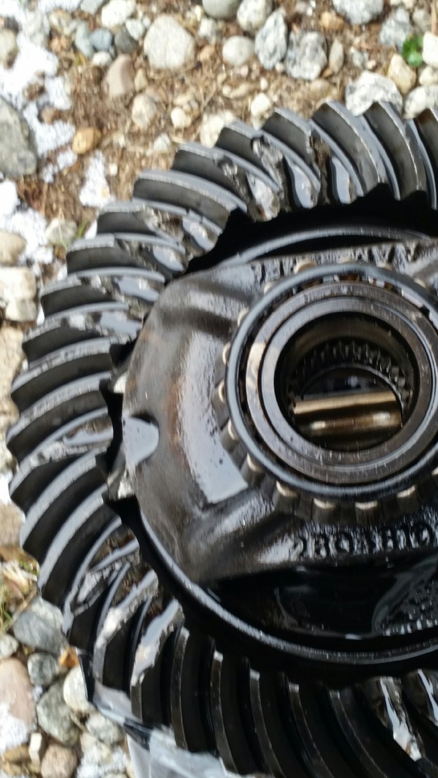

So....long story short, ended up being the front diff. Have a rebuild ordered. When I drained the diff, had a bunch of shrapnel come out with it. End of the drain plug looked like a piece of broccoli. Also lots of pieces inside when I peeked in. This thing should be like new by the time I am done with it.
L
lcguy1
Nov 26, 2017
11
So, after all was said and done, I replaced the front diff and took a look at the old. Here is what I found, and lots of large gear chunks rattling around inside the case. Runs like a champ now. Changed the oil, plugs, wires, and rear brakes while I was at it.
