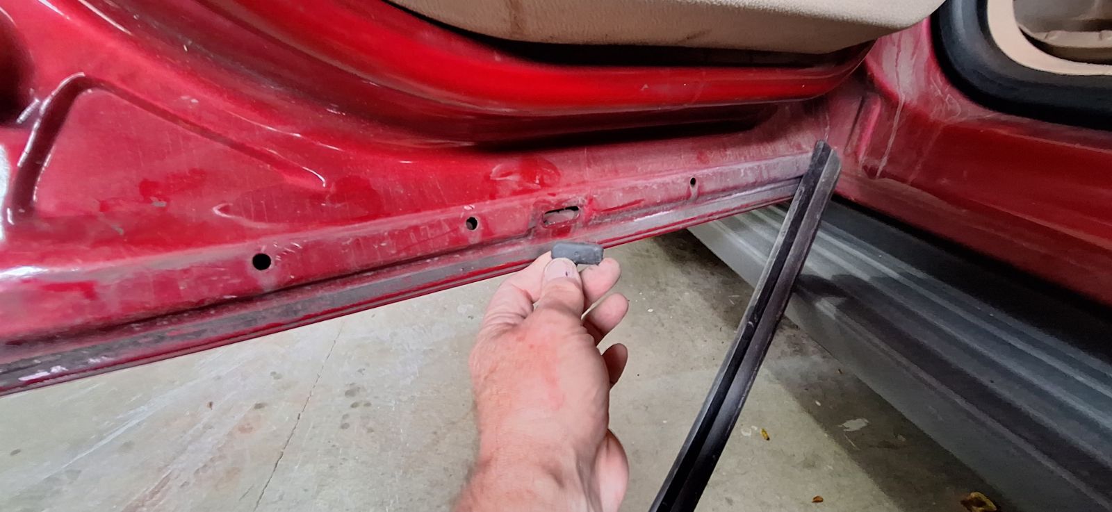

an alternative to drilling holes, remove the little oval plastic plug, middle bottom of door, under the weatherstrip.

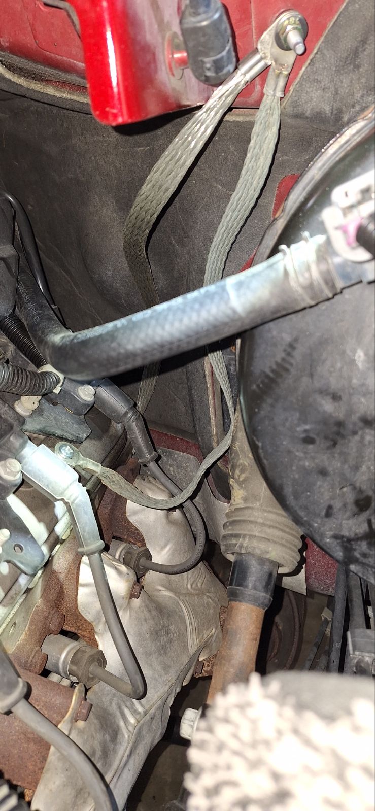

I did not check this one but I cleaned both ends of the battery negative to engine block cable, the battery end of the positive to under hood fuse/relay panel, and both ends of the engine block to body flexible ground strap on driver's side under hood. It's been 5 trips with no issues. The battery negative registers about 130-140 mV drop during engine cranking, which seemed close to the 200mV limit, so I aimed to replace that cable but have not found suitable replacement, and there is a 6 or 8 gage wire I think connected to it at the battery end that runs up somewhere into the passenger side front bumper as far as I can tell... Not sure what it is (blower motor ground???) so just going with the contact cleaning for now.... The ground strap I cleaned, but also ordered replacement for. If issue comes back I will check this next, or next time I get under car, whichever comes first. Thanks for all the advice!!!

i added the new ground strap wire and ran the old one to a 2ndary location on block that was available (If 1 is good 2 must be better!). I removed the oval plug in the driver side rear door to help the door drain per @mikez71 . Hopefully these issues are behind me now. Thanks for all the advice!
